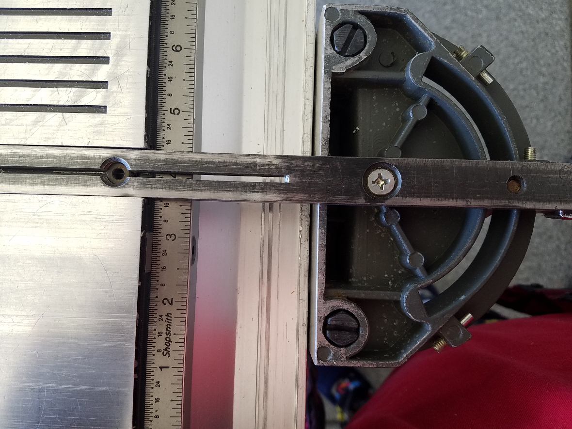

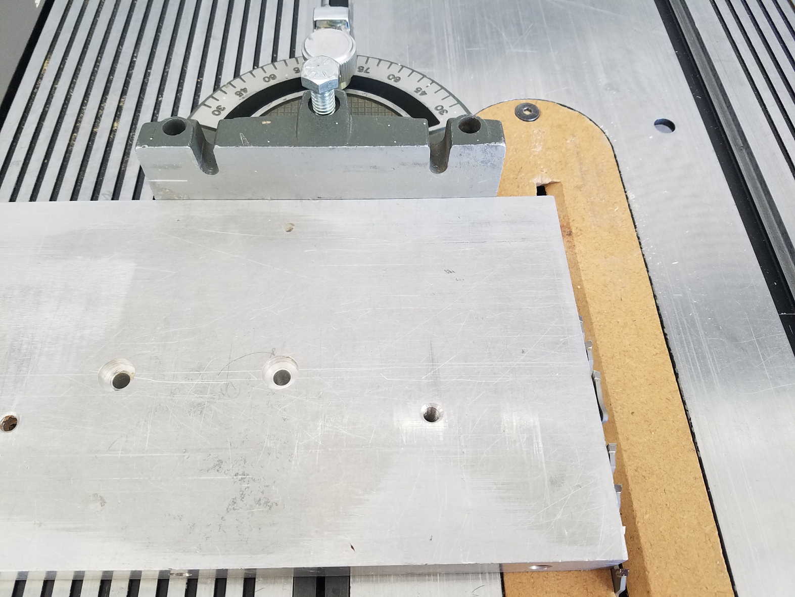

Just got back to my garage and noticed what I think may be causing the issues with my SS miter gauge. Image
Here’s the exploded diagram from my 510 manual of the miter gauge - mine definitely looks different from what this is saying
part 282: nylock machine screw...mine definitely is not a nykock one. It’s just a regular screw apparently. Image
Part 277 - special washer...there should be two, one on top of the miter gauge bar for the nykock machine screw and the miter stud. I have two different sized washers here...
And finally, part 268 - washer....there should be two, both under the lock knob. It appears I only have one. Image
I swapped the two thinner washers up to be under the lock knob and I added a 1/4” washer to the miter stud that is similar in thickness to the one on the big “nylock machine screw”
Speaking of that machine screw that’s is the pivot of the gauge - it always seems to back itself out of tighten itself depending on which direction you turn the face. I added some graphite under the gauge to help it slide when changing angles.
Sent from my iPhone using Tapatalk

Well I think that fixed it enough to be accurate enough for government work! Turns out the miter gauge was setup incorrectly. Sometimes it just helps to take shit apart and look at the diagram and see where things are different from factory spec I suppose.
