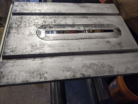

I was able to get the buildup on the surface removed and some of the black stuff underneath using a soft wire brush then some 220 sandpaper. There is some pitting, but it is not too bad.
Here's what I've got left...black "stuff" that appears to be in the machining grooves. Nothing I've done is getting that off. I'd love to have a nice shiny "new" looking table but I'm not sure what to try next.
As you can see in the pic, I've got penetrating oil on the screws. Fingers crossed.
Fortunatley, the underside of the table looks terrific.

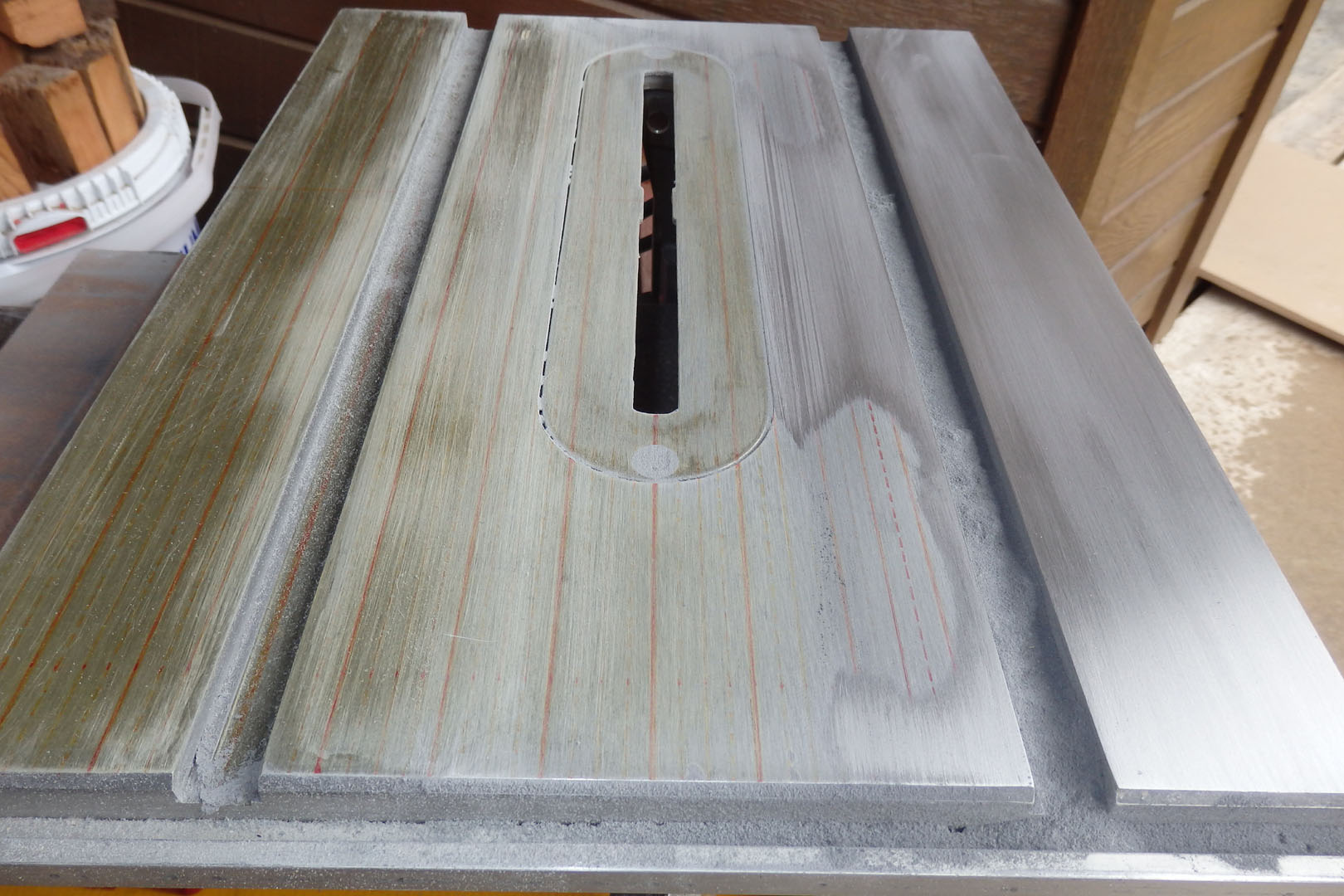

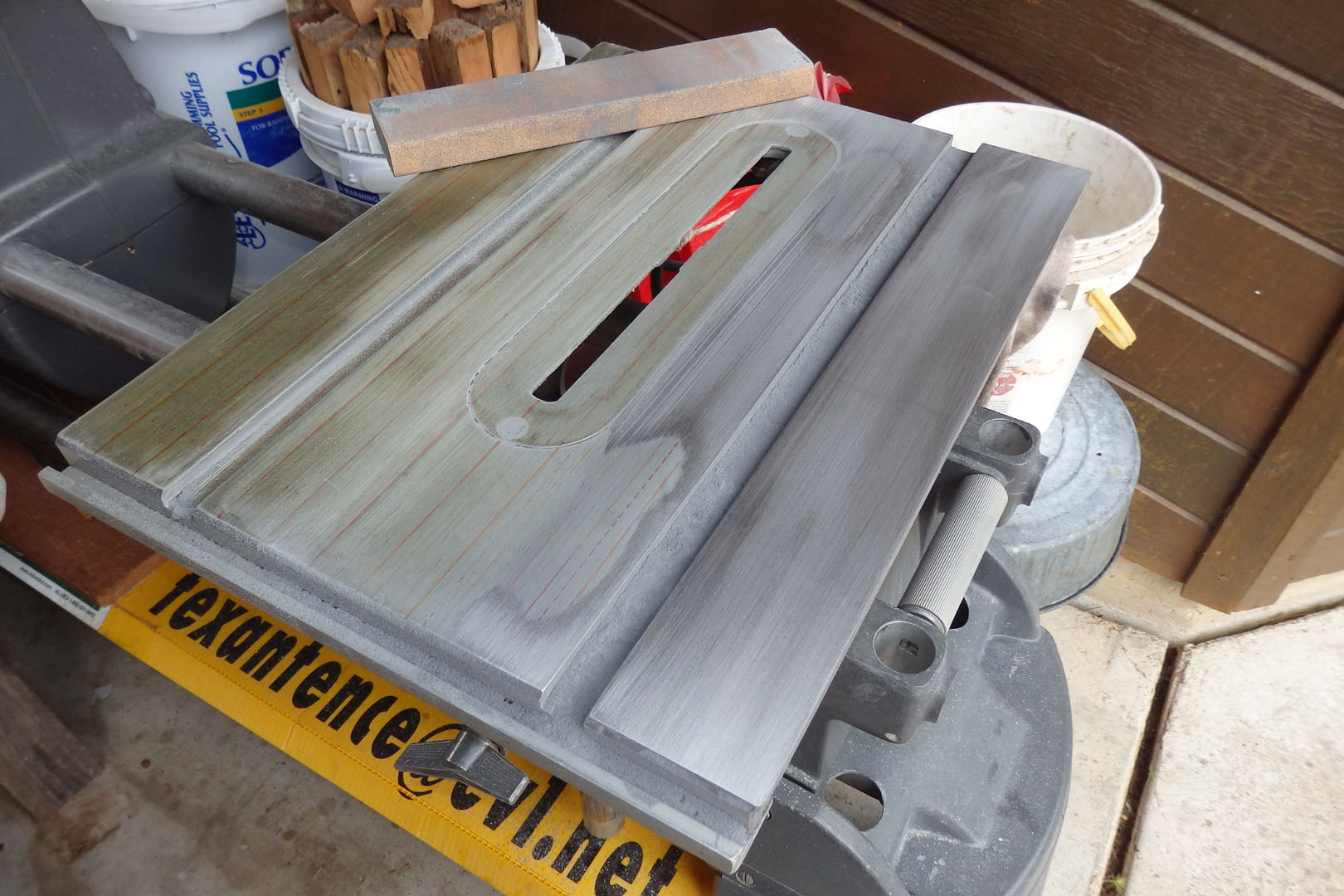

Big improvement! I sanded mine, and I think I started with 100 or 120 grit wrapped around a fairly long block of wood. The fact that my table wasn't perfectly flat became immediately obvious. In my case, I was removing varnish that I had applied, trying to keep some red sharpie guide lines from getting rubbed off. The varnish had gotten dull from wood sliding across it, and then it turned amber, as it tends to do. Go easy in the miter gauge slots ... I suggest brass wool or ScotchBrite only so as to not widen the slots.

Wow!!! That gives me some hope!
Ok - I'll be more agressive with the sandpaper. I've just been worried about taking off too much and ruining the flat surface.
- Posts: 4521
Re: New owner, want to restore
Do use caution as you have been. Removing to much surface metal will present another problem. The Table Inserts are a fixed so there is no adjustment. Removing to much surface could leave Inserts sitting above the Table surface. Removing a lot of metal to make it look "new" again could weaken the Table structure.

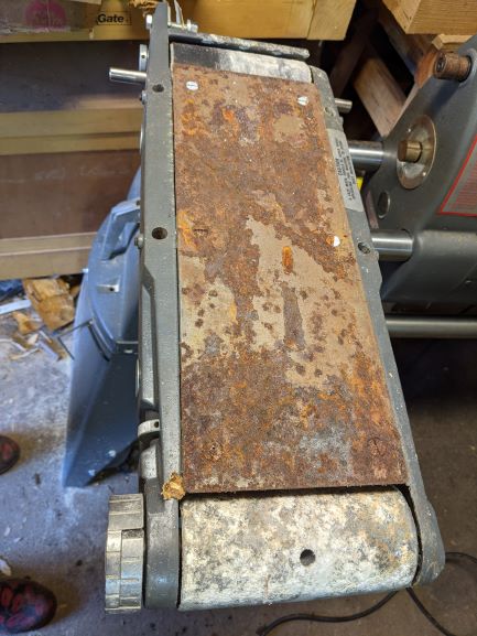

Well, this is not what I wanted to see when i pulled it out of the box. Can this plate be saved?
- plate.jpg (56.81 KiB) Viewed 4866 times
- Posts: 4521
Yes, it looks like the back-up plate can be saved. As long as it is "structurally" sound without deep below surface rust areas and ends up mostly smooth. It looks more like surface rust than deep pitting rust. Use rust remover and clean it up. After it is cleaned up apply paste wax for protection just like other bare metal parts. If you decide to go for a new one it is part number 5029639 and is $29.68 plus shipping.
There was a label that went on the back side of the plate in the past. I don't know if it is still put on newer Belt Sanders. If yours had it and you want to replace it, the attached PDF is a reproduction of that label. Print it on full sheet (8-1/2" x 11") label paper in landscape position.
By the way do not use chemicals to clean the Idler Drum (upper drum). Use a wire brush or light sanding.
