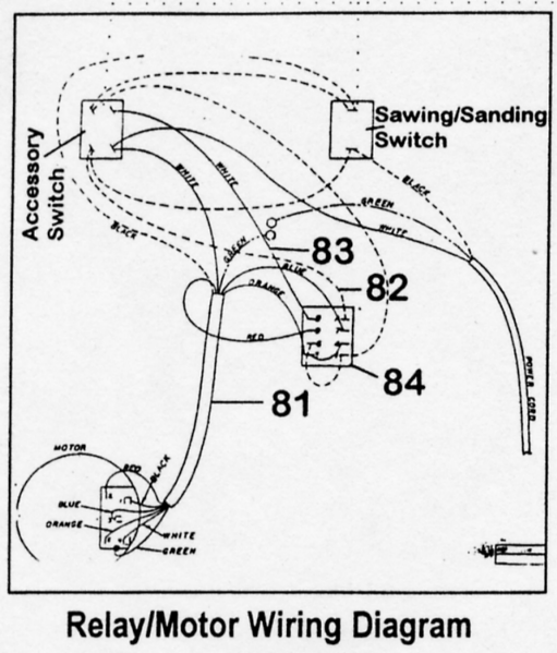

Speaking of which, since the CS has TWO power switches, does it need the extra pole? I assume only one of the switches = Mk5 switch. What is the other?dusty wrote: If you have a Power Station, it uses the same switch as does the Crafter's Station.
The Crafter's Station does use two switches. One is identical to the switch used in the Mark V while the other is a spst. The switching in the Crafter's Station is not exactly straight forward. Realize that the Crafter's Station motor runs in either direction. This bidirectional capability employs a 4 pole single throw relay as well.jpg40504 wrote:Speaking of which, since the CS has TWO power switches, does it need the extra pole? I assume only one of the switches = Mk5 switch. What is the other?
When using the CS as a saw, the infeed side of the table is the backside.
Knew about bi-directionality and why. Wondered if they used a relay to reverse motor direction. Makes switch needs simpler. I am guessing the spdt switch is 'hot' and the dpst switch is feed thru the spdt. Which one is which?dusty wrote:The Crafter's Station does use two switches. One is identical to the switch used in the Mark V while the other is a spst. The switching in the Crafter's Station is not exactly straight forward. Realize that the Crafter's Station motor runs in either direction. This bidirectional capability employs a 4 pole single throw relay as well.
SPDT on PS side and DPST on 'saw' side??? The EE in me is curious.
Here is the wiring diagram from the manual.jpg40504 wrote:Knew about bi-directionality and why. Wondered if they used a relay to reverse motor direction. Makes switch needs simpler. I am guessing the spdt switch is 'hot' and the dpst switch is feed thru the spdt. Which one is which?
[ATTACH]3108[/ATTACH]
I redrew this into a format that I was more familiar with and did a relay energized and relay deenergized version. It was easier for me to work with.
- Crafter's Station Wiring Diagram.gif (168.57 KiB) Viewed 13439 times
motor wiring for crafters station
I can see why!dusty wrote:Here is the wiring diagram from the manual.
Both switches turn on the motor (black wire).
The DPST switch ALSO switches the neutral(white) to the relay coil. The other side of the relay coil is hot all the time!
The DPDT relay reverses the red and blue connections to the black and orange wire respectively.
Thank You!:)
