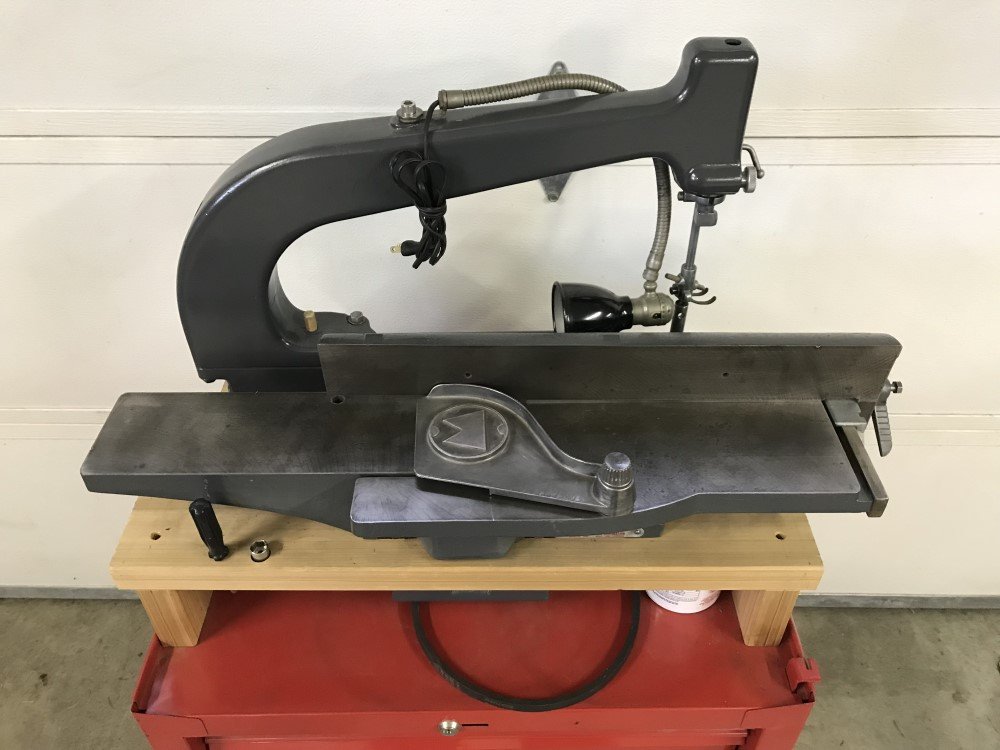

You already have a guide for the distance between the holes needed to attach the Hinge Plate to the Jointer. It is the Hinge Plate itself. The Hinge Plate would have to be centered to either side of the Cutter Head protrusion on the Jointer Base/Outfeed Table casting. Even if you are a fraction of an inch off having it centered it really would not matter. I would have to check the distance of the hole center line above the bottom edge of the Jointer Base/Outfeed Table casting. From the picture you can see the holes are not that far above the bottom edge and probably no more than the diameter of the hole. I'll try to remember to check that when I go into the shop today.
Drilling your own mounting holes in the Jointer Base/Outfeed Table casting would allow you to use any Magna/Shopsmith Jointer made from the change to the Model 620-C to a current one. The only thing the Jointer cannot have is the Dust Collection Chute found on newer models and upgraded Jointers.

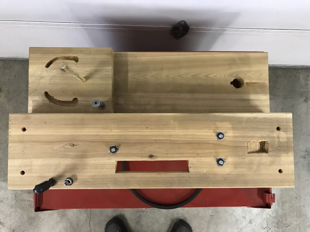

Now a word of caution: The ears on the Hinge Plate where it attaches to the Jointer can be broken off if not carefully handled. I do not recommend setting down the Jointer with the Hinge Plate attached to it and resting on the Hinge Plate. Although the Hinge Plate is a fairly strong casting the Jointer is heavy and accidently dropping it could damage it. I do not have my restored Model 4E Jointer attached to my Model 10ER all of the time but instead keep it on a stand I made for it. The Hinge Plate is attached and goes through a slot in the stand which you can see in the 1st picture below.
_
Jointer and Jig Saw stands.jpg (113 KiB) Viewed 8298 times
Below is my Model 4E Jointer and Model A-34 Jig Saw on the stands
_
Jointer and Jig Saw on stands.jpg (95.82 KiB) Viewed 8298 times

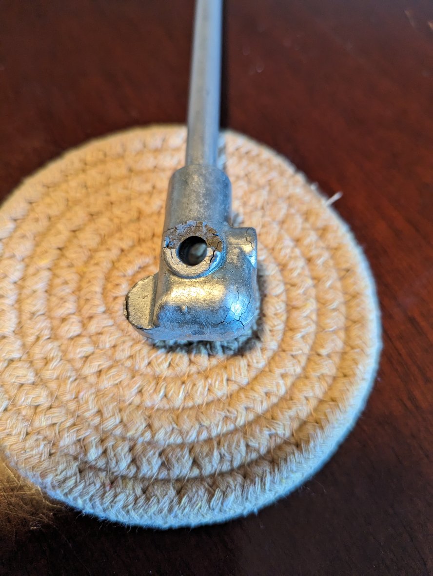

The last part to restore is the jigsaw, so far it looks like it’s in pretty good shape except for the casting at the end of the hold down guide, it is full of fractures and just disintegrating, is this a common problem and is there a source to get a replacement?

I have a Jig Saw Hold Down Support Assembly that looks very similar and "crumbling" like yours. Jig Saw parts have to be found used. They are out there from time to time, so you need to have patience.

That's disappointing news that there is no replacement for the jigsaw hold down, guess that’s the game when dealing with antique machinery, thinking about trying some penetrating epoxy to stabilize the part for now till a replacement comes my way, it would probably work better if I had a vacuum chamber.
