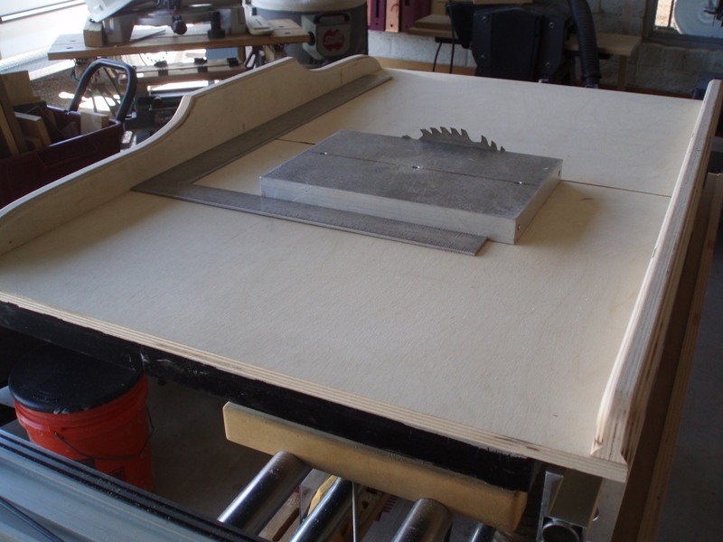

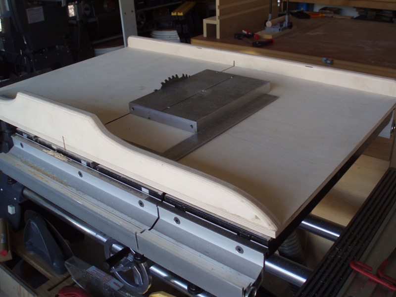

I hate to be the bearer of bad news but nothing went wrong. This is the nature of the beast. There are too many variables involved for this type of cut off sled.
I have two (home made) and both have a kerf line that is considerably wider than the blade with which they were cut.
Carriage location, headstock location, table tilt, quill position, arbor not fully inserted (every time), arbors not all exactly the same, wide kerf blades and failure to lock everything in the proper position...all of these can contribute to what you describe.
However, I still use my cross cut sleds. The primary function of the sled is not lost. The only feature permanently lost is the use of the kerf cut for stock placement.
[ATTACH]12899[/ATTACH]
[ATTACH]12900[/ATTACH]
