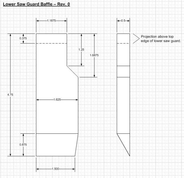

I set the width of the lower saw guard so that is clears by about 1/8", the piece on the right side that it will hit (when lowering the table) if it is set too narrow. (Does that make sense? Maybe a picture would help). Then I made the width of the baffle to fit that opening.
After reading some of the other posts, I now realize that I will have to remove the baffle if I want to do any sawing with the table tilted - bummer. Maybe I can fix that with a Rev. 2.
Bill

Bill, I would like to see your dimensioned drawing. Thanks
Peter

Post by mountainbreeze »
Here you go...
[ATTACH]16081[/ATTACH]
Bill
Mark V 520 50th Anniversary Edition, Planer, Jointer, Bandsaw
In post #27, this thread, I provided a dimensioned drawing of my deflector. I have since made that deflector from a piece of metal flashing and attached it to the lower saw guard using pop rivets.
It works as well as the images I posted earlier in this thread and no longer comes off due to poor adhesion.
