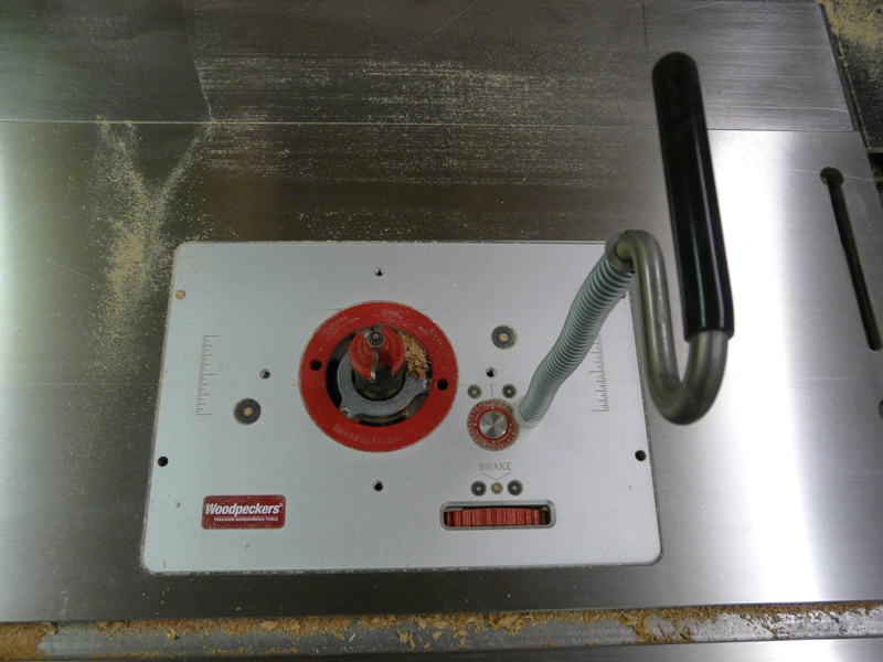

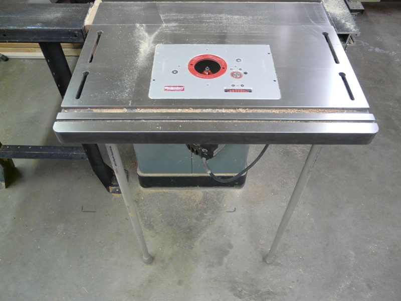

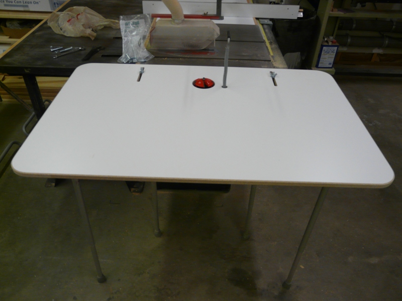

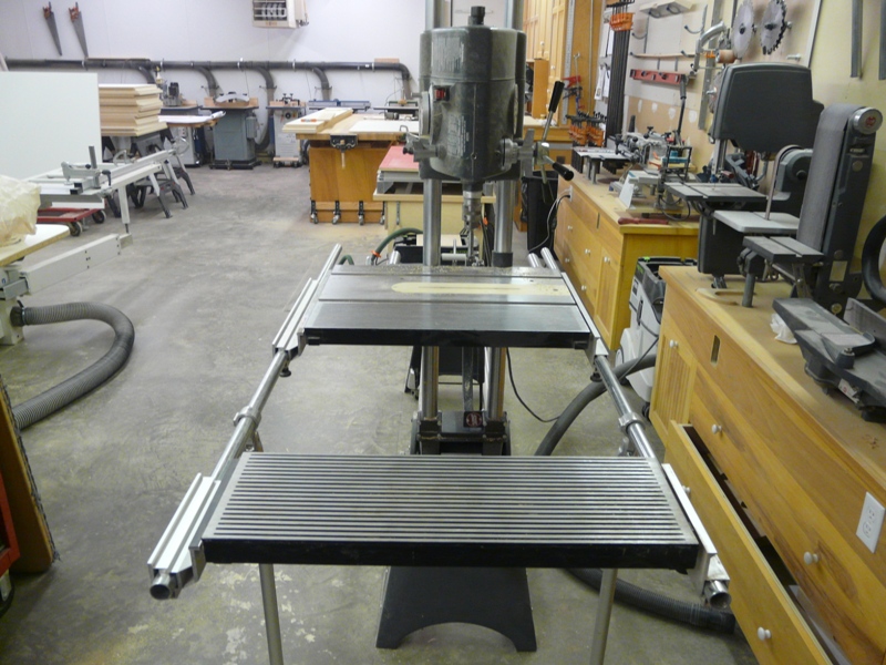

Some of you may remember that I had an Excalibur sliding table on this end of the Unisaw before I purchased the Mini Max. I decided it would be good to add another router table and lift to the shop by replacing the slider with this Bench dog cast iron router table with a Woodpecker lift and Porter Cable 3 1/4 hp router. It is an excellent set up but for some things I need a larger table.
Anyone recognize the support legs?
[ATTACH]15331[/ATTACH]

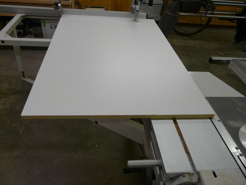

This should be big enough. 32" x 49"
[ATTACH]15329[/ATTACH]

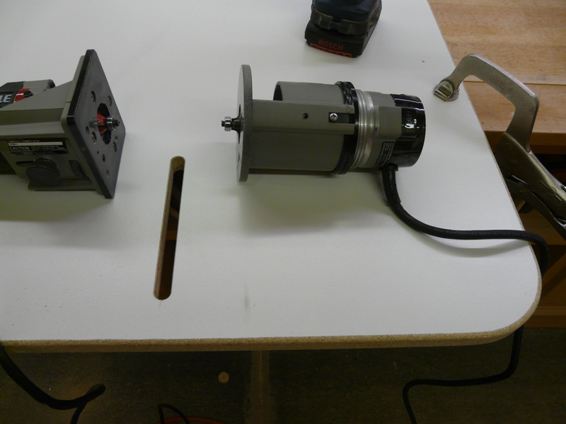

Now I have to have access to the lift mechanism so I will have to provide a hole in the appropriate location.
[ATTACH]15330[/ATTACH]

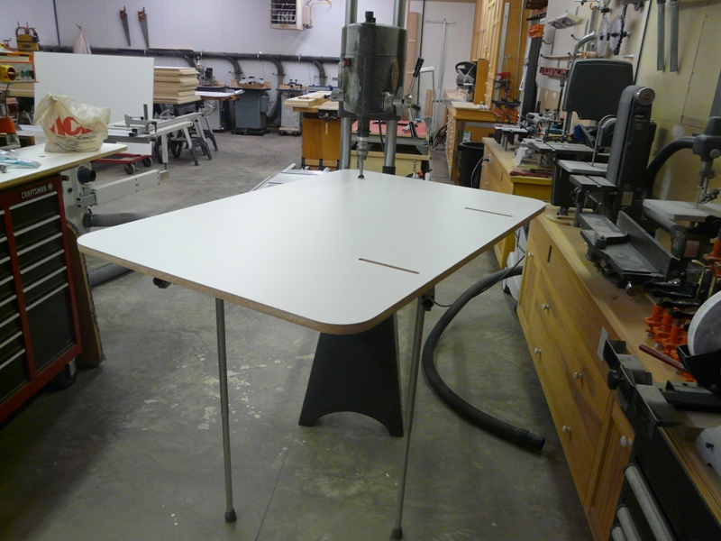

[attach]15346[/attach]
[attach]15349[/attach]

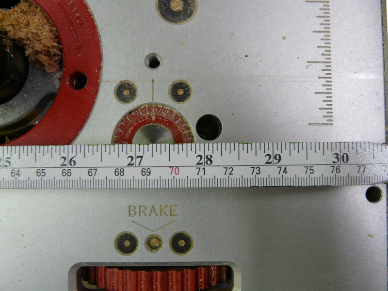

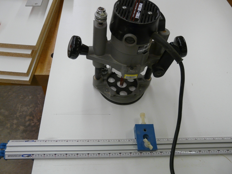

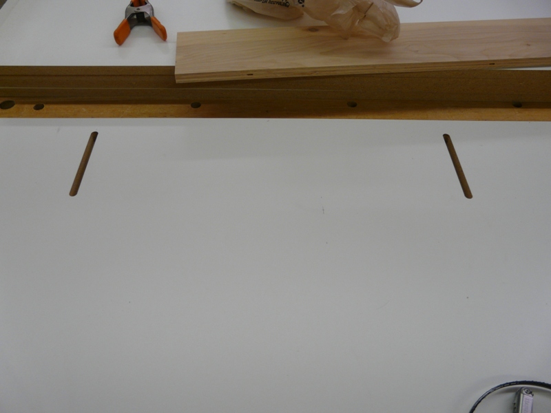

I want to be able to use the fence so I needed to route 2 slots.
[attach]15347[/attach]
[attach]15348[/attach]

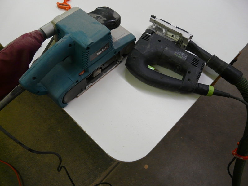

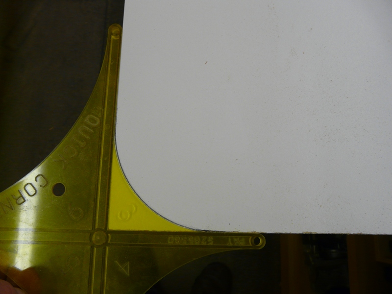

Also decided to radius the corners. I'm sure my middle body parts will thank me later.
[attach]15350[/attach]
The really nice thing about a Shopsmith.

[attach]15351[/attach]

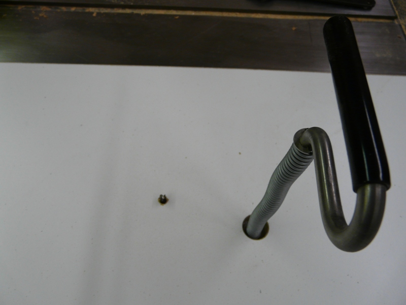

Decided to drill some shallow holes in the bottom side to hold the legs in place. I had to drill the hole for the lifting rod by hand as it was just out of reach on the 520.
[attach]15352[/attach]

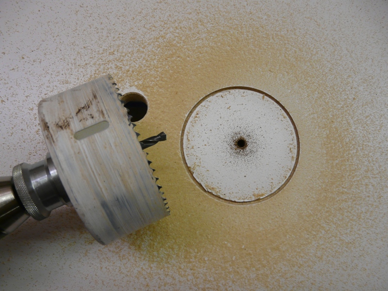

I installed a 1/4 inch bit and lowered the router bolted the top in place and used the lifting rod to pull the bit through the top. I then had a starter hole for the hole saw.
[attach]15353[/attach]
A 4 inch hole saw is hard on batteries!
[attach]15354[/attach]
I cleaned up all the edges with either a 1/4" roundover or a small chamfer.
[attach]15355[/attach]
I think this will handle a pretty large panel. Next I located and drilled two 1/2" holes for the starting pins but the picture did not come out well.

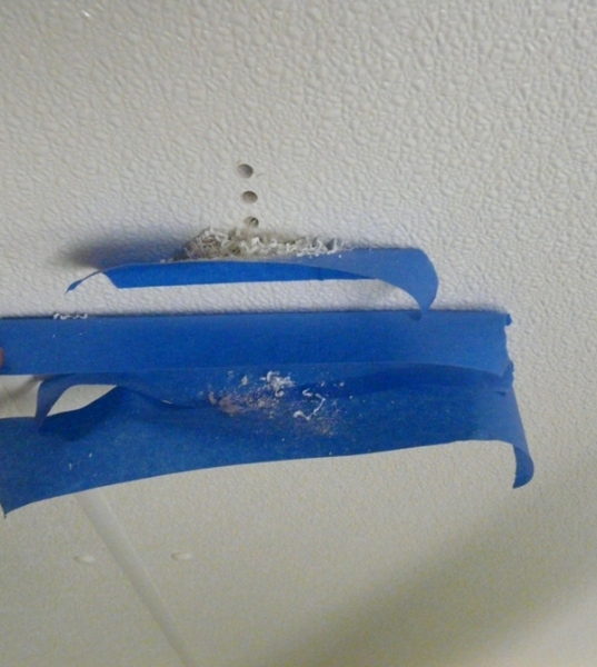

Here is a nice little trick. When drilling holes in a wall use a little painters tape to catch the crumbs.
[ATTACH]15357[/ATTACH]

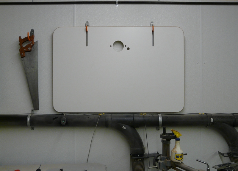

Just hanging out until needed.

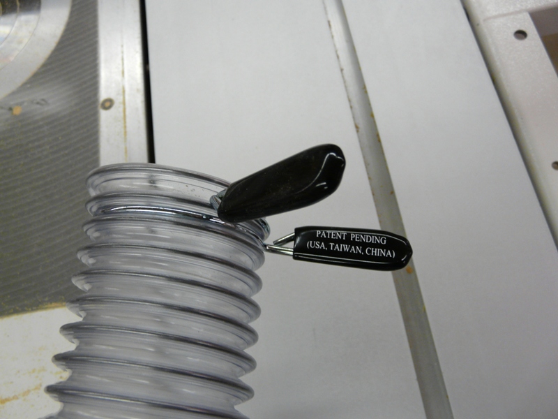

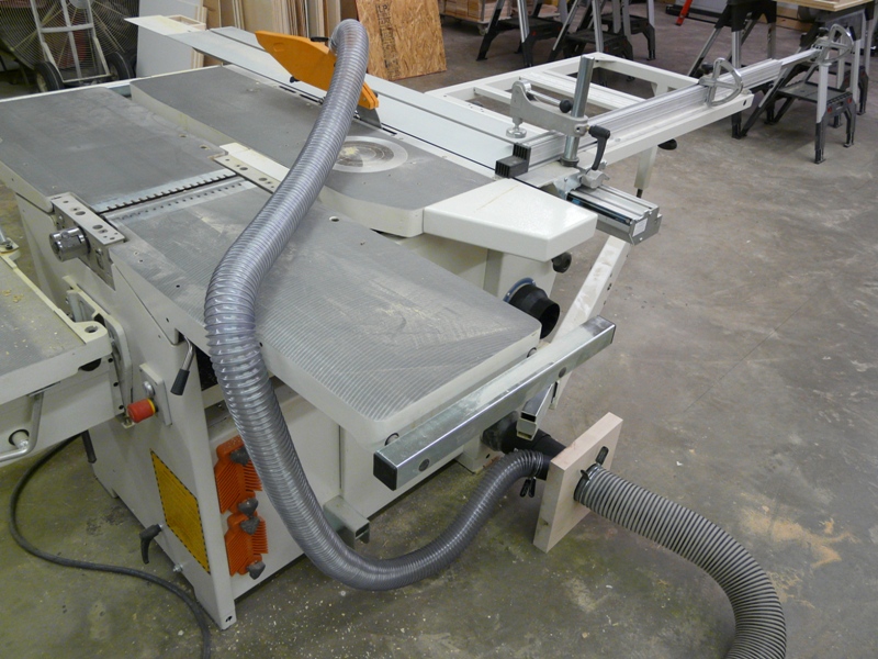

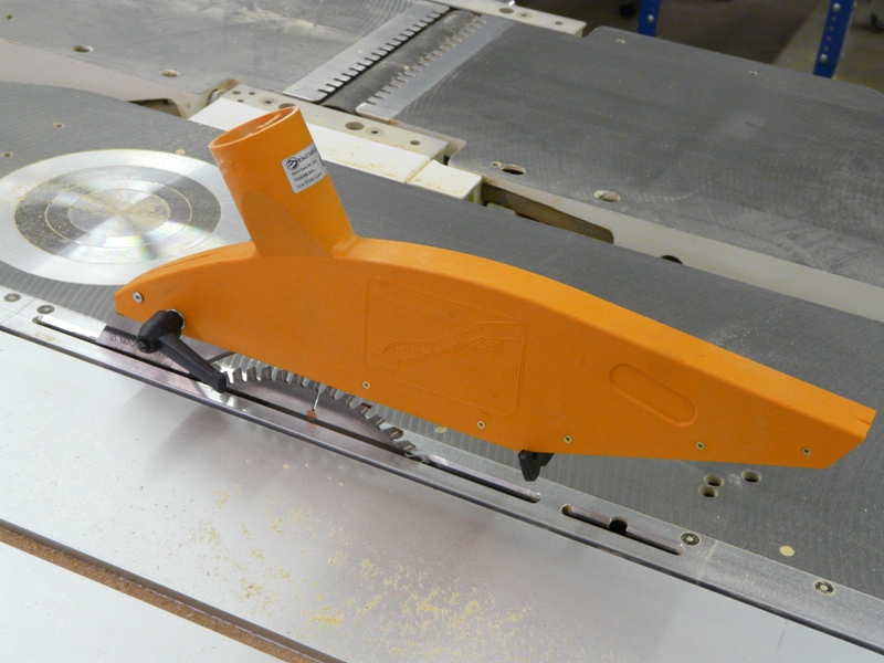

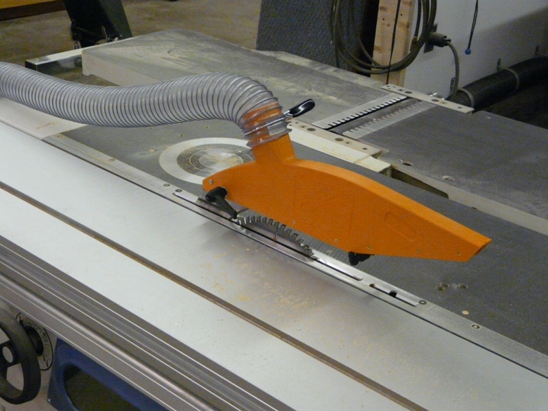

At least that is what I told the wife when she reminded me that I had not installed the guard on the Mini Max today. Actually I have been planning to purchase the needed items to hook it up to the dust collector so while I was out shopping today I picked those up.
[ATTACH]15361[/ATTACH]
[ATTACH]15362[/ATTACH]
[ATTACH]15363[/ATTACH]
I am going to rig up something to hang this from the ceiling.
[ATTACH]15364[/ATTACH]
These quick connect clamps from Woodcraft work great if you need the ability to move your vac hoses around. They have them in 4" and 2 1/2" sizes.

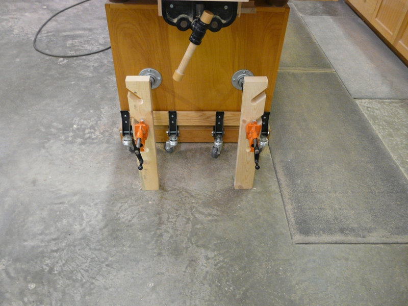

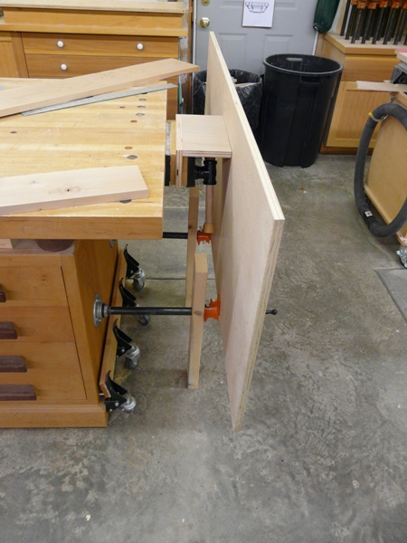

Low down bench vice
This is another shop improvement project brought on by necessity.
