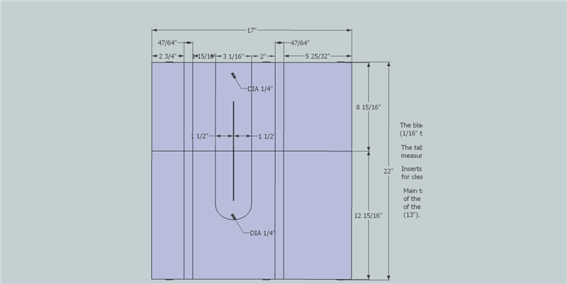

Saw Kerf with respect to Insert Centerline
This has been an interesting an frustrating adventure but the trip is now over.
The results: All anomolies were the result of Main Table Alignment. I had repositioned the table is such a manner that the blade, while parallel to miter tracks, was no longer centered in the cutout for the table insert. (The procedure does not address this.)
Furthermore, I had repositioned the table in such a way that the drill line had also been changed. (The procedure does not address this.)
The details of all of this is contained in this thread and it has all been summarized here in this sketch of the table top. I hope this is helpful to some of you.
[ATTACH]16331[/ATTACH]
I'm off to make sawdust again.
Well, later.
The notes that have been truncated should read as follows:
The blade depicted is .062" (1/16").
The Table insert cutout measures 3.035"
Inserts should be cut to 3" for clearance.
Main Table alignment must include parallelism of the miter track to the blade
as well as position of the table with respect to center line of the arbor (13").
Anatomy of the Shopsmith Table Top (Custom).png (42.54 KiB) Viewed 667 times
