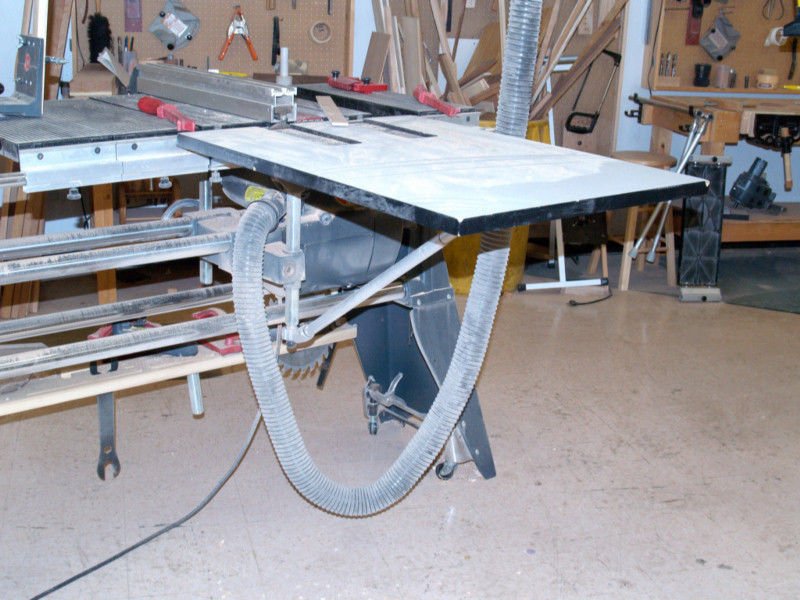

Wow, Thank you so very much! I am in the process of building a wood working shop and I was thinking that with the 2 SS’s I have, I could use the dual tilt to do just as you mentioned and use the under table shaping if I get that advanced. It would get me a little closer to a Mark 7. The sale price seemed reasonable for the future ability. I had no idea that an increased would allow me to do the under table functions. I had thought about a speed reducer for lathe turning, but have never really looked at the increaser. I may just save my $, and look into the increaser. Its funny, my older unit has been upgraded to the 520 table/fence system and I thought it was the newer unit..Heck, maybe my best upgrade would be to just take my second one up to the 520 fence/table system..
Now if I can figure out how to build an outfeed table that will move up and down when I’m in the Table saw mode, I’ll really be cooking with gas.. I’ve even started considering a stand alone table saw. But I love the craftsmanship of the SS. I even found a saw smith 2000 for sale but I’m not sure about that sliding blade..
Posts: 4526
Re: Serial number lookup
With the 520 Table and Pro Fence system you have a couple of options for outfeed tables that can move with the setup. The first is shown below and is a modified version of the outfeed table Shopsmith used to sell. The leg has been changed to attach to the bottom of the Table tube. This setup moves not only up and down with the table height but also tilts with the table.

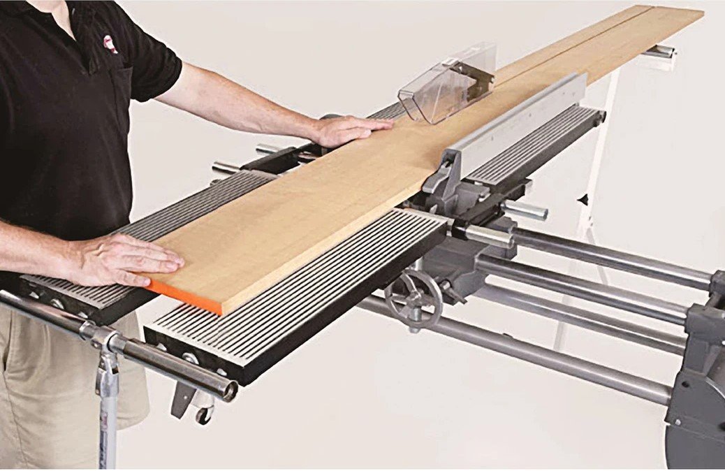

The Mark V 520 (and the 510) can use the Floating Tables for both infeed and outfeed extensions. Shopsmith sells brackets for direct alignment or you can use them offset without the brackets. The picture below shows the Brackets part number 555997 in use as an infeed table. These two methods do require adjusting the support leg's height with the table height. The more Floating Tables you have the more infeed/outfeed options you have.
_
555997 Table Extension Bracket Set - infeed.jpg (113.39 KiB) Viewed 58752 times

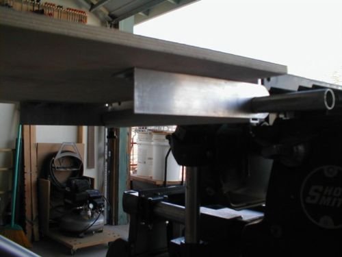

The table attached to the table tube is exactly what I’m looking for!! How does that mount to the rear rail? Does it just sit on the rail? Does anyone have “plans” for this? If not, at least details?

Posts: 4526
lldeman,
The first outfeed Table Extension in my previous post is based off the one Shopsmith sold. In the case of the one in the picture the person made their own brackets to attach it to the 520 Fence Rails. The same can be done for the 510 Fence tubes but the bracket would not be interchangeable between the 520 and 510. Aluminum angle brackets were made along with the tabletop having groves for the Miter to pass into. I believe this one is using a Shopsmith adjustable leg and swivel end attached to a rod that goes up into the end of the Table Post. A rod of the correct length can be used instead of a Shopsmith Adjustable Leg since it is a fixed length. An additional swivel, wall type, end is needed to attach to the bottom of the table.
Below you can see the leg arrangement and how a connector tube holds the bracket to the Fence Rail.
_

Below is a closer view of the bracket.
_
outfeed table 3.jpg (21.95 KiB) Viewed 58690 times
