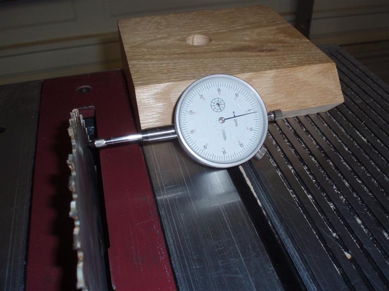

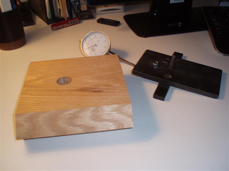

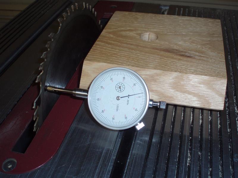

Main Table Alignment Verification, Using a Dial Indicator.
I am short and being short often introduces situations that can become frustrating. Doing table alignment to the blade has been one of those situations. I could not always see the dial gauge to read the indications accurately.
I solved that problem this morning. The neighbors may be mad because I was out there pretty early but they have been mad before.
I used a piece of wood from the cut off pile and I repurposed some parts from the Tenon Master (which I hardly ever use).
Problem Solved.:)
[ATTACH]23401[/ATTACH]
[ATTACH]23402[/ATTACH]
[ATTACH]23403[/ATTACH]
I positioned the dial indicator contrary to what I thought I had planned. I wanted the indicator to point straight up (12 o'clock) when touching the blade. I made some pains taking measurements to make that happen and I still missed the mark by thousandths. BUT - I can read the dial when it is pushed to the back of the blade. Before, I had to walk around to the other side to make that observation.
By the way, Ed, there was no tweaking done to get these images. That is how my table sets after being reconfigured several times for this little project (table tilted, jointer employed, drill press used, etc). Just barely within my .005" self imposed criteria.
The weight of the parts from the Tenon Master along with the bulk of the block of wood provides some stability to the fixture that I did not have with the previous set up. A miter bar that fits just a little bit more snugly in the miter track would also help tighten the specs.

Good solution to an annoying problem; but I thought you had sworn off using a dial indicator for checking alignment.:confused:
I just reread an older thread about this same topic. My self imposed criteria may not really be self imposed. I have undoubtedly been subliminally influenced by Nick.
Sure do miss that guy. I have not had contact with him in many moons. I hope all is well.
[quote="algale"]Good solution to an annoying problem]
I sorta did but my alternate methodology has not proven to be reliable. I need a plate to mount to my arbor (ie, Master Plate) that is both stiffer and more precise than a saw blade or sanding disc.

dusty wrote:A miter bar that fits just a little bit more snugly in the miter track would also help tighten the specs.
How about laying a piece of paper over the slot, then lay the miter bar on top of the paper. That should take up the slop.
beeg wrote:How about laying a piece of paper over the slot, then lay the miter bar on top of the paper. That should take up the slop.
It does do that, beeg. The slop can be measured at about .004". A little bitof side pressure works too and with the additional weight that my new jig provides, I am hoping that I have "overcome".:)
Thanks for the feedback.
