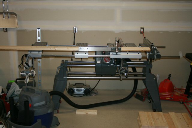

I cut the vertical supports this morning. I measured the clearance between the ceiling and the garage door as the door opens. The shelves towards the front of the garage needed 16" supports, and the ones near the back needed 19" supports. Each shelving unit has four vertical supports, so I needed 16 16" pieces and 16 19" pieces.
I laid out the cuts onto the 96" boards as follows:
piece 1 - 5 19" pieces (95" total)
piece 2 - 5 19" pieces (95" total)
piece 3 - 5 19" pieces (95" total)
piece 4 - 1 19" piece, 4 16" pieces (83" total)
piece 5 - 6 16" pieces (96" total)
piece 6 - 6 16" pieces (96" total)
I actually made the 16" pieces slightly shorter, to account for the kerf. Here is the table setup I used:

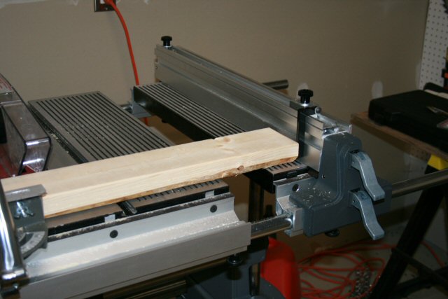

Again, I used a stop mounted to the rip fence to cut to proper length. Since my flip-up fence stop recently arrived, I used that as my stop:
[ATTACH]1530[/ATTACH]
It was nice because I could slide it up, measure the distance between the stop and the blade, then slide it back to the front and lock it down.

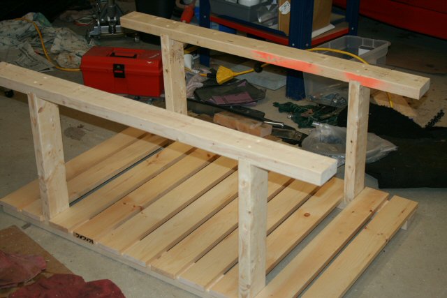

Here is a mock-up of what the shelving will look like:
[ATTACH]1531[/ATTACH]
It's looking pretty good! This is one of the units with a 19" support.

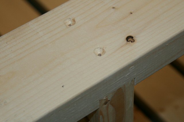

I'd like to get some advice from my fellow forum members. Here is a closeup of the dado joint with the countersunk pilot holes for the wood screws:
[ATTACH]1532[/ATTACH]
This is actually why I wanted to use the drill press to drill these pilot holes. They are precisely vertical, and exactly centered across the width to ensure the screws drive centered into the ends of the vertical supports.
Since these joints will be supporting the weight of the shelving and its contents, it's critical that they be as strong as possible. I plan to glue and screw the joints. My question is, how do I glue these up? I have some Titebond wood glue from a big box store. My plan was to spread some glue on both ends, use the screws to pull the joint tight, and wipe off the excess. Is this all that's needed?
Do I want to do anything special like let the glue set up a little bit first before pulling the joint tight?
[ATTACH]1529[/ATTACH]

Chris
I don't think your design will fail but next time try a design where the force is laterally on the side of screw inside of agains the threads. If you had made the piece that goes on the ceiling fit between the uprights then the screws would be holding with their bodies instead of only with their threads.
An even better design would have been to cut small holes in the ceiling dry wall and mounted the verticals directly the side of the ceiling joists.
Like I said with the screws, glue, dadoes, and all I don't think you will have a failure. I just would have built it so a failure could only have resulted by the screws actually shearing off.
