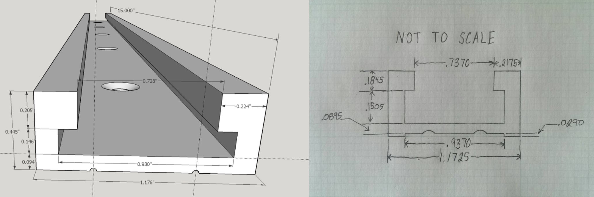

No, looks different then mine.http://www.shopsmith.com/ss_forum/viewt ... 84#p215584dusty wrote:Does this resemble the aluminum extrusion that you have?
Re: Bandsaw Fence & Miter Gauge
Interesting differences!

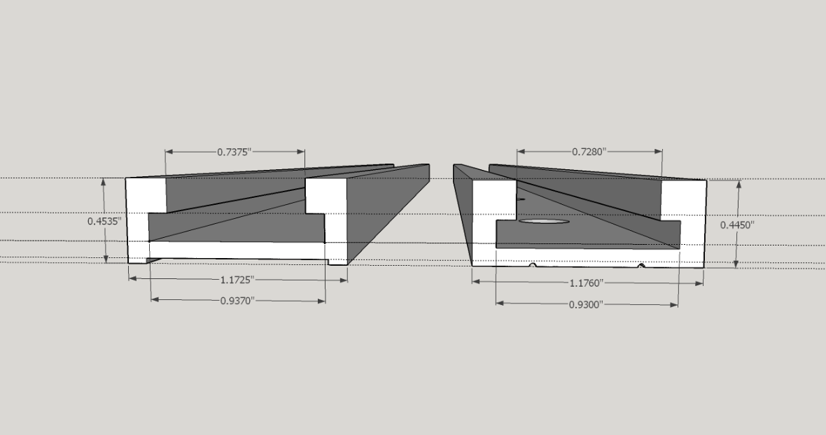

I have a hard time envisioning things so I created a sketch to compare the two aluminum extrusions. I thought that doing so would make the problem become crystal clear.
In reality, it did not. In fact, it appears to me as though your extrusion might work better in my table than does the one I have.
For the extrusion to resolve your problem, it needed to raise the floor of the miter groove. It did that. It raised the floor .0245".
I believe you have already concluded this but I suspect that the data in the table top is too deep
- Bandsaw Miter Track Comparison.png (65.96 KiB) Viewed 2059 times

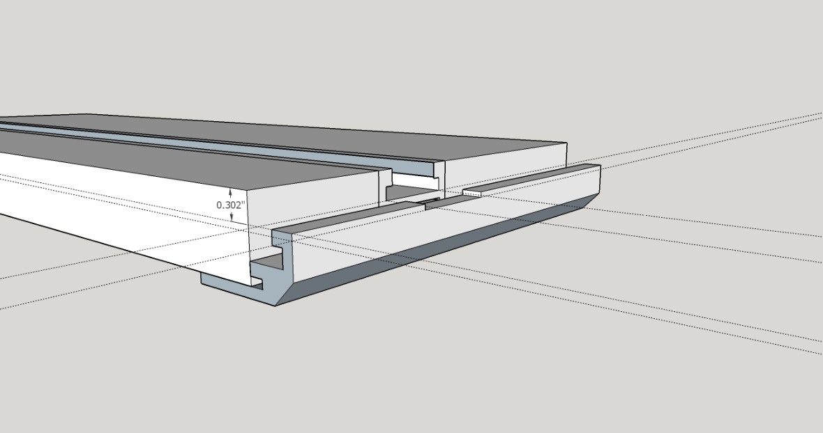

Yeah, it looks a bit different but I had a hard time envisioning the impact of those difference. To resolve that, I created a sketch using your measurements and then integrated that sketch into a sketch of my table with the aluminum edge rail (to show the point of interference) included.Skizzity wrote:No, looks different then mine.http://www.shopsmith.com/ss_forum/viewt ... 84#p215584dusty wrote:Does this resemble the aluminum extrusion that you have?
The dotted lines hopefully highlight the critical issues. There are none. Your aluminum miter track fits into the data on my table and clears the filed cutout in the aluminum extrusion.
How deep is the dado in your table top? The dado in mine is a nominal .471".
- Bandsaw Table and Track.png (101.68 KiB) Viewed 2053 times

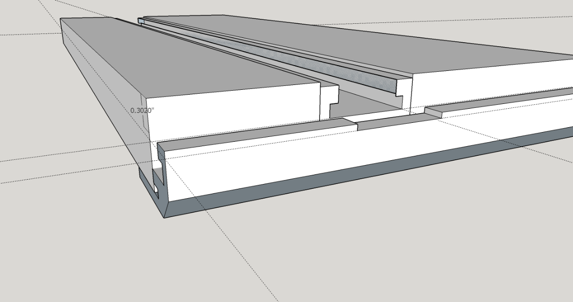

.0020 over half an inch
[*].[/quote]
.0020 over half an inch[/quote]
It would not be much but if my dado was .502" deep I would have some interference between a miter bar and and the aluminum extrusion (the notch).
Going strictly my the sketches that I generated, the interference would be .0172"
- Bandsaw Table and Track Skizzity.png (143.24 KiB) Viewed 2042 times
