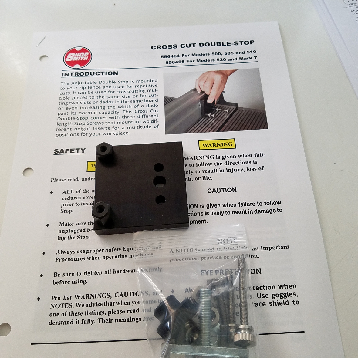

Well, received my new tool from Shopsmith today. Its official name is the "Cross Cut Double-Stop. IMO, it was a long time coming. Very well packed and protected from damage while in transport.
It was ordered early early (like 2:00am) on 9/7/2017 and it arrived here today at 2:30PM (9/22/2017). Now mind you, I am not complaining. Delivery was originally estimated by UPS to be "by the end of day 9/26/2017. I guess you could say that it arrived four days early.
It was worth the investment. I am glad I bought it even thought it was a bit expensive for the few pieces of hardware that it is. When not being used it will be stored in one of the miter tracks on the top of my 520 fence.
The holes, JPG, are not excessively sloppy. It hangs quit nicely on the side of the rip fence and is positioned just a wee bit off of the table top. The block itself measures 2 1/2" x 2 1/2 x 1/2". The two studs are nothing more than 1" split roll pins. I had to do some fine tuning to make the t-nut so that it would slide in the t-track. The roll pins were inserted a touch too far and had to be tapped back out to get clearance.
I think it should be standard equipment with the 520 rip fence.
