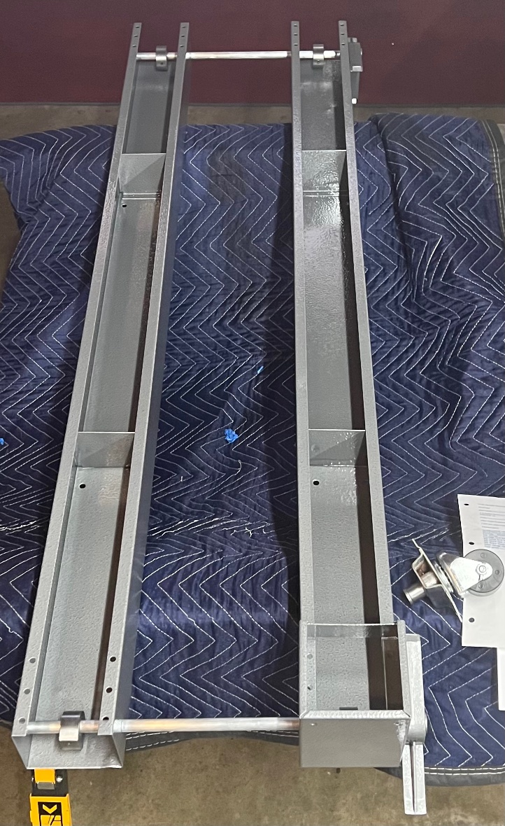

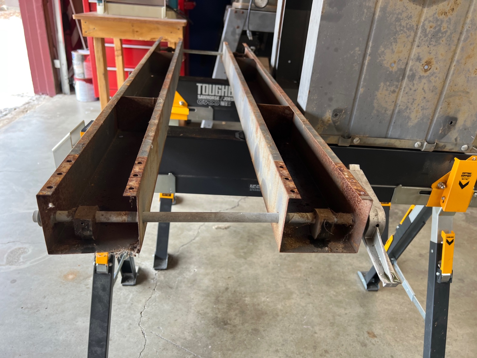

Hers a pic of some powder coated parts going together, still figuring out if the caster is going to work or if I need modifications, maybe some slime… also added the before pic
- E4F4072C-FFE2-426E-88A1-72B024EF75F6.jpeg (391.52 KiB) Viewed 1531 times
- 3D8A91F6-1A2F-4484-868A-57D85BE079FE.jpeg (471.9 KiB) Viewed 1529 times

Re: Mark VII a start and a long ways to go..
Mike, I had some issues with casters on my Mark VII. I originally didn't have any, but after a year of watching ebay I found a complete set. The problem for me was the wheels that came with the set would hit the inside area of the frame rails when it would swivel. I was able to relocate the wheel center closer to the rotation axis. If interested see here: viewtopic.php?t=27097
Before I found a set, with the levers and cams that can lift the machine, I built my own version that worked surprisingly well. You may find it interesting here: viewtopic.php?f=10&t=25392&p=283521#p283521
Thanks Mike, I went through those but I need something a little different so I’m trying a wider body caster. I used info from this forum and am trying this https://www.casterdepot.com/shepherd/c0 ... google.com
Not sure who the info came from but when I find it I will make sure they get credit.
I’m going to do some modifications that will probably increase weight by 100-200#, still working things through my pea brain, but need something a little more heavy duty. I think I’m having some of the same issues you had but need to install and try out a few things
That looks like a very good selection as it appears the "swivel rotation" is close to 3/8". Yes, please report back if they swivel without interference. I may get a set myself.Mike wrote: Sat Sep 17, 2022 11:58 pm . . .am trying this https://www.casterdepot.com/shepherd/c0 ... google.com
The 2" swivel radius is the deciding factor.
