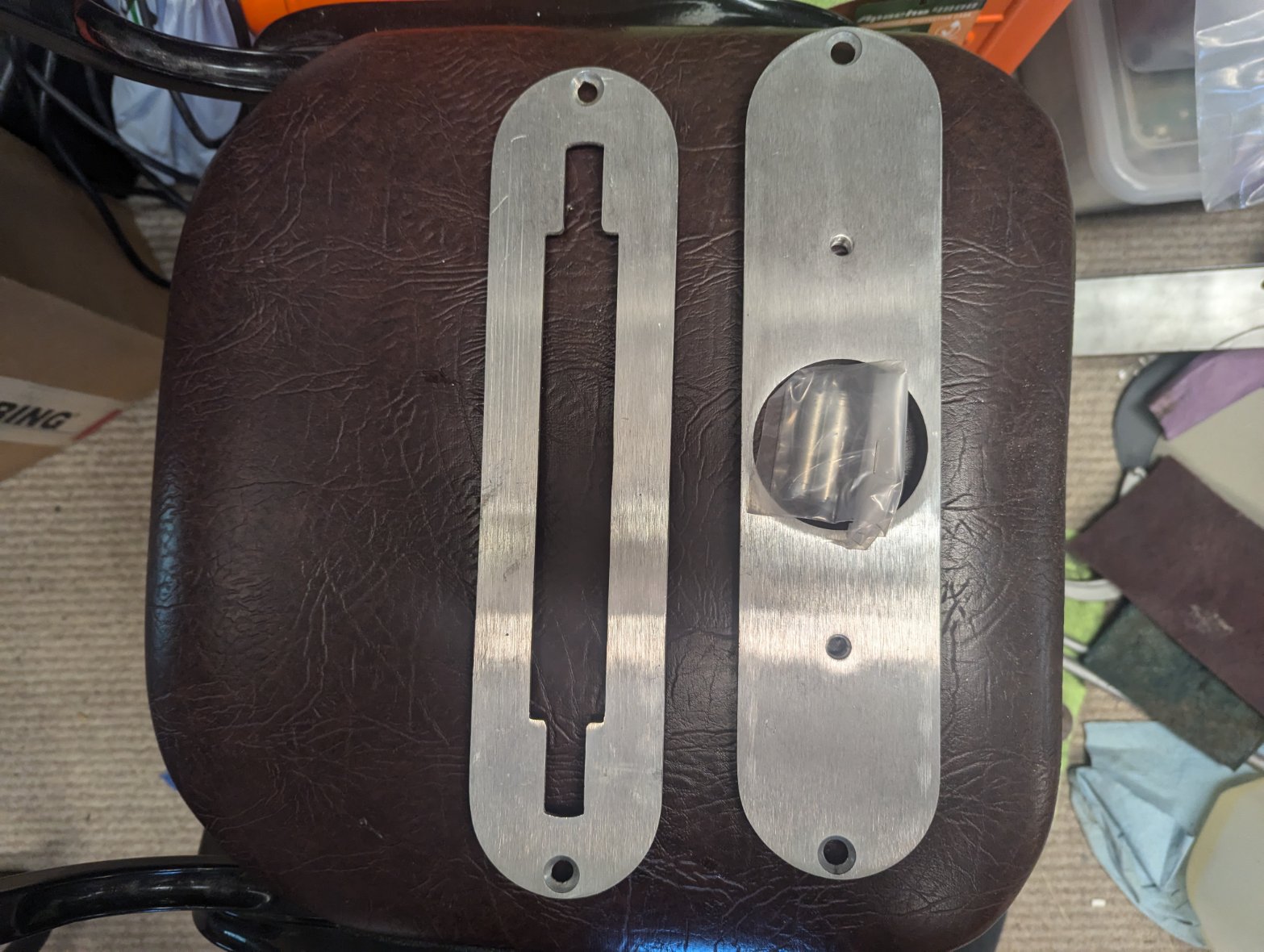

Just received another Ebay package. I was able to pick up a datto insert and a molding insert. The molding insert was even in the origianal packaging.
They are so clean, I just need to wax them. Yay!

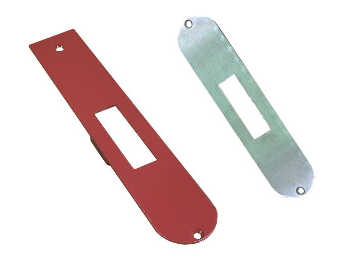

The picture above shows the Dado Insert that has the slot long enough to use the Saw Blade also. The other insert is the Router/Shaper insert. It's nice that it includes the starter pins. Some sellers don't always know what the really have. The Molder Inserts for both the 500 (right) and other models (left) are shown below.

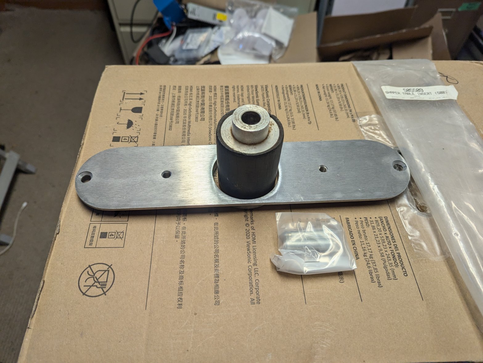

Yes, I mislabeled it. I was able to get the molding insert also. Correct me if I am wrong, but you can use the router/shaper insert for the drum sander also?

Only if the drum sander is small enough.(that is the only restriction)

It fits, Yay.

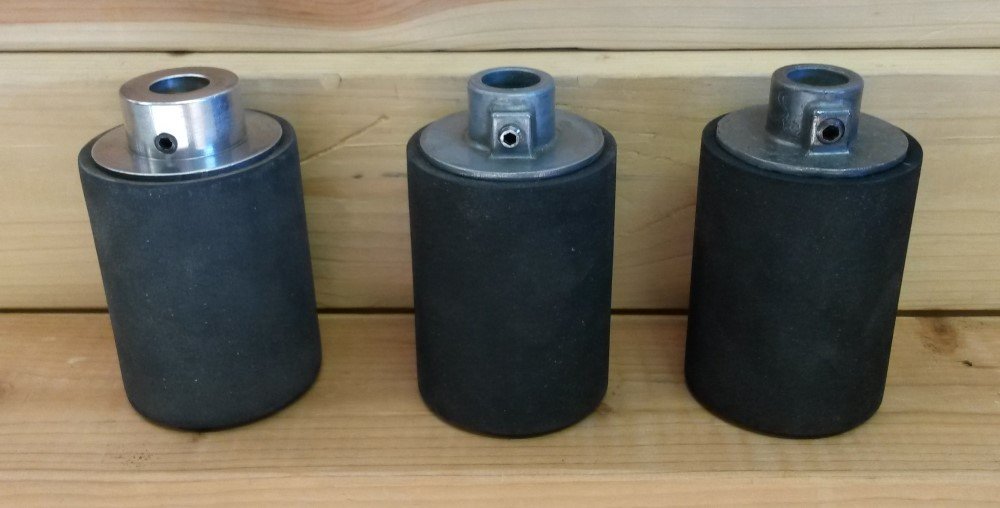

Looks like you found an early Shopsmith Drum Sander. The machined aluminum Drum Sander is from the Model 10E late 1940's era. It was replaced by the cast Aluminum Drum Sander we still know today. The first cast aluminum Drum Sander made until 1953 used a smaller 1/4" set screw which changed to a 5/16" (using a 5/32" Allen Wrench, AKA the Shopsmith toolbox) in 1954 for the Mark 5. Those different Drum Sanders are shown below.

Note the set screw size difference in the cast aluminum ones.

I guess I can live with the smaller set screw.
