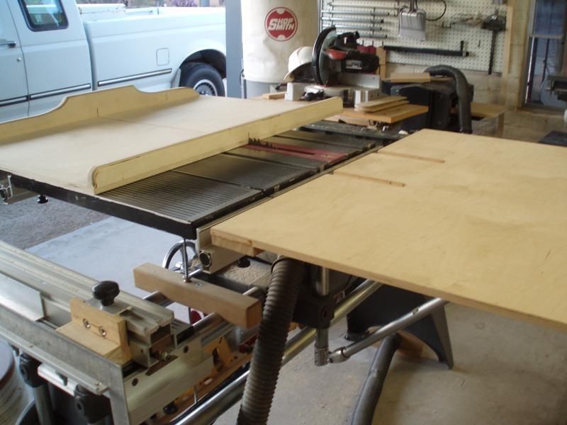

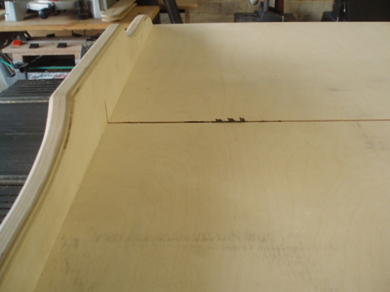

Cross Cut Sled

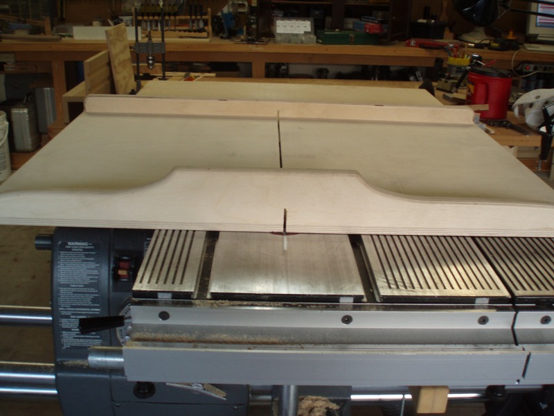

Until yesterday I thought I had completed work on my newest cross cut sled (except for a coat or two of urethane) so I decided to put it to a test. It failed...or should I say I failed.
The sled is equipped with two Shopsmith miter bars (eliminates wiggle all together). The table is 24" x 36" and has capacity to cross cut a 22" panel. That is failure #1; it should be at least 2" deeper so that it could handle a 24" panel.

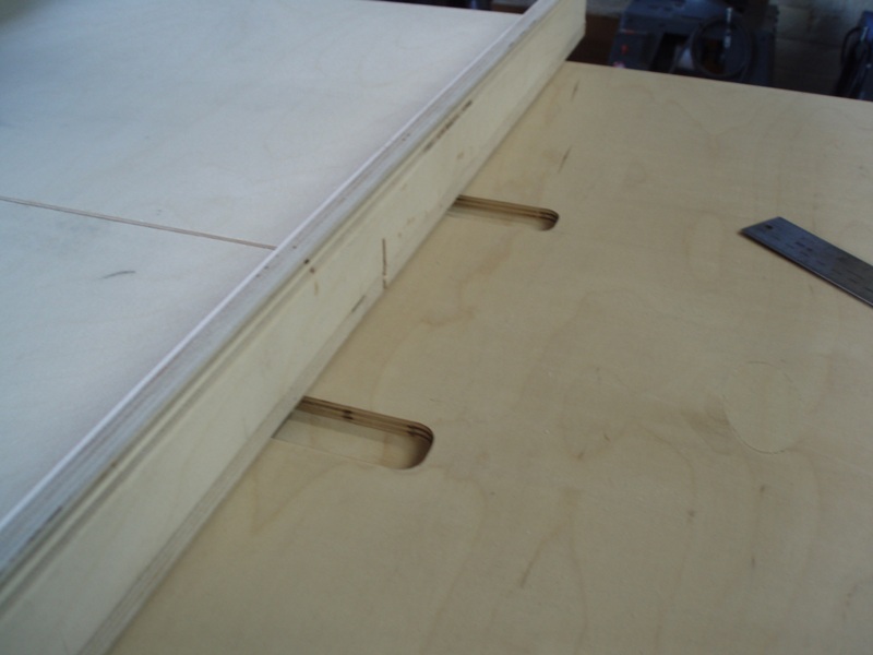

Then I went to do some work and it failed again. I had the outfeed table installed only to discover that the cut outs (on the outfeed table) for the miter bars interfere with the miter bars on cross cut sled. Those cut outs need to be at least 6" longer so that the cross cut sled will clear the blade.
I'll treat this as a learning experience and partial success. At least there is no scrape as a result of the failures. Once I route the miter bar cutouts in the outfeed table I will be done with this project. Just in time for picnic tables and benchs.

Solved the Limited Table Space Problem (Almost)
[ATTACH]12934[/ATTACH]
Can't Go Further
[ATTACH]12935[/ATTACH]
Need Seven Inches More To Finish a Cut
[ATTACH]12936[/ATTACH]
Too Short
Crosscut Sled (New) Here's Why.jpg (72.64 KiB) Viewed 5568 times
