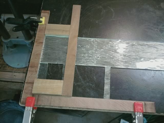

I got the glass (THANKS MickyD!!!) late last week. It was already cut to width so I started cutting it to length a couple days ago. I made a jig that would hold the glass in place and I could use spacers to set the straight edge that guides the glass cutter.
I miscalculated something and my glass came out about 3/16" longer than the plans called for. Good thing I cut the glass before cutting my wood to length! All I have to do is just adjust how long I cut the stiles and where I cut the half lap joints for the rails. That's a point for the "cut the glass first" argument.
I had already cut the rails and stiles to thickness and width. To get an idea of how everything would fit together, I mocked up one side of the stiles along with how the adjacent sides would mate. I laid the stiles flat and set a piece of glass on top of them. I propped the mating stiles (for what will be the adjacent sides) on top of the first set of stiles with the outside edges flush. Then I fit in another small piece of scrap glass on edge between the flat piece of glass and one of the side stiles. This was to test the fit of the glass as described in MickyD's attached PDF in post #32 of this thread. I'm not sure if my explanation made much sense, so here's a graphic to hopefully confuse you even further.

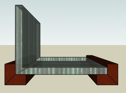

Ok, here's the quick Sketchup I did. End view of the stiles on two corners and two panes of glass. Done very quick, NOT to scale or using accurate measurements.
The "before" picture. The horizontal pane of glass barely fits on the stile on the left.
[ATTACH]8837[/ATTACH]
The "after" picture. I did not change anything about the glass. All I did was make the stiles a little thinner (I did not change the width), then put everything back together.
[ATTACH]8839[/ATTACH]
Now, the glass has more room to overlap the stile on the left.
