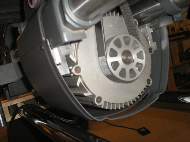

OK, JUST FOR YOU GUYS :) .... I had the afternoon off and opened up the Power Pro. After an hour or so of running, thought I would recheck the belts and take some pictures.
The manual and DVD note that the 2 belts run plenty tight, in order to transmit over 1-hp at lower speeds. At lower speeds you get the sense that the electronics are regulating the speed, rather than the flywheel inertia effect as in the previous system. I will be interested in what other folks think of how this machine runs the heavy sanding disk -- it's a little different. It seems to electronically "clutch/unclutch" when you ramp it up to speed, for instance. That effect generally doesn't happen with a saw-blade or a drill-bit.

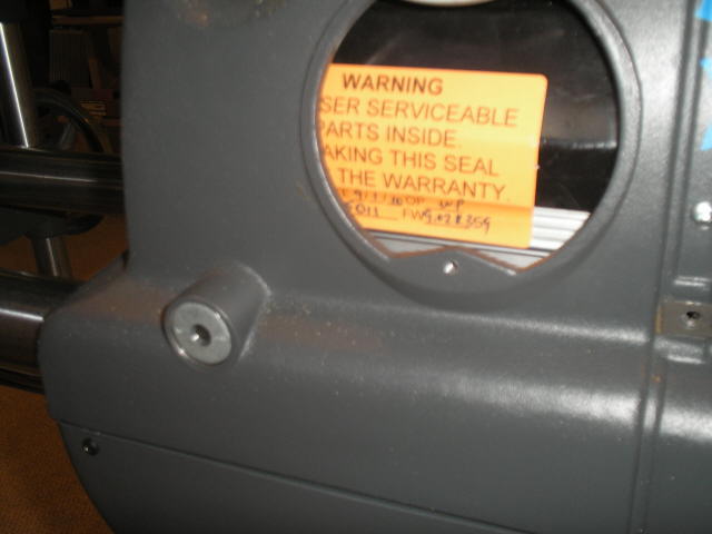

Through the old Service Plate... you can now do nothing, see nothing... except the electronics module:
[ATTACH]10335[/ATTACH]

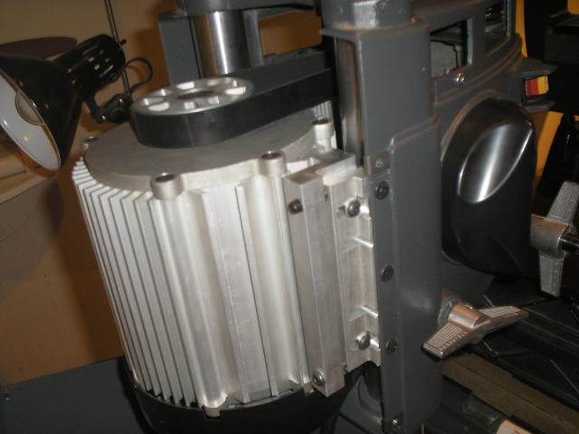

A good look at the motor mounting hardware. All screws are Metric. However, the TRUE GENIUS of Shopsmith has anticipated this decades ago, since 5/32 wrenches are virtually identical to 4mm wrenches:
[ATTACH]10334[/ATTACH]
How everything nestles inside the motor pan:
[ATTACH]10333[/ATTACH]

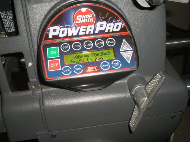

A nice picture of the operator's control panel. Cool shapes on it to let the headstock lock work with plenty of room:
[ATTACH]10336[/ATTACH]
Motor Tucked In.jpg (40.04 KiB) Viewed 2273 times
Mounted Motor.jpg (38.29 KiB) Viewed 2273 times
No Room Left.jpg (30.57 KiB) Viewed 2271 times
Ready to Run.jpg (56.05 KiB) Viewed 2276 times

The motor-mount actually has several sets of set-screws and locking features, but it is pre-aligned by Shopsmith. I have iterated my mounting adjustments just a tad bit to compensate for slight drilling errors of mine that I can see in the mount to the headstock-casting. When everything is right, you can hit 9500+ rpm. When there is anything wrong to apply binding or lateral forces or unbalanced vertical forces to the belts / bearings, then the machine won't hit that speed, not to mention making more noise and heat.
