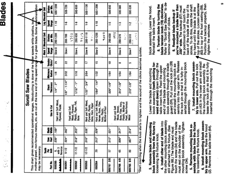

I went through the owners manual and oiled the seal and went through the bladed squaring procedures, blade mounting ect. However the blade tensioning is a little foggy to me. They don't address how to know when its adjusted properly. There is a little knurled nut under my black knob that actually threads down and increases blade tension. (my knob is the last component of my saw that shows abuse from the PO,it is slightly bent but still turns-just not super smooth).
So where do you start and when and how much do you adjust?
On the V shape blade guide, how close to the back of the blade should it be?
Whats with the ticking?
What would a rule of thumb be for blade speeds?

All I can tell you is that when you plunk the blade it should twang in the key of c.
Otherwise, cut a way and if you don't break blades, tension is close to correct.
Seriously, I think this is an adjustment that you have to work to achieve and when you finally have it, you'll know.
Don't force the wood into the blade; let the blade do the work. Forcing the cut will also break blades faster than you can afford.

How close do you adjust the Vshape guide behind the blade? Its not like the bandsaw, with a bearing to ride on.

I put it about as close as I can get it without touching the blade.

[ATTACH]19265[/ATTACH]
Make sure the blade is pushed all the way into the block.(minimizes mounting hole separation.
Ticking may be caused by upper arm hitting the arm cover(blade too long), or slop in the linkage between the upper and lower arm(tension rod).
More reading. https://forum.shopsmith.com/viewtopic.php?p=109710&postcount=27
See Post #30 https://forum.shopsmith.com/viewtopic.php?t=7946
page 9 reduced annotated.jpg (258.06 KiB) Viewed 4897 times

Thank you JPG and Dusty for all the help. I think I have done as good a job as possible. I've made a couple test cuts just to put dust on it.
