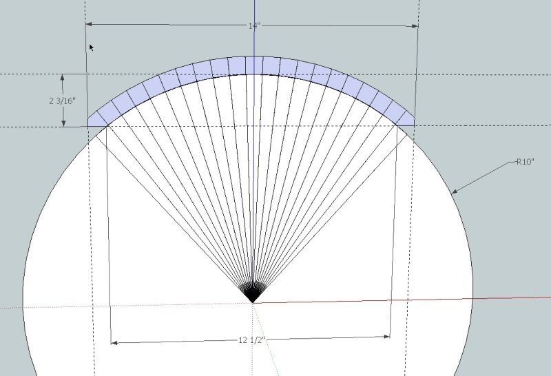

New and revised using the 2 degree angle rather then the 3/4" x 23/32".
I started from scratch, a 10" circle, centered a 3/4" x 3/4" square. Struck lines from the center of the circle to the top edges of the square. How about that the angle is 2 degrees off each side. That means the top is 3/4" and the bottom is 45/64".
Doing a 4 degree rotation to the right and left until I came to a total of 21 pieces. They fit the 10" radius and they fit the 12-1/2" and 14" dimensions pretty well.
[ATTACH]24128[/ATTACH]

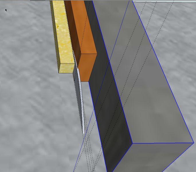

I've worked out how to make the necessary cuts without too much effort for me. However explaining it becomes a bear.
First I would use a good quality rip blade, no sanding necessary. I would set up the rip fence to the right of the blade. I would add a sacrificial fence to the rip fence. I would tilt the table 2 degrees to the right. Blade depth of about 1" should do.
The work piece would be cut with the 3/4" side down. The cutting edge of the blade will have to be inset into the sacrificial so it cuts the full kerf at the point were it meets the table. The top of the blade has to be high enough to make a full cut.
With workpiece being held against the sacrificial fence the blade needs to be such that none of the lower edge is removed.
One pass on each side will do it.
Clear as mud, right?
EDIT: Added sketch
[ATTACH]24130[/ATTACH]
Sacrificial fence and workpiece have been modified so the relation to the blade would show. The sacrificial fence needs to be the length of the rip fence to work correctly. Kerf width shown is 3/32" this will vary with blade selected.

Only the initial setup.dusty wrote:How many times will you have to reset the fence doing it this way?
It is desirable to keep the 'top'(3/4") edge off the table so the pointy corner(92°) is pressing against the fence above the table(the fence has clearance between the bottom and the table). Tight to the table and fence are important(yes Beeg I already said that:D).
