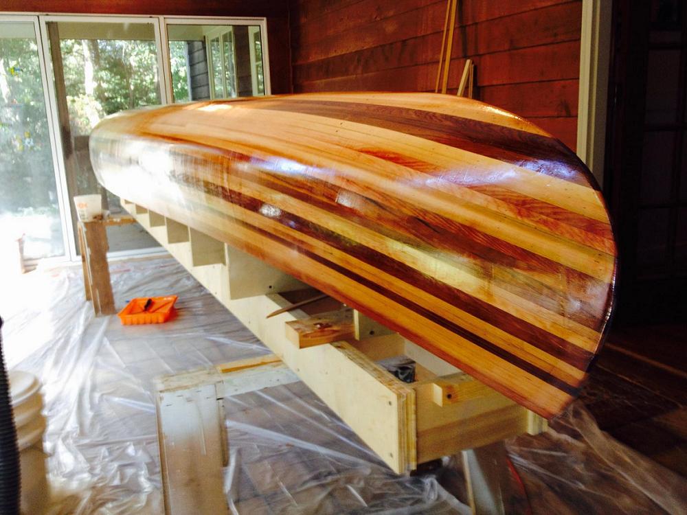

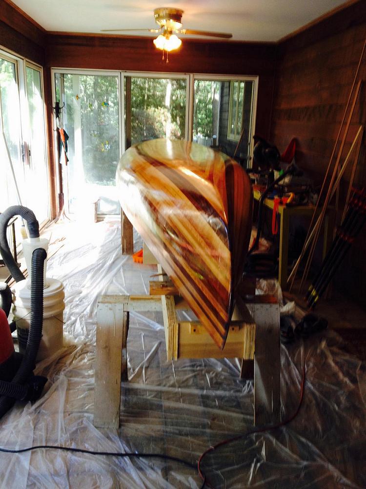

Redid the Sealer Coat
I wasn't happy with the original sealer coat. After sanding I could see I was too stingy with the epoxy and there were still some minor gaps. My book said this was a possibility and if needed just to redo it. So here it is, sealed with fiberglass reinforcement on the ends. It seems a shame to sand it back to a dull white for the full fiberglass layer.
[ATTACH]26293[/ATTACH]
[ATTACH]26294[/ATTACH]
It's a little too late, but I'm also beginning to have doubts about my choice of cloth. The usual cloth on these strippers is 6 ounce e-glass with an 18 x 18 plain weave. I chose 6 ounce s-glass with an 18 x 18 plain weave. I chose the s-glass over the e-glass because it is reportedly far stronger and has more abrasion resistance (also far more expensive
). But I have read on several canoe forums that even when it is filled the weave tends to show up as a shadow even though it is clear. Oh well, the fiberglass budget is busted so I'll just have to live with it.

- Posts: 35598
It'll look purtier after the next coat!
