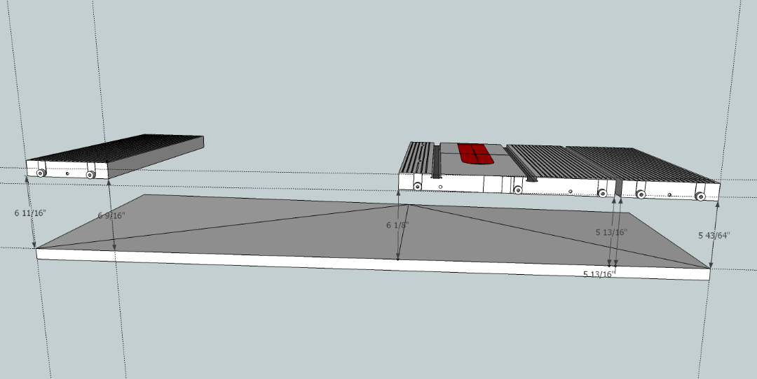

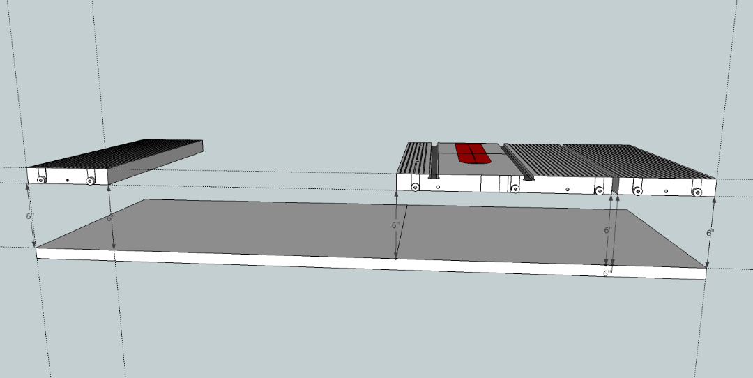

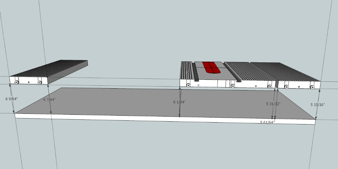

Re: Truing, As Best You Can, Shopsmith Table Tops
Some images in summary of what I have learned.
The lower rectangle represents the plane of the Way Tubes while the Tables represent a Main Table and Two Extension Tables all perfectly aligned.
Main Table with Two Extension Tables Tilt = 0 degrees.png (86.34 KiB) Viewed 1855 times
This image shows the entire table system tilted right 1.0 degrees.
Main Table with Two Extension TablesTilt = 1.0 degree.png (101.08 KiB) Viewed 1853 times
This last image (I promise) has the tilt set at only .2 degrees.
Main Table with Two Extension Tablestilt = .2 degrees.png (103.46 KiB) Viewed 1853 times
This is intended to emphasis the difference in height of the two extension tables above the plane of the Way Tubes. I believe this relationship as depicted here shows why people have difficulty utilizing the extension tubes on both ends of the Shopsmith and aligning them utilizing a straight edge.
After being setup, if the Carriage is moved the planar relationship of the tables change (unless the Main Table is perfectly parallel to the plane of the Way Tubes at the time of alignment).
