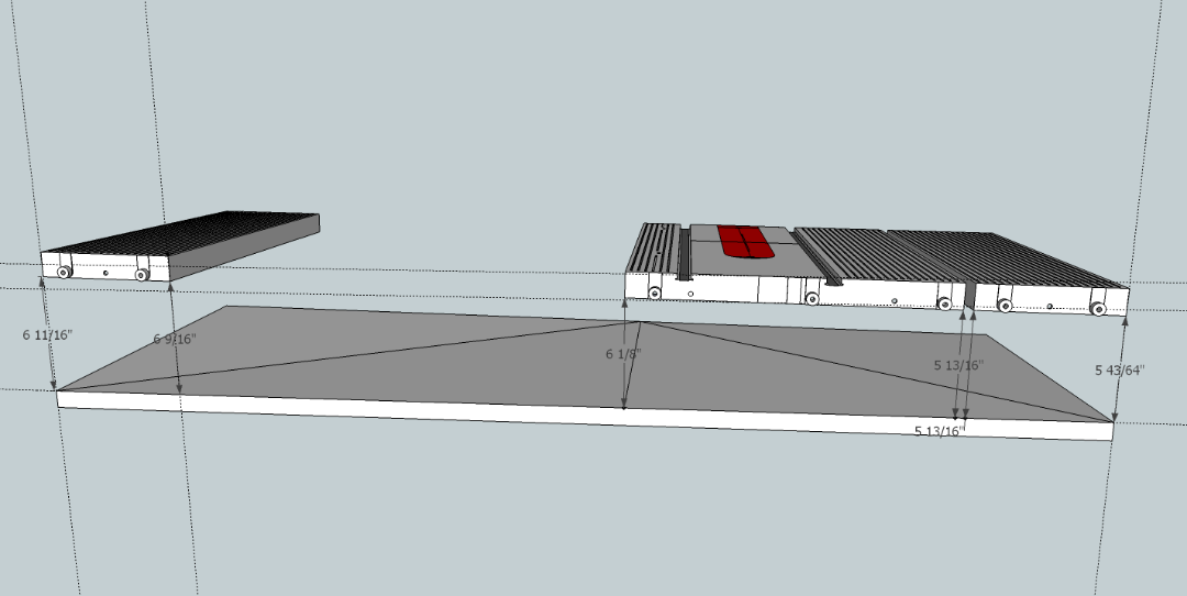

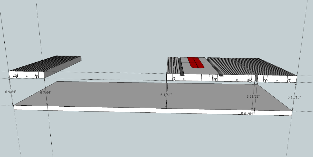

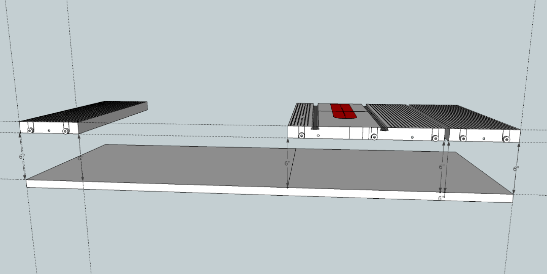

Some images in summary of what I have learned.
The lower rectangle represents the plane of the Way Tubes while the Tables represent a Main Table and Two Extension Tables all perfectly aligned.
Main Table with Two Extension Tables Tilt = 0 degrees.png (86.34 KiB) Viewed 1866 times
This image shows the entire table system tilted right 1.0 degrees.
Main Table with Two Extension TablesTilt = 1.0 degree.png (101.08 KiB) Viewed 1864 times
This last image (I promise) has the tilt set at only .2 degrees.
Main Table with Two Extension Tablestilt = .2 degrees.png (103.46 KiB) Viewed 1864 times
This is intended to emphasis the difference in height of the two extension tables above the plane of the Way Tubes. I believe this relationship as depicted here shows why people have difficulty utilizing the extension tubes on both ends of the Shopsmith and aligning them utilizing a straight edge.
