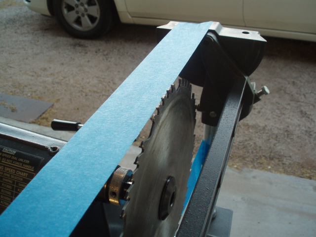

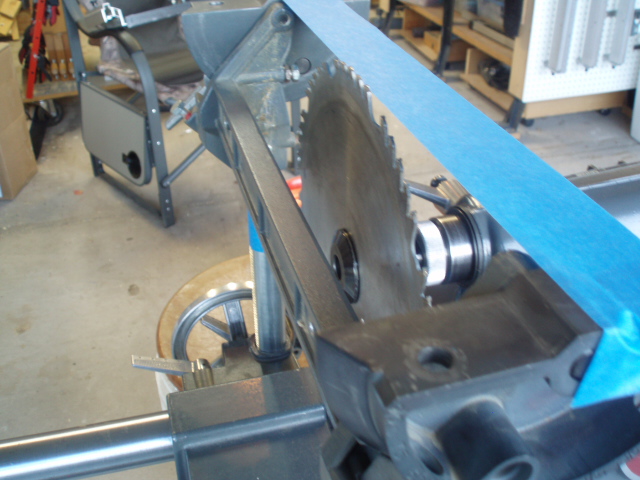

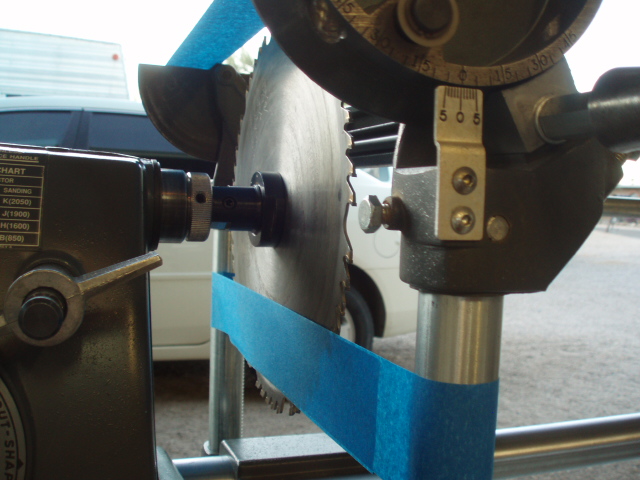

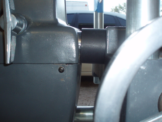

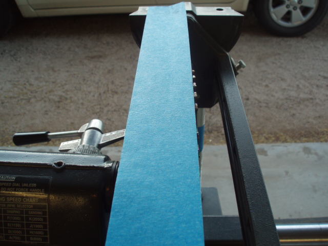

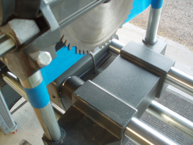

JPG wrote:I think we need to start looking at the headstock to carriage distance.
Table mount tubes to where on headstock?
I think these images, if replicated on the machine in question, would show that every thing there is as expected.
Carriage Stop Ring 002.JPG (143.18 KiB) Viewed 5858 times
Carriage Stop Ring 006.JPG (144.36 KiB) Viewed 5858 times
Carriage Stop Ring 007.JPG (152.27 KiB) Viewed 5858 times
Carriage Stop Ring 008.JPG (152.1 KiB) Viewed 5858 times
Carriage Stop Ring 009.JPG (135.91 KiB) Viewed 5858 times
Carriage Stop Ring 011.JPG (150.32 KiB) Viewed 5858 times

The only variables are the width of the rubber bumper and the length of the saw arbor. Make sure the arbor is firm against the knurled knob and lock all the locks.
This setup sorta confirms design characteristics. This shows how the pieces fit together with respect to one another.

dynabase; when you get back to this task, please measure the length of your rubber bumper. I have two different sizes. They are 1.438" and 1.375".
At the moment only the 1.375" bumpers are installed. I believe that the newer bumpers from Shopsmith are 1.438". I have had communications from Shopsmith about the bumper dimension but at the moment I can not locate it.
