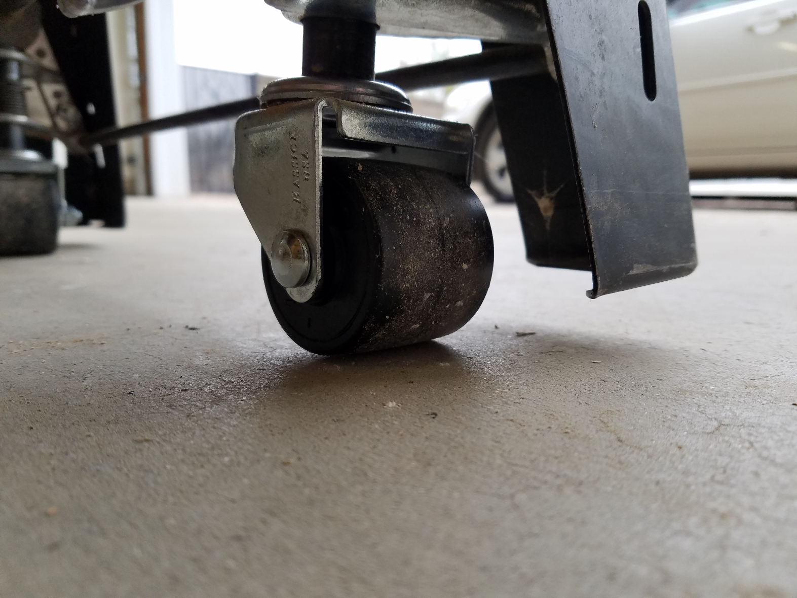

Back to the caster issue. I was out in the shop today so I took a look at the two machines that still have the old casters and at my OPR that has casters. In all cases the stem seems to fit pretty far in to the assembly. I have more machines but they are not located here so when I get a chance I'll look at them too.
Here is a picture of what mine look like:
This is what I expected them to look like from memory but now I'm sure.
I do have to ask, is every one tapping the wheels in to seat them? Like wise you have to tap them to get them out........ if not then that maybe why we are seeing different things.

Re: New Wheels for Power Stands or Pro Planer
The yoke on your caster shown here appears to be in very good condition. The wheel is not inserted as far as I thing they should go but is further in than I can get mine. I estimate the gap between the wheel and the plunger to be about 1/8". II am not surprised at what I see. If mine were like this, I would be pleased.
Yes, I tap mine with a rubber mallet to seat them.

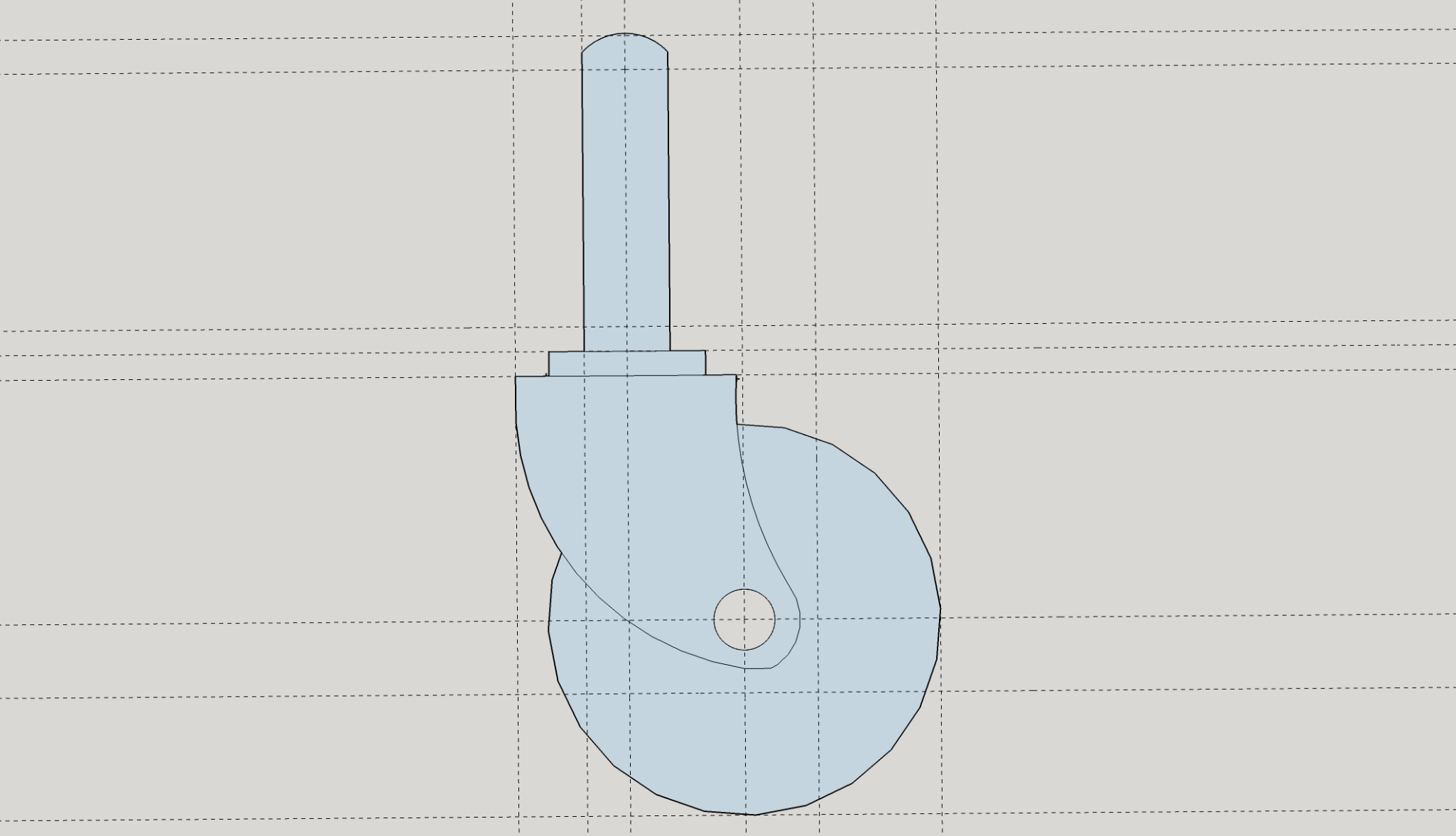

I wonder how long the stem is on the caster shown here. Knowing that, it would give some indication of how deep the bore is.
Would my wheel insert into that bore to that same depth?
The bore in my plungers (those measured) is 1 1/2" deep. The stem on my 2" wheels measure 1 7/8" long not including that small ring at the base of the stem (which is 1/8").
This gives me a 3/8" gap that cannot be overcome with a mallet.

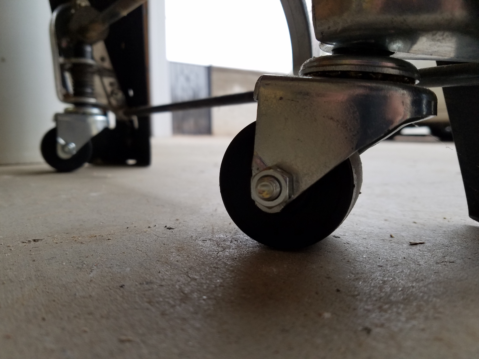

The wheels have arrived and have been installed. They work fine. They do not roll like the 3" casters do but they roll better than my old 2" casters. The body of the caster (the yoke) is decidedly more stout. I do not believe these will fatigue as the others have.
However, now that they are installed, I believe that I may have a plunger that is not setting vertical as they should. If this turns out to be the case it seems that it can only be caused by something in the caster assembly itself (not the plunger).
I also need to locate, somewhere in storage, the four rubber booties that belong on the bottom of the legs. In the full down position, the legs are not hard on the floor. The booties will resolve that.
Note that there is no gap between the plunger and the caster.
