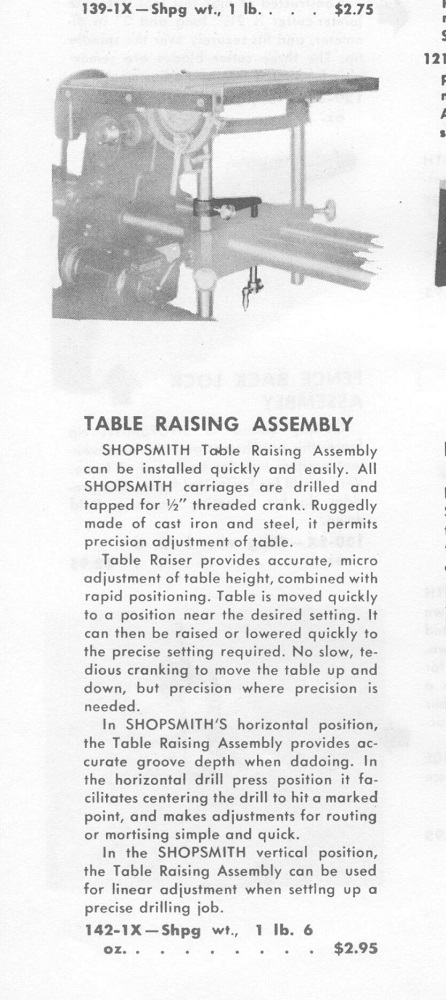

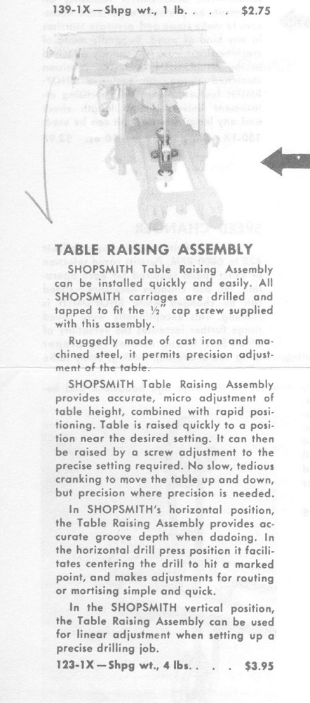

Going through some old catalogs looking for something else I found these. The first picture is from an early Model 10 accessories catalog. On page 4 of this catalog is a list of future accessories. The second picture is from an accessory catalog dated May 1, 1949. On the front page of that catalog is most of the future accessories listed on the last page of the earlier catalog that the first picture came from. Sorry my PDF's of the catalogs are too large to post here. I also have original printed copies of these catalogs.
- from early Model 10E catalog
- Page 2 early catalog.jpg (143.55 KiB) Viewed 23289 times
- from May 1, 1949 catalog
- Page 2 May 1 1949.jpg (152.02 KiB) Viewed 23289 times
This appears to answer the question which Table Riser came first and about when the more common Table Riser Assembly became available.
