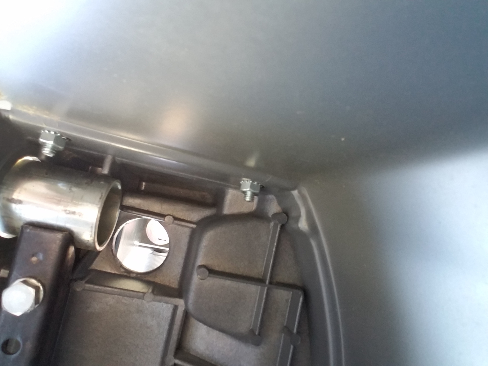

Just to verify past assumptions (on my part) I took photos of the bench tubes where they contact the mechanical stops. Here is one of those:
At a glance, this doesn't look any different than one taken before the double tilt.
After verify that both tubes were fully inserted at both ends, I measured the exposed bench tubes. They both measure 48 3/8". Assuming they are buried equally at both ends, they get buried into the Base 1 11/16" (not 2"as previously asserted).
Looking at this photo you can see that if the bench tubes are inserted too far, mounting of the extension tables would be obstructed.

It is not necessary to turn the machine over to view the tubes to determine which end (if either) is inserted incorrectly. I posted in this thread a picture that shows just that. The tubes up against the stops. If you don't have a camera, trying laying on your back and looking up at the end of the tubes.
