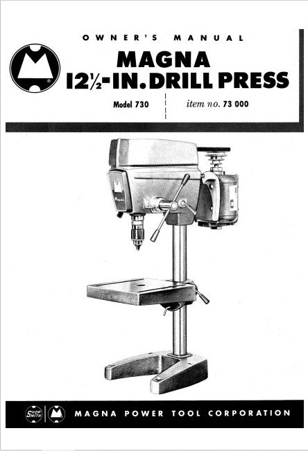

Below is a picture of the cover of the Manual for the Magna 12-1/2" Drill Press Model 730. It was part of the Magna Line tools which also included the Magna 9” Tilt Arbor Bench Saw, the Magna 12-1/2” Jig Saw, the Magna 30” Wood Lathe, the Magna 4” Belt Sander and the Magna 10” Contractors Saw. These tools were not as popular as the Shopsmith Mark 5 being made at the same time in the 1950's so few are ever found for sale.
_ .
This is a case in the confusion of the use of the names Magna and Shopsmith. Shopsmith originally was the name of the first 5 in 1 tool the Shopsmith Model 10E and was made by Magna Engineering Corporation. The Model 10ER followed and was later discontinued when the Shopsmith Mark 5 was introduced by Magna Engineering Corporation. Until Shopsmith Inc. was formed in 1972 to continue the tool line, Magna tools were a separate name from the Shopsmith Tools of the Model 10's and Mark series tools. Even the early SPT's which were called Add-a-Tools were Magna Tools not Shopsmith. Another reason for this name confusion is demonstrated on the cover of the Magna Drill Press shown above having the Shopsmith logo next to the Magna logo and their similarities.

I grabbed the manual from your link and I am going to send it to him to see if its a match.
Thanks for the info Russ
