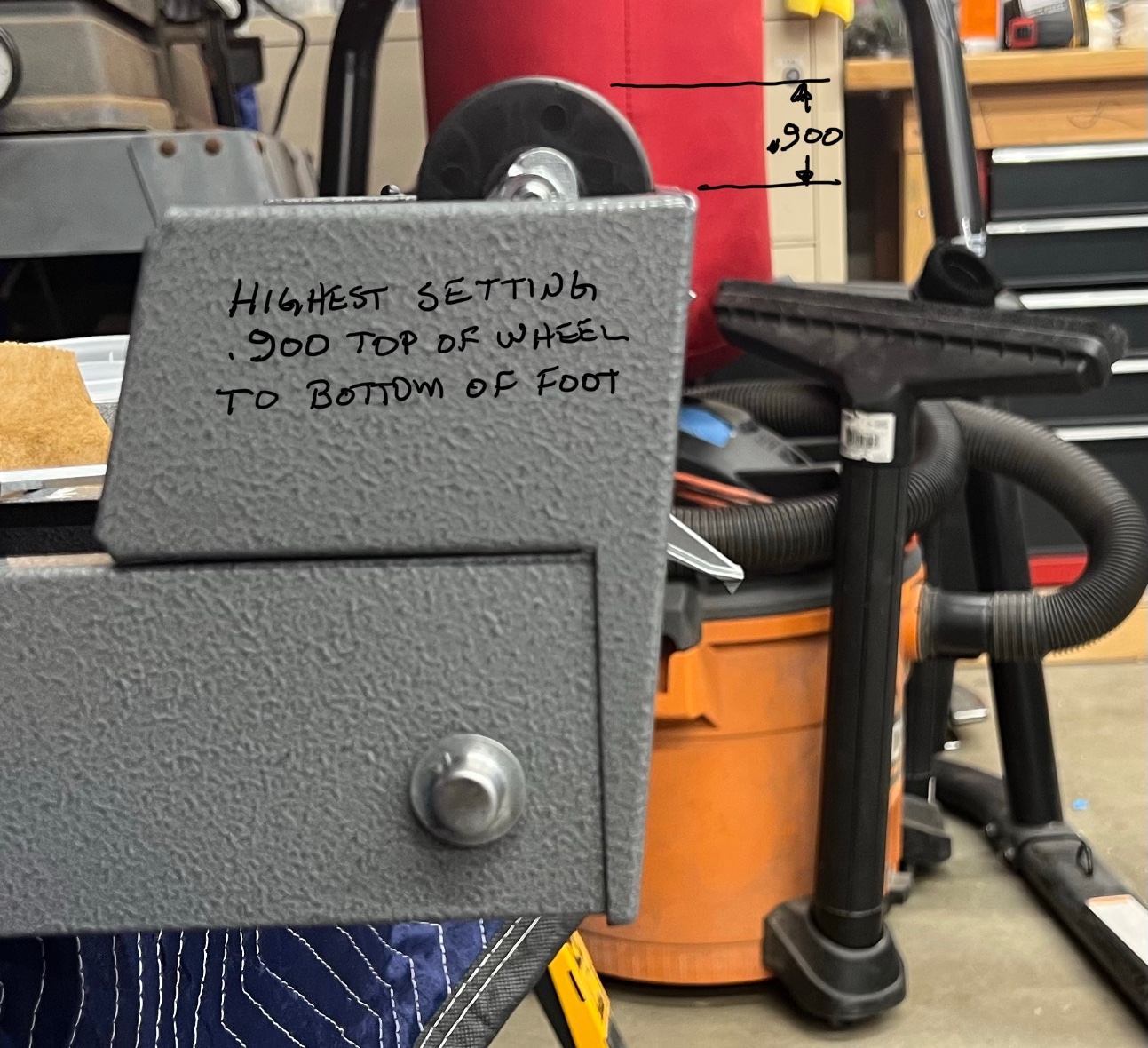

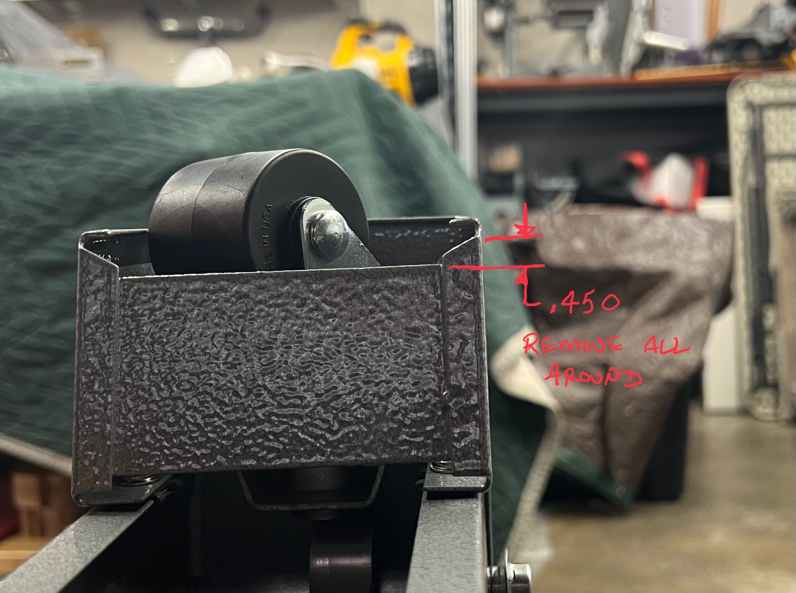

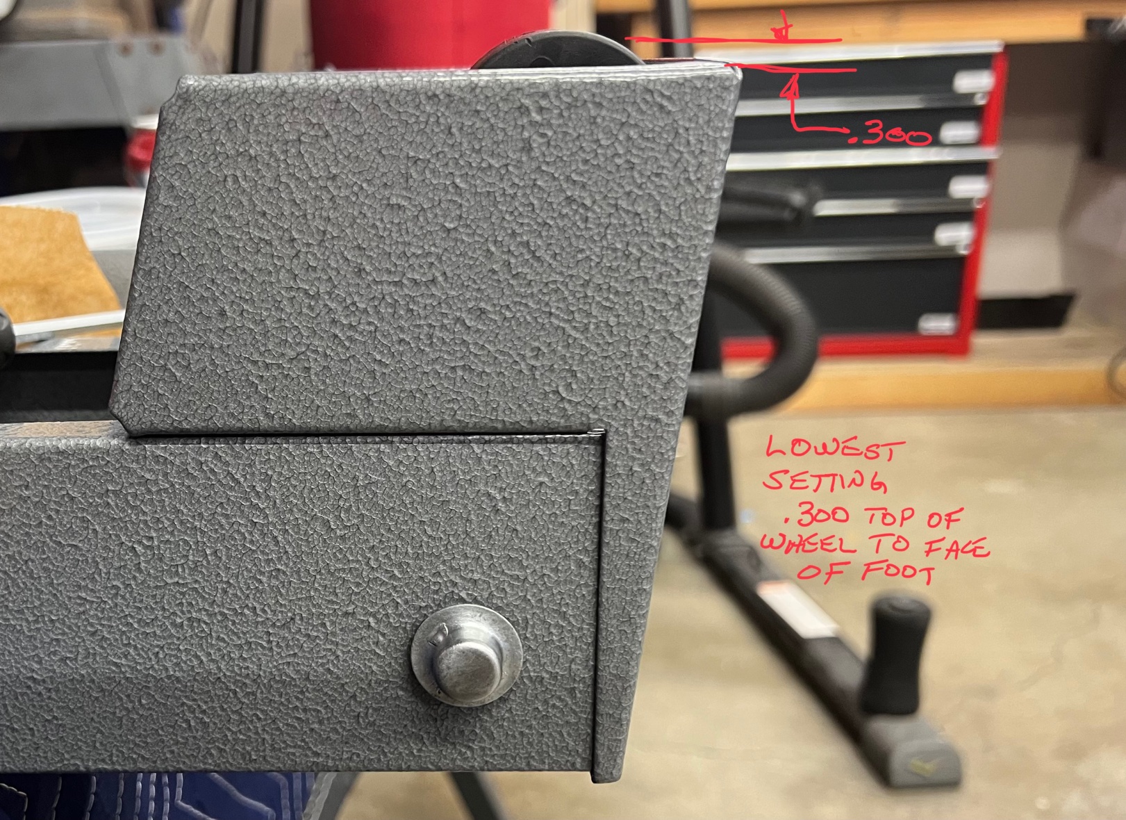

Miken and JPG, new setup has issues but I think I’ve devised a work around per below. I’m gonna let it bounce around in the air between my ears for a few days. Thank you both for the insight.
- 1CB3AFBC-5BE2-4E9D-92F4-4BCF98A8AB24.jpeg (715.94 KiB) Viewed 1471 times
- 5B93102F-7DE4-4D36-80F6-DA1A8103CB19.jpeg (499.22 KiB) Viewed 1471 times
- 03F5212D-B833-49CA-8DA6-5D2AB10B8D37.jpeg (509.22 KiB) Viewed 1471 times
- 7B2B1CD9-09E7-4F9E-8B67-C6CA672202F0.jpeg (583.14 KiB) Viewed 1471 times

1 dimension missing. Clearance between the top of the caster frame and the bottom of the ss piston.

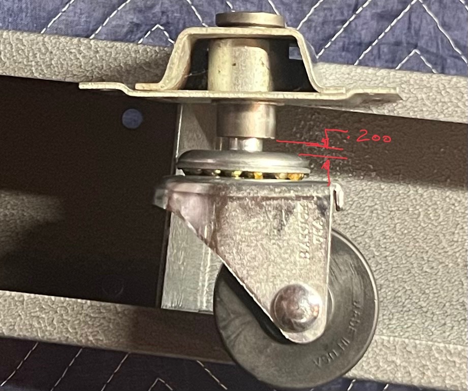

About .200 if this is the dim. See pic belowJPG wrote: Sun Sep 18, 2022 7:01 pm 1 dimension missing. Clearance between the top of the caster frame and the bottom of the ss piston.

Yes that is the one I questioned. Now what is the stem length? Also is there vertical slop?
The M5 casters although they do not completely clear the floor when 'up' they do not bear any weight due to slop.
Lowering to the first position, the slop bottoms out and the SS raises off the floor.
So take slop into consideration when determining dimensions.
Now back the the piston.frame clearance, Reducing that clearance to something closer to 1/16" or less will decrease the amount of added height to the foot. That .200 is 2/3 of the excess.
The lip on the piston limits the downward travel. That may preclude shimming the mounting plate upward.(max height position - #2 position).

JPG- I considered cutting down the stem but believe I still have clearance issues, of course I will measure twice and cut once. Still hoping for a brain breakthrough design change. Covid fog is still floating between me ears. Thanks for the input and I’ll review everything again.

The stems are 1/8" longer than oem MVII.

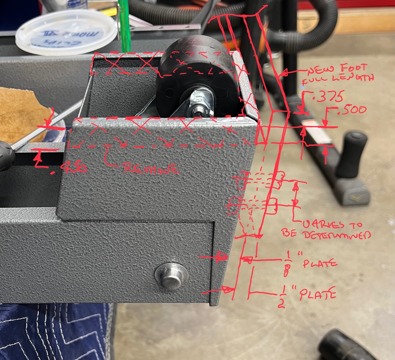

Interesting, I think the center lines on these are different and it pushes the wheel further towards front of shoe which is where my biggest interference is. Pretty sure it’s going to hit there unless I cut the shoe down and that creates the need for the design I came up with. What do you think of the rest of the design if I need to go that way?

I know your question is directed to JPG, but I would avoid cutting your frame rails if at all possible. I would consider reducing the wheel diameter in combination with shortening the stem and moving the wheel axle location closer to the swivel rotation axis.Mike wrote: Sun Sep 18, 2022 11:46 pm What do you think of the rest of the design if I need to go that way?
What are the wheels made of? I would try removing the wheel, then make an arbor using a bolt to hold the wheel in the shopsmith and sand the wheels to a smaller diameter. Then, relocate the wheel axle pin up and over towards the stem. That, with shortening the stem could be enough.
May need to go with a wheel that's not as wide for it to lessen the rotational diameter. The diameter at the edges of the wheel is more than in the center of the wheel.
Thoughts?

Mike's wheels have bearings, so the stem does not need to rotate in the bore. He can effectively bottom out that gap completely, and shim the stem in the bore to eliminate all stem movement (wobble) caused between those two parts. There will still be wobble as the bore piece is not a precision fit in the brackets, but it would help.JPG wrote: Sun Sep 18, 2022 8:20 pm Now back the the piston.frame clearance, Reducing that clearance to something closer to 1/16" or less will decrease the amount of added height to the foot.

Miken and JPG- going to cut stem and shim, worse case I’m out 10.00 for a caster. Still think I’m going to add the new shoe but would wait to see if some of the other mods will take care of any stability issues. Thanks for all the assistance
