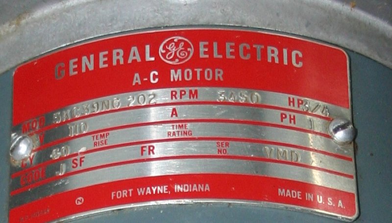

Still wondering if anyone has a diagram of the wiring on 3/4 hp greenie motor. Thanks folks.

Hopefully you can follow this picture for the wiring. The motor # is the same as yours.edward wrote:I'm just going with the three-in-one for now. Need to get this thing working this weekend. I'm going to finish cleaning today, and the try to press those bearings, beginning with motor. If the motor sounds good I'll move on to the rest.

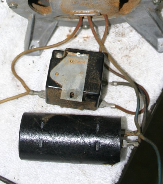

Motor Diagram
Edward - I apologize for the delay in this.....got hammered into the ground with work.
There should be 3 wires coming out of the motor: yellow, brown, and black. I may be off on the dark colors because I'm working in a shop area with one fluorescent fixture.
The colors for the power cord are from the original 1956 cord. Your new cord, I'm guessing, is white, black and green. White=tan, black=black, and green gets a spade connector and is attached to one of the bolts that hold the motor together.
When I pulled mine apart, I marked the capacitor lug that runs from relay connector 1 to the capacitor with a "+" sign. You obviously didn't do that.
Since this is all AC, it shouldn't matter which capacitor connector is used, but I'm not a electrical engineer ( just know enough to be dangerous
). I'm calling on this forum to weigh in here and confirm this.
Promised diagram below.

The drawing matches the pix. The capacitor is non-polarized, therefore terminal polarity doesn't matter. Wire colors seem to vary. pix motor leads appear to be white/blue/brown or red. Jumper between relay and capacitor appears to be black.

So glad to have an electrical engineer in the group!JPG40504 wrote:The drawing matches the pix. The capacitor is non-polarized, therefore terminal polarity doesn't matter. Wire colors seem to vary. pix motor leads appear to be white/blue/brown or red. Jumper between relay and capacitor appears to be black.
How come there is a capacitor on the motor? What's the relay do?
