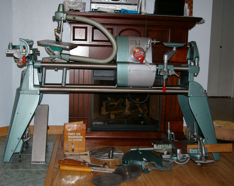

Final/Finished update
Hear is the 'final' update on this rebuild.
After this week it is going to St. Charles, Mo. I hope Mom and Ralph like it.
Just to show that it is the same one I started with;).
[ATTACH]8658[/ATTACH]
This is a full on shot with the Jointer and Jigsaw shown. They are going too.
[ATTACH]8654[/ATTACH]

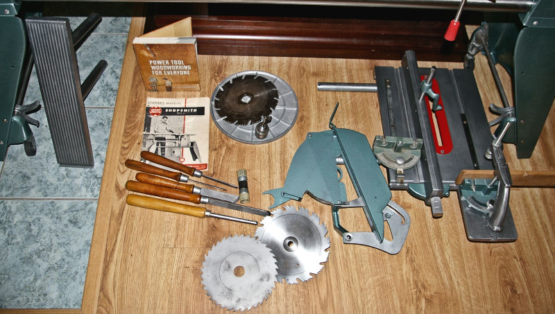

Accessories. The extra miter gauge is the original green paint for reference.
[ATTACH]8657[/ATTACH]
And there you have it.
Things I still need to do. New gasket and setup the Jig Saw. Get oil for it too.
Deliver it...
