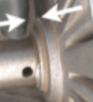

The oil hole is on the same area of the idler sheave as it is on the control sheave. Put it in high speed mode and turn it off. (Yes you will manually rotate the quill with machine off to wind it down to slow before turning it back on. In fast, the spring is not compressed tightly and you can pull it back without taking it off.
See a photo of the control sheave for where to look for the hole. If you have it in slow mode, that spring is so compressed there is no room to pull spring back.
Everett
