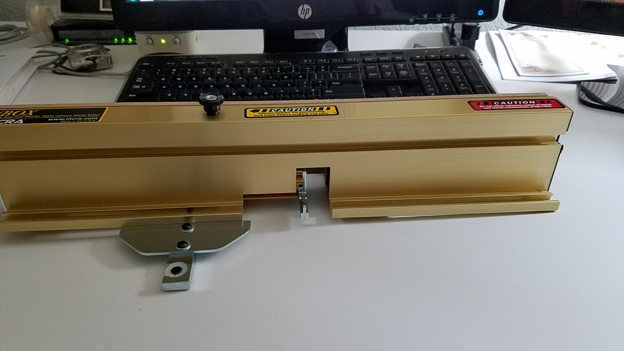

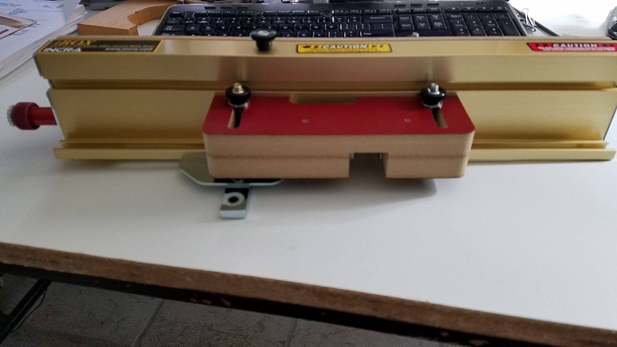

If you look carefully at Ed Reible's photos in the beginning, he has the I-Box set up to use the it in the right slot and turned it 180 degrees and located it in the left slot. It shows that the miter bar is in the front but in fact it is located to the rear as it should be if you want to use the right slot. He needs to turn it 180 and re-locate the miter bar to the rear of the left side.

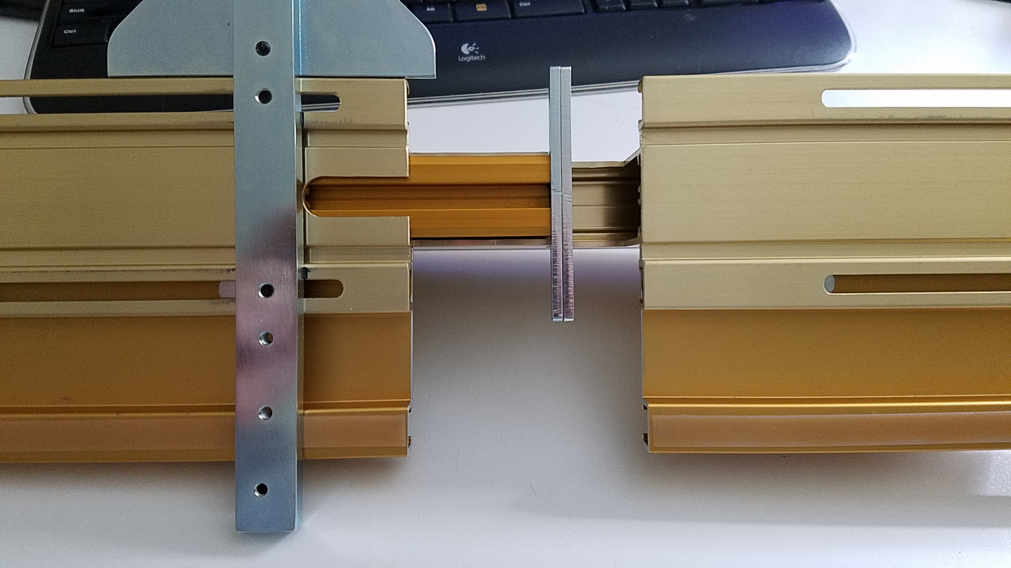

What I was most interested in was why some people were seeing the mounting hardware problem with the guards and others were not. I can now see how that is happening. I have no idea which is the right or wrong way but I can see that people are doing it differently. To that end I have redone one of my earlier posts on the subject and posted fresh pictures.

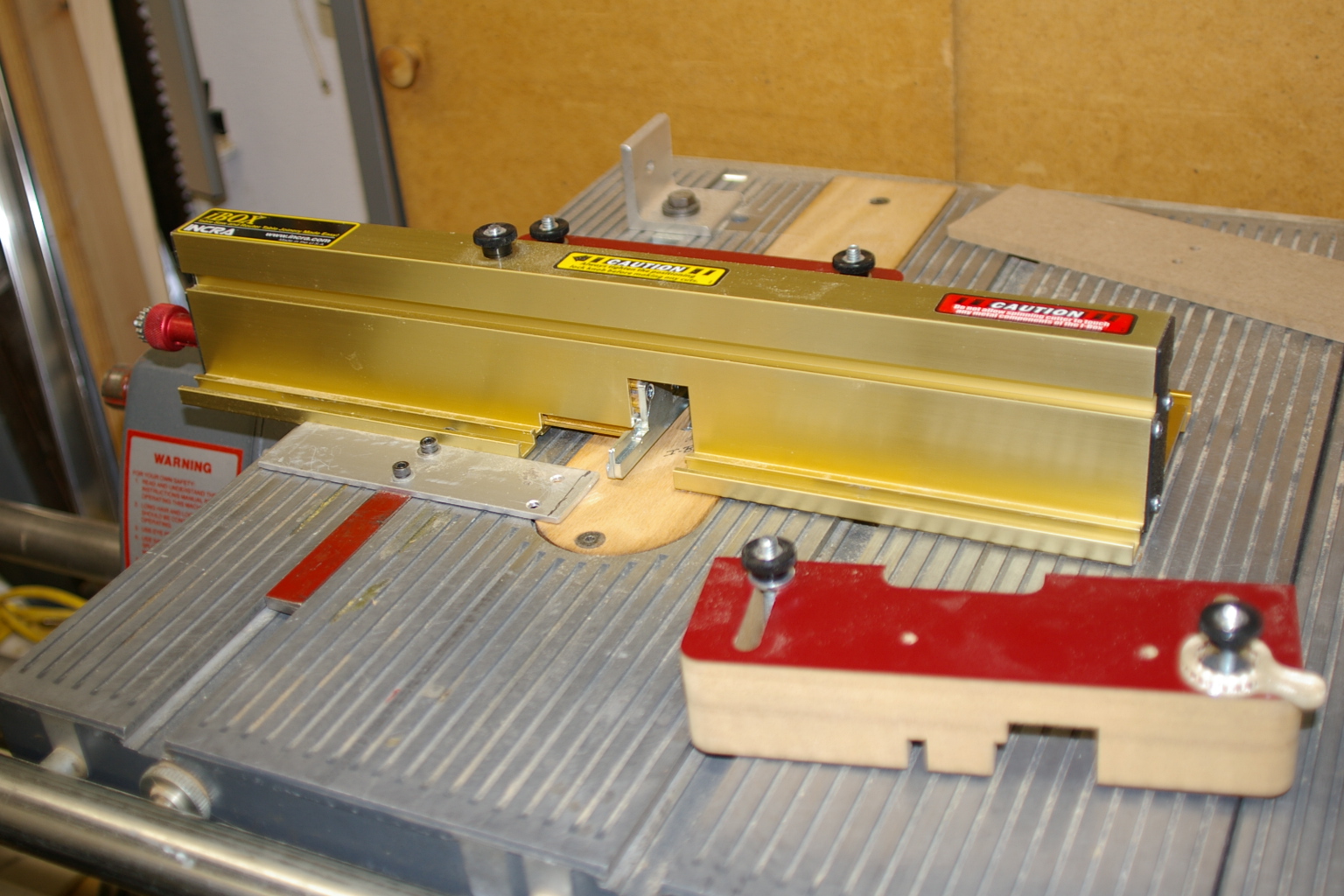

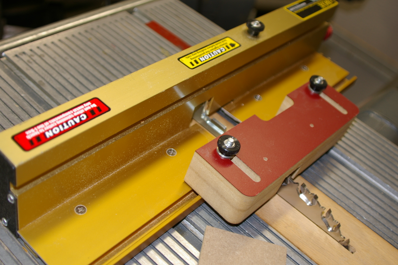

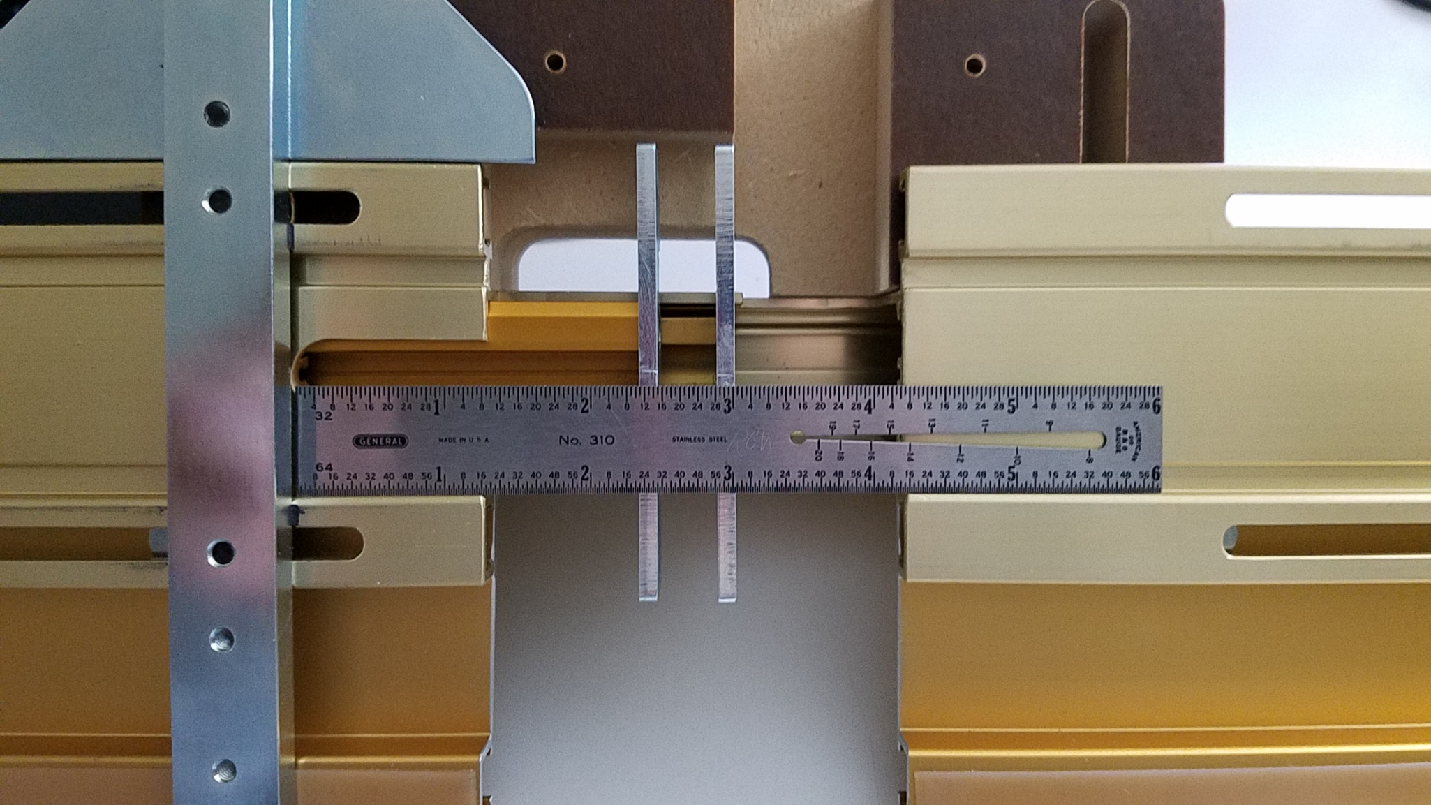

I hate to be the one to say it but we are still not in perfect harmony with this I-Box thing.
Looking at your blade guards vs mine, we are direct opposites. The location of the "tall tunnel" (on the blade guards) is what I am referring to.
Reference this image first and I will add one of the blade guards later. Notice the tall tunnel. This is where the blade travels. The guide pins are set for a 3/32" blade which would be to the right of the guide pins. As the blade width is increased the guide pins separate and move to the left. The blade remains in the tall tunnel.
Thus, it is my belief that the tall tunnel in the front blade guard should also be to the right of center. In the updated photo (your photo "B") shows the tall tunnel to be left of center.
In these last two photos you can see how the blade pins travel. Notice that they both move to the left as dado width is increased BUT the blade remains in the tall tunnel.

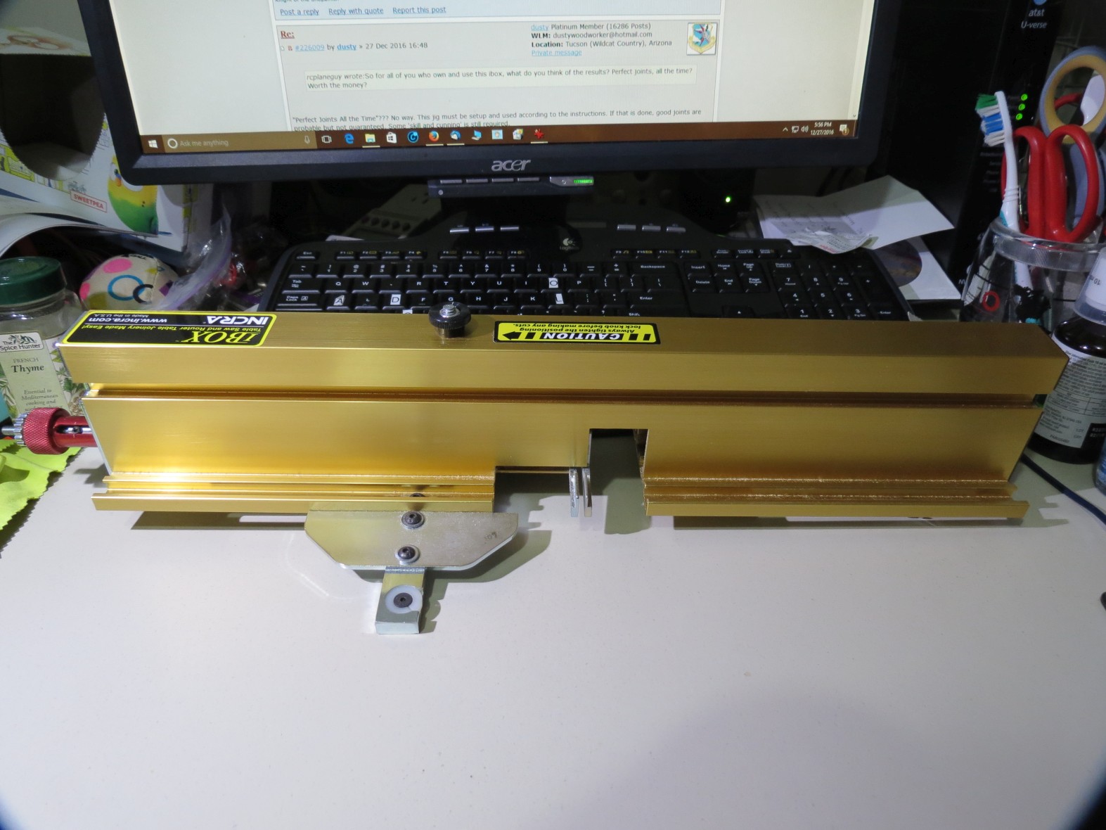

Re: I BOX review of sorts (spoiler alert)
I agree. Your photo is exactly like my set up. I just haven't installed the Incra miter yet. Mine works just fine so far so just haven't seen the need.
You will notice in the photos I got the blade guards mixed up initially and proceeded to make a couple of cuts that were not necessary
Senility again !!!
Also a tip. Did you notice the stop block in the left hand miter slot. Just don not like the blade coming out the back when making cuts.
Don G
Senility again !!!
Don G

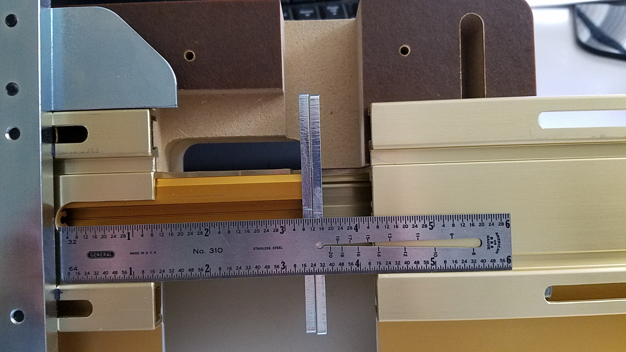

So lets get the two images in one post, first the one from dusty and then the one I just shot.
OK now what differences do we see?
Dusty's label are different then mine but neither of us put them on so that is an Incra thing.
Dusty has his set for a 3/32" cut which by the way is cautioned against on page 7 top right in LARGE letters.
Mine is set at 3/8" and as I have mentioned I've only done 1/4" and 3/8" joints on this jig.
So have at the rest of the things you see that are different.
you made a post before I got my 2 cents in Bummer!
Dusty's top photo is set for 3/16" but the bottom photos is set for about 1/2"
Don G
I do not disagree with these two photos. It is after you add the blade guards that we differ. You show two photos with the blade guards label "A and "B". I have one photo posted that shows a blade guard. It is not labeled but note that the tall tunnel (where the blade travels" is offset to the right. Your blade guard, labeled "B" (in same position as mine) has the tall tunnel offset to the left.reible wrote:So lets get the two images in one post, first the one from dusty and then the one I just shot.
I can't locate the two images to which I refer in the previous paragraph. But in the photos to which I referred, you had the two wooden blade guards reversed from what I show.
