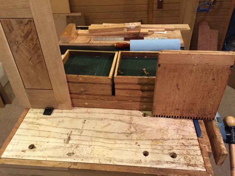

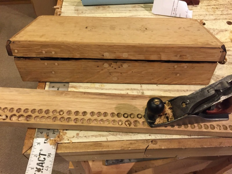

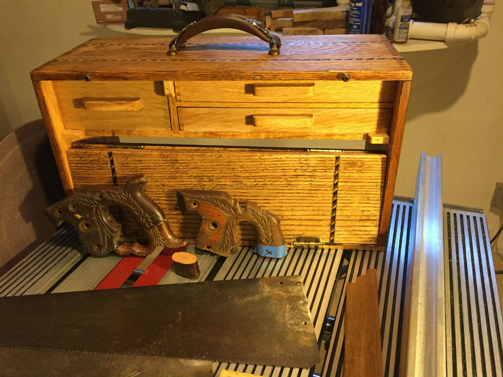

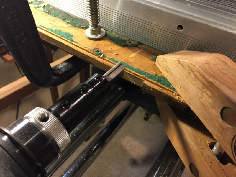

Just catching up a bit on tedious things... Again a heck of a lot of hole-plugs to install, but it's worth it for a tight box when new hardware comes along. The SS horizontal boring mode makes the hole-plugs go fast.

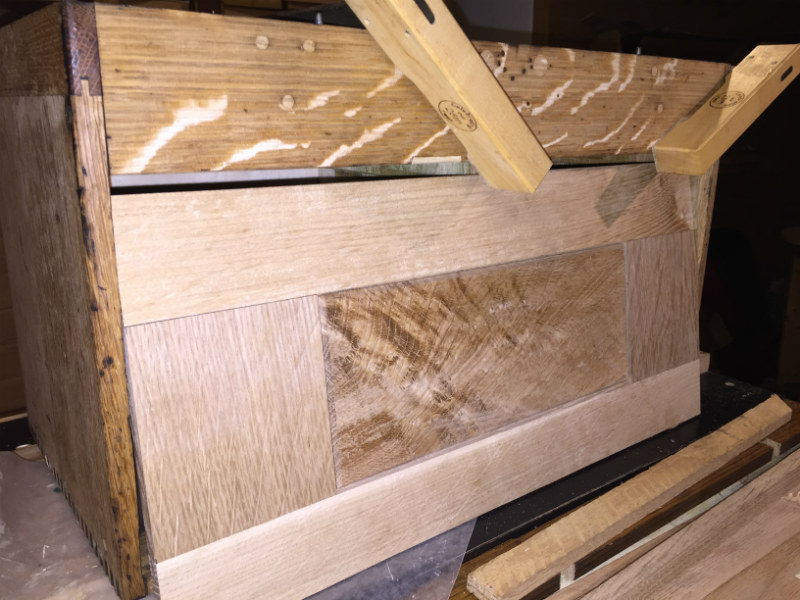

The frame&panel new front cover (on the left) worked out to have some of the best joints I've done in a while. I had used the SS table-saw for slots, and the SS Overarm Router for tenons. More hole-plugs shown on the drawers and sides.

nuhobby, do you align the grain of the plugs with the grain of the repaired panel and then finish the whole thing?
How do you keep the panel from looking like M&M's are all over it ..... :confused:

Thanks, Dick, I do grain-align the hole-plugs, but it's not super critical since these plugs are 90% covered by the replacement latches and corner-pieces. The replacements don't have identical hole-locations as the originals, so I have to plug the holes. I do like planing them flat; it's just fun!
The front-panel is a completely new fabrication, so no M&M plugged-holes will be there :) .

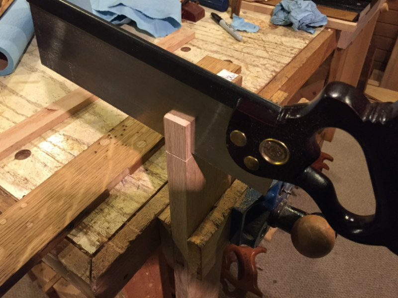

Here is an indulgence. I have 4-5 E.C. Atkins antique saws, made here at Indianapolis decades ago. One of them has been 'pimped' with a whole new, fine-gauge, fine-set saw plate. Using it to rip a little repair stock piece:

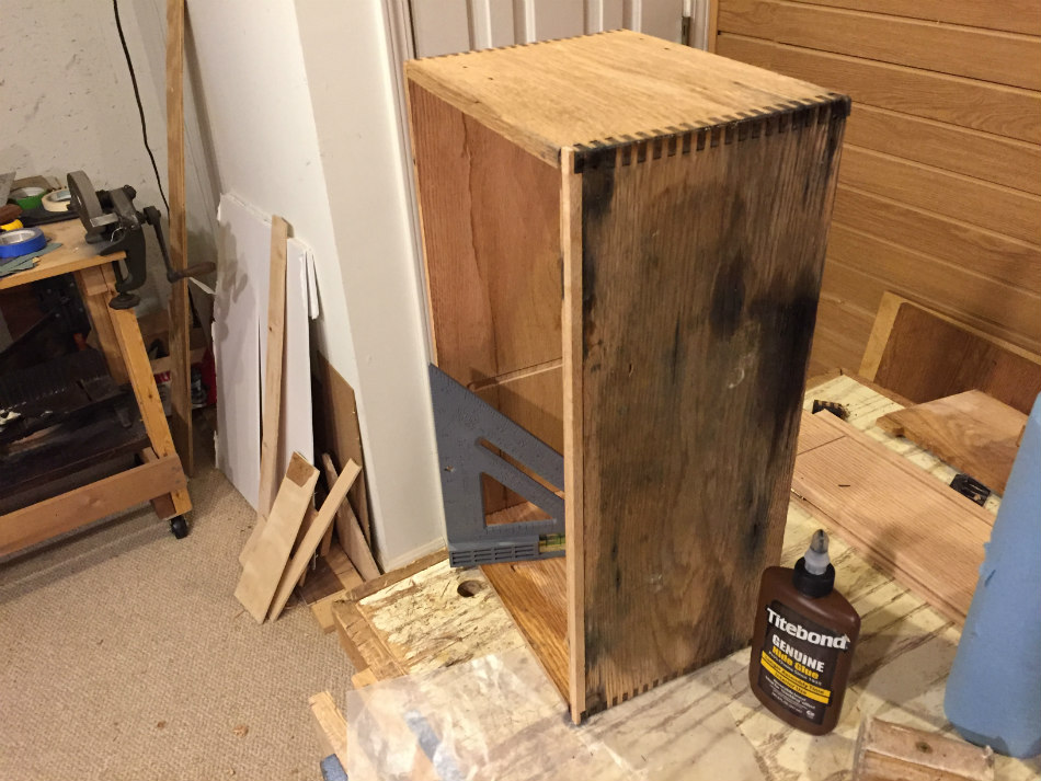

Now the repair spot is planed down and selective gluing has started. A lot of the left side of the carcass is now glued, but the right side is loose-fit until I establish and install pivoting hardware on the new front-panel:

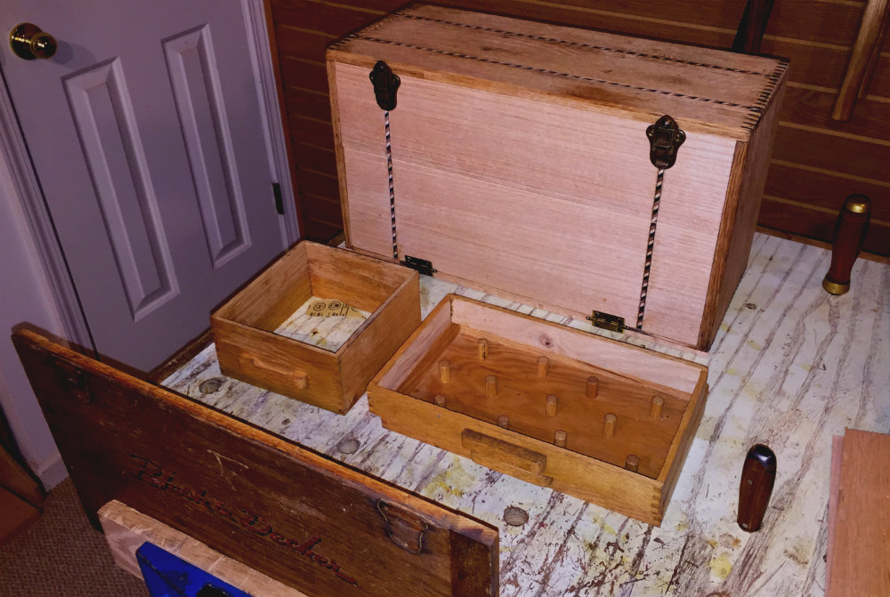

Oh heck, I had to take a break from what was already a slow project. Plus, I'd bought a couple more carcasses "on the cheap" during these many months. I had to move all this stuff aside just so I can think straight again.... The Gerstner needs finishing, and there are 2 cute little Union chests in line behind it!

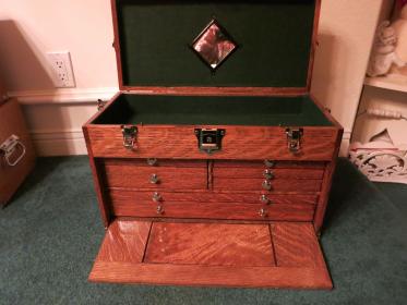

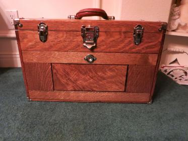

A little closure on the latest chest: I got so busy and behind, that I decided to sell it off. The new owner took the "mended bones" I provided, and finished the job details. He was tickled with the custom front panel (which was my main project satisfaction anyway!):

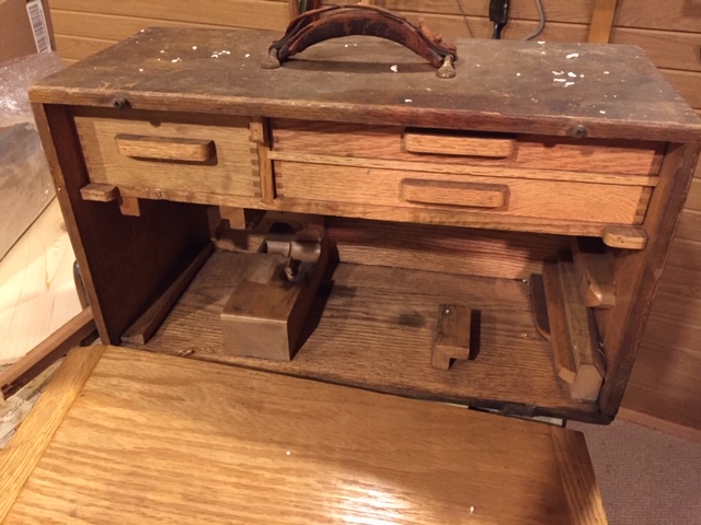

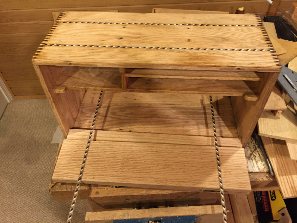

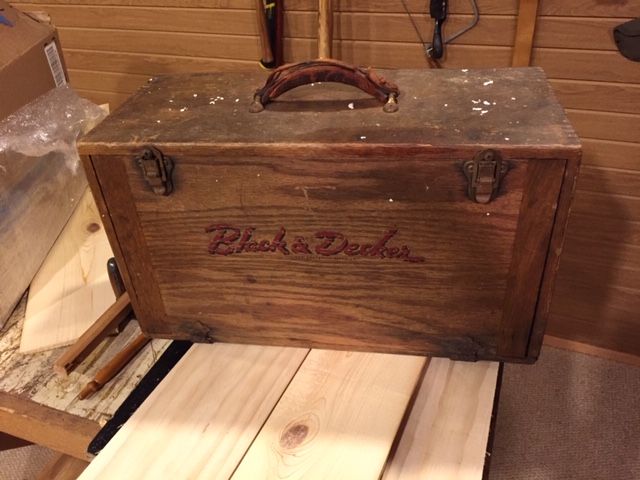

I got away from these Chests 3-4 years ago since I was getting overwhelmed. But lately I scooped up an oddball small Black and Decker chest for a circa 1942 valve-grinding tool (missing in action....).
I am altering the thing, having some fun. It's a bit less complicated and fussy than a true Gerstner ...
Strengthened Lower Lip.jpg (163.6 KiB) Viewed 15312 times
Fold_down Front Scheme.jpg (170.75 KiB) Viewed 15312 times
Hinged Panel Installed.jpg (164.76 KiB) Viewed 15312 times
happy woodworking,
Chris

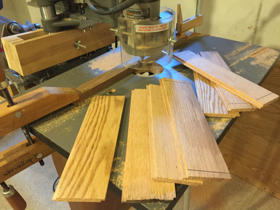

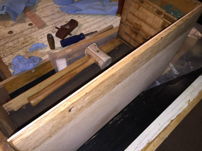

I went to the trusty Overarm Pin Router, which has been my main rabbeting method for 10 years....
OPR rabbets.jpg (133.88 KiB) Viewed 15213 times

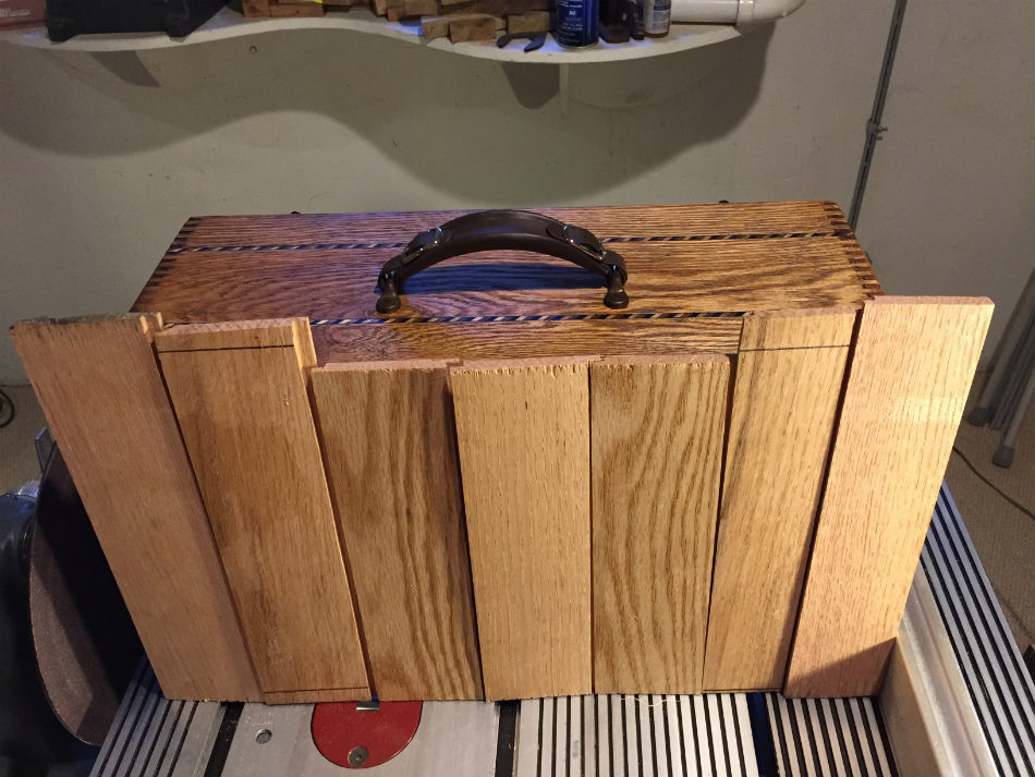

Now I have enough parts to make a ship-lapped new back assembly:
Parts for Shiplapped Back.jpg (137.31 KiB) Viewed 15213 times

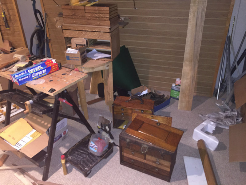

Here I'm in the middle of another distraction on a saw-handle Frankenstein project. But the chest-in-progress makes a nice backdrop:
Merging Apple Totes.jpg (170.5 KiB) Viewed 15213 times
More later!
Chris
