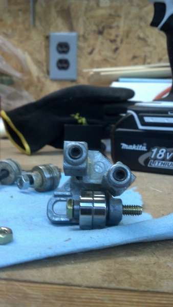

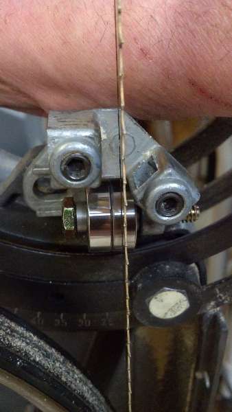

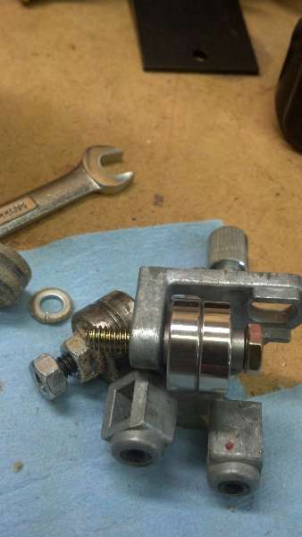

I started my bearing upgrade last night after having obtained the parts per your drawings from McMaster Carr. The Guide bearings installed and aligned perfectly. When I installed the lower bearings with the listed shims etc the center of the bearings is about 3/16" to the left of the blade. This is with the bracket moved as far to the right as possible. I am thinking I can remove the last shim (.0625") and see if that will work. Do you have any suggestions? This is a 2004 model bandsaw. Photos attached.
[ATTACH]19887[/ATTACH]
[ATTACH]19888[/ATTACH]
[ATTACH]19889[/ATTACH]
Thanks
Jack

claimdude
Posts: 460
Joined: Fri Dec 29, 2006 11:47 pm
Post by claimdude »
Does anyone have any suggestions?
Thanks
Jack

claimdude wrote:LDH,
Thanks
Jack
Jack,
Having installed my modification on several SS Bandsaws I have found that some of the lower guide brackets #5025809 have to be finessed with a bit of grinding. I use a small die grinder or a dremel tool. With a bit of patience you will find the 608 bearings will work well. I have the Carter bearing system on my Delta and as I recall they use a 608 also.
Larry

ldh wrote:Jack,
Larry
Idh,
How do I get the bearings moved to the right that much? I can leave off the .0625 shim in your drawings and get me part of the way there. Are you saying I should grind the right tab (on the inside next to the bearings) that the bearing bolt screws into so the tab is thinner allowing the bearing assembly to move further right?
Thanks again for your help.
Pennview,
Yes, I have the 608-2RS bearings 8mm shaft, 22mm diameter and 7mm width
Dusty,
Your bearings according to McMaster are the same diameter and width as mine but the ID that goes over the shaft is 7mm (small than mine but the brass bushing I used makes up the difference.
Thanks again guys!
Jack

claimdude wrote:Idh,
Thanks again guys!
Jack
Jack,
You will need the .0625 shim for clearance and you may still find that you have to remove a bit of metal to allow the bearing to move freely. Make sure you have removed the upper blade guides and have the auto-trak assembly installed and a bit of tension on the blade. Raise the height lock handle to the high position then to the low position and note where the blade is in relation to the lower bearings. If you see a change from high to low you will need to adjust the upper guide. If the blade position in relation to the bearings does not change you will need to further elongate the adjustment holes in the lower bracket. As I said earlier it takes a bit of finesse to get it all working together, but you will be pleased with the results.
