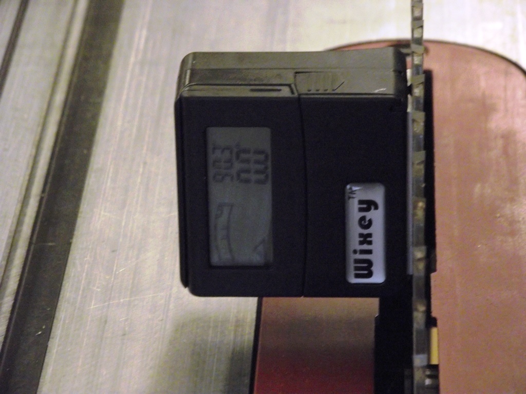

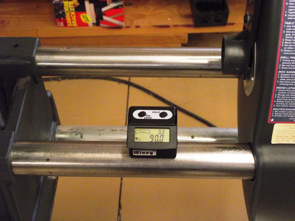

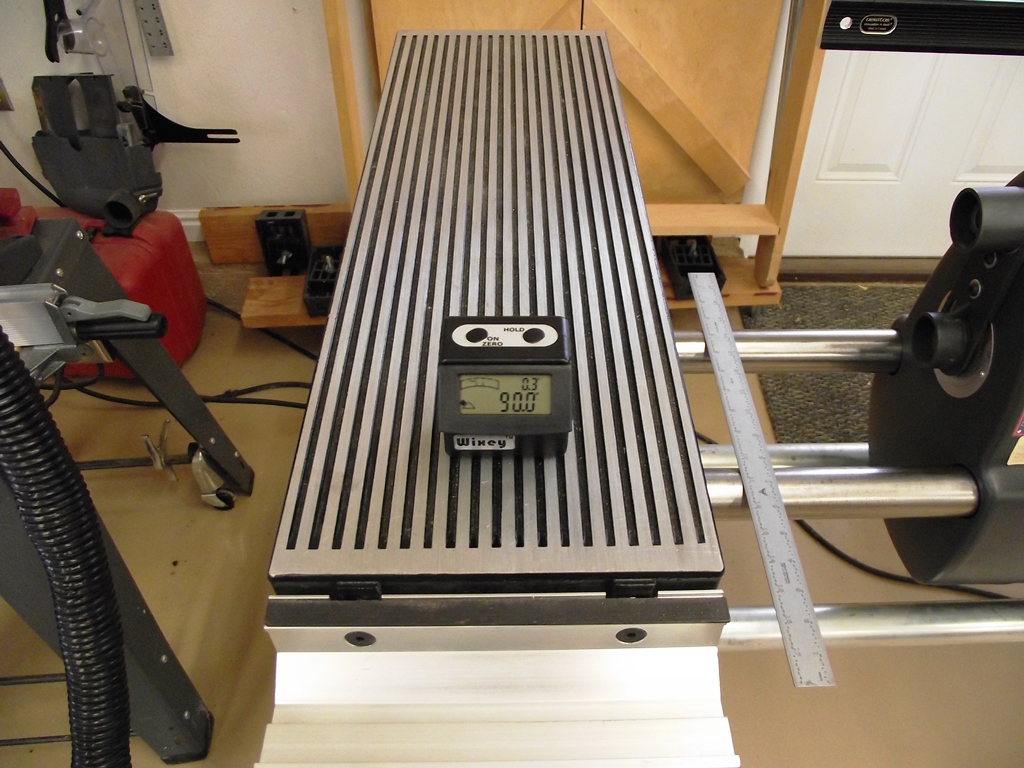

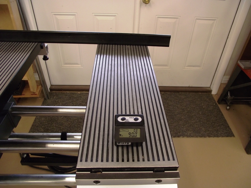

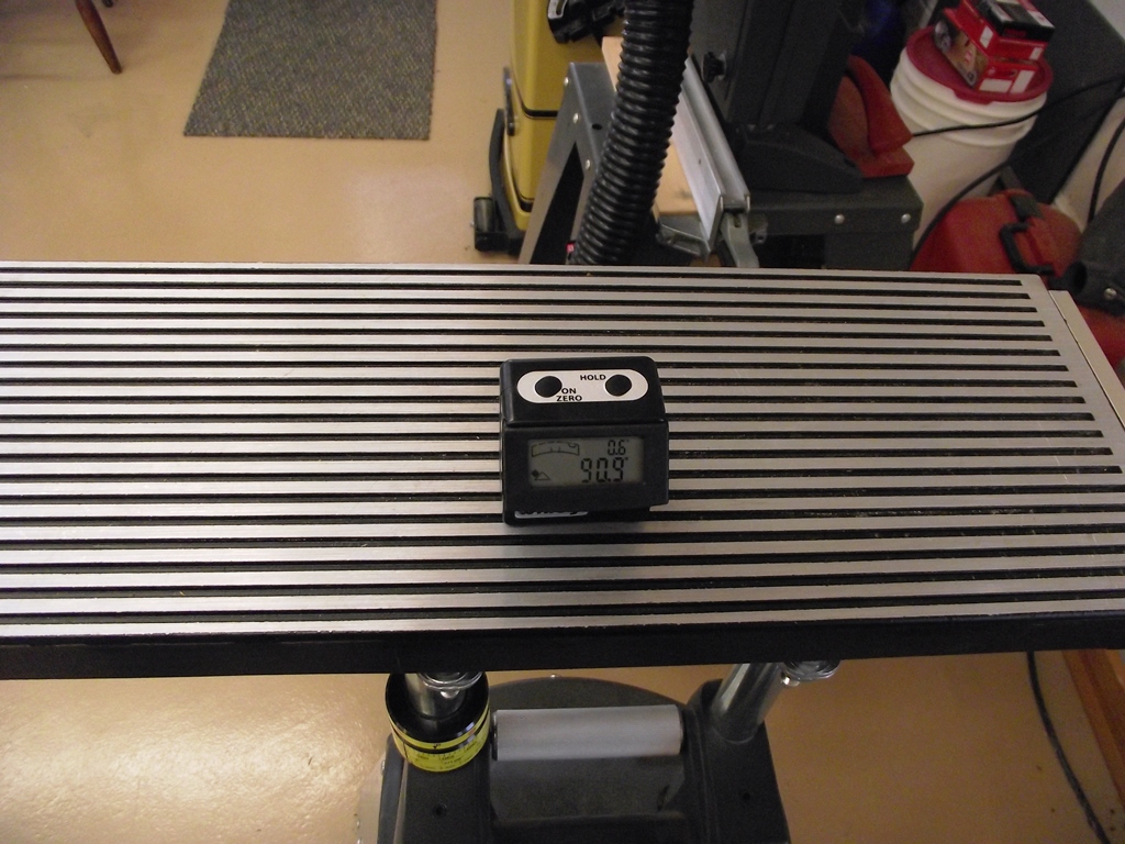

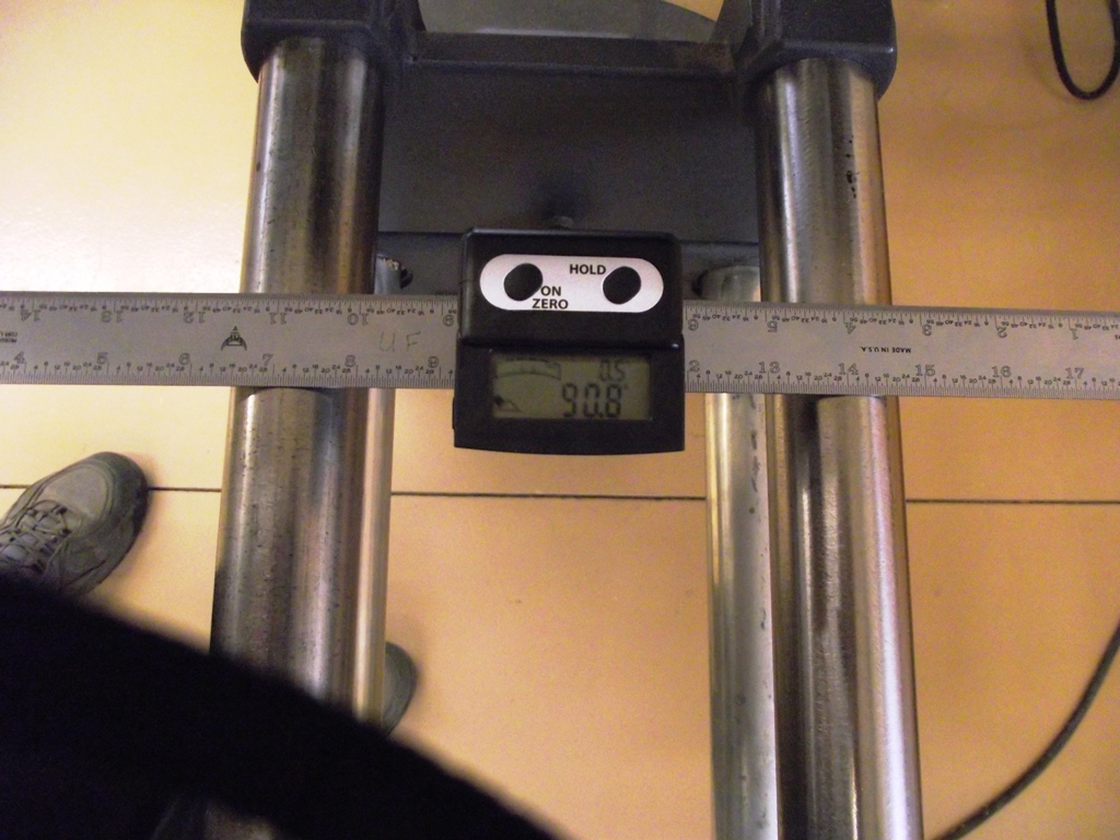

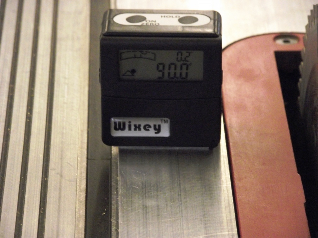

First, the spirit level is NOT zeroed when you zero the gauge. The spirit level is factory calibrated and does not change. So the spirit level is actually showing that the floor is not level. The floor in fact slopes slightly to the left. That is what the gauge on both end tables show along with a conventional 4' level on the floor. I am at a complete loss as to why the gauge on the main table is opposite.

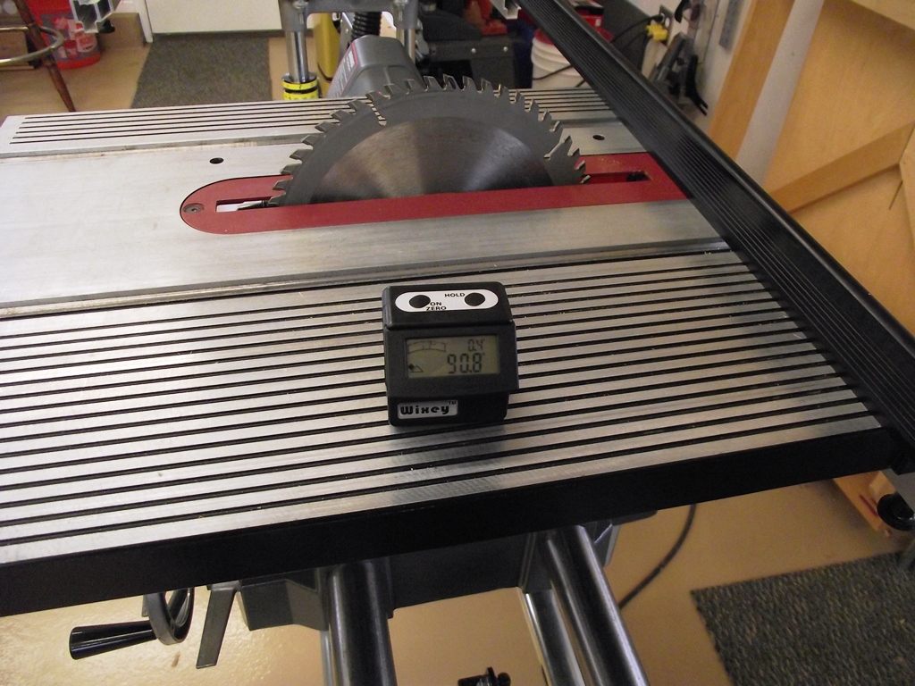

The gauge was zeroed to the blade since it is a fixed surface. Then all the other measurements were taken. So that shows that the blade is 90 degrees to all of the tables and the way tubes. Also the extension table measurements were taken after I used a straight edge to align them left to right and front and rear to the main table.
Yes, they are all the same front to rear except the left extension table. It is within the accuracy of the gauge. I used the way tubes for the reference surface and for some reason did not zero the gauge. I don't have a picture of the right hand extension table but it did read 90.8.
- DSCF1655.JPG (325.31 KiB) Viewed 1153 times
- DSCF1656.JPG (441.8 KiB) Viewed 1153 times
- DSCF1658.JPG (414.8 KiB) Viewed 1153 times
Dusty asked in a previous post "I see that the tables are all level but are they coplanar?"
They are not level. The spirit level shows that. However they are all at the same relative angle to each other both left to right and front to back and they are all at the same height. Does that not make them coplanar? If not, then I guess I don't understand the definition of coplanar.
How does the blade appear to be 'dead level' with the way tubes? The gauge on the blade reads 00 and the gauge on the way tubes reads 90.
