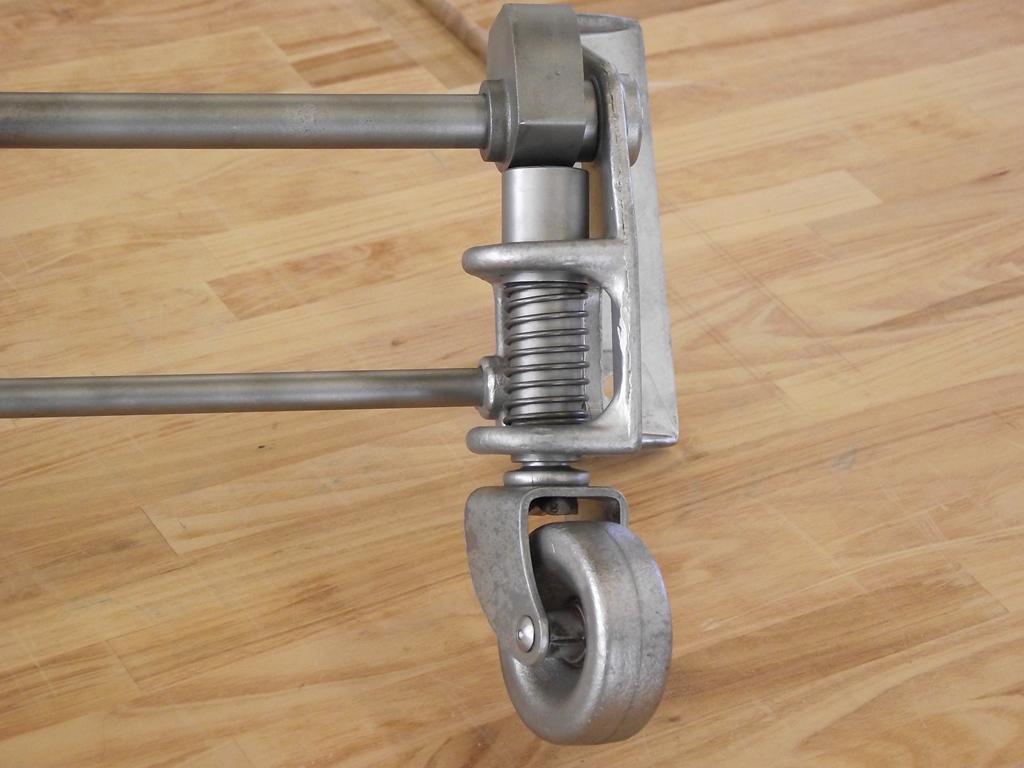

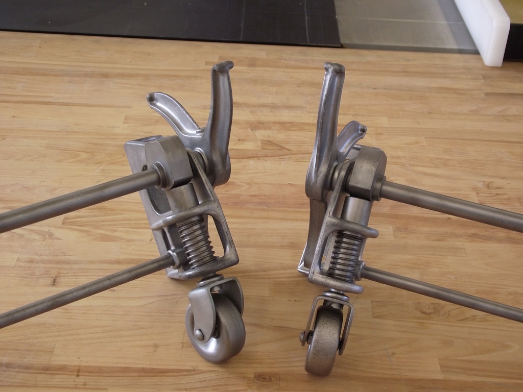

The picture is a set of 60+ year old 10ER castors that have just about the same extension as the 6 sets of my MK V castors. None of them are deformed and only 2 of my MK V sets were bought new by me. The other 4 sets came from eBay with an unknown history.

John, it is the position of the caster/piston when bearing a load that counts. I am not sure your pix were in that condition.
Oh I completely agree that without 'top swivel bearings', bearing on the caster frame/(whatever that step is) is undesirable. What I consider undesirable with the Mark 5/V casters is the size of the gap.

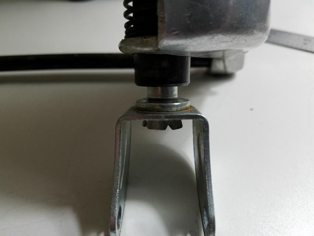

Please, when you do this photo op include a Shopsmith Caster Assembly other than the one shown previously.
The gap on mine is 3/16".
