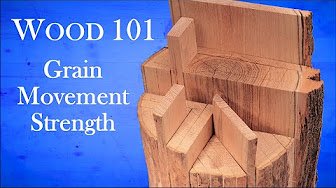

The Way Wood Works -- What Every Woodworker Needs to Know About Wood.
Post by Chad »
Nick Engler's Workshop Companion
Watch it here: https://youtu.be/oZkYLVrTYe4
If you are a novice woodworker, this is stuff you absolutely need to know before you cut another board. If you’re a master craftsman, you know it well enough to understand that a quick review never hurts. And if you’re somewhere in between, this may fill in some important gaps. What I present here is the very foundation of wood technology; the way wood works as a construction material and the basic concepts you must keep in mind to get it to work for you.
Novice or master, please understand that these are the just the basics. Wood is an incredibly complex material, more than I could explain in a zillion videos. Additionally, there are hundreds of wood species each with different botanical, physical, and mechanical properties. If you would like to explore wood’s characteristics in depth, or just look up the properties of a single species, there is an amazing book that you should have. “The Wood Handbook: Wood as an Engineering Material” is published by the United States Forest Products Laboratory as a FREE service for those of us who rely upon wood and wood products for our livelihood and well-being. You can download a PDF copy free from our store at https://workshopcompanion.selz.com/it...

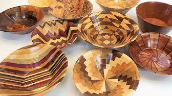

Bowls From Boards -- Simple technique, spectacular turnings
Post by Chad »
Watch it here: https://youtu.be/KSuRwdlMagk
A simple technique opens up a world of possibilities for creating figured and patterned bowls. Nick demonstrates a simple jig that slices a board into rings, then glues those rings together to make turning stock for a bowl. This not only saves time and wood, it allows you to create remarkable, eye-catching lathe turnings from scraps.

Bowls From Boards - A Quick Look
Post by Chad »
Watch it here: https://youtu.be/IYWQLAQQq34
A brief, wordless woodworking adventure in which author/craftsman Nick Engler takes a few scrap boards and turns them into stunning bowls. If you like what you see -- and would like to try it yourself -- watch our expanded how-to video in which Nick carefully explains this process step by step: https://www.youtube.com/watch?v=KSuRw... .

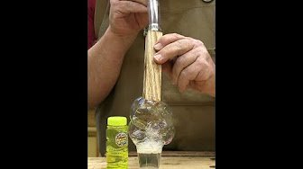

Red Oak Sucks (and Blows)!
Post by Chad »
Watch it here: https://youtu.be/QGaQsrNuZYk
Open-grain hardwoods have pores -- tiny tunnels and channels that distribute nutrients to the living wood through capillary action. And nowhere are these pores so open than in red oak. Did you know that you can actually suck up liquids through the pores in a 6" (15 cm) long piece of red oak? Or blow bubbles through it? Author/craftsman Nick Engler has some fun with this amazing and little-known property of oak wood.

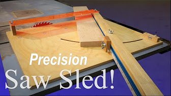

Precision Saw Sled
Post by Chad »
Watch it here: https://youtu.be/ThHQFVD00w4
A saw sled carries your work past the table saw blade, boosting accuracy by eliminating the friction that plagues an ordinary miter gauge. Nick shows how to get even more precision; how you can easily adjust a cut to with a few thousands of an inch or hundredths of a millimeter. And in addition to being more accurate, sleds are also more versatile. Nick discusses the types of sleds you might build and shows the features you might pack into it -- fixed and adjustable fences, stops, guards, auxiliary surfaces, even a convenient storage cart.
Detailed plans for the saw sleds and features that Nick shows, including measurement in both inches and millimeters, are available at https://workshopcompanion.selz.com/it... .

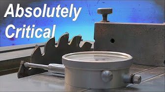

Crucial Table Saw Alignments and Adjustments
Post by Chad »
Watch it here: https://youtu.be/vtMoiXS2hWA
For a table saw to make precise cuts, it must be precisely aligned and adjusted. The core reference for this critical calibration is the axis of rotation, an imaginary line around which the saw blade spins. Nick shows how to define this axis, and then uses it to align and adjust the saw table, fence, miter gauge, and other important parts of the saw.

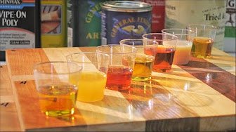

Finding the Perfect Finish for You
Post by Chad »
Watch it here: https://youtu.be/0z_xHK4-3cI
Experienced craftsmen and women all have a "go-to" finish -- a versatile wood finish that takes minimal time and effort to apply. They use this for most projects, simplifying their finishing needs. These needs vary, so Nick shows how to find your personal go-to finish from the hundreds of choices that are available to you. He starts with some basic "coating chemistry" to reduce confusion and help you make an informed choice. Then he walks you though a simple experiment designed to compare the characteristics of popular commercial finishes.
