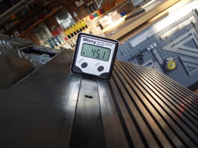

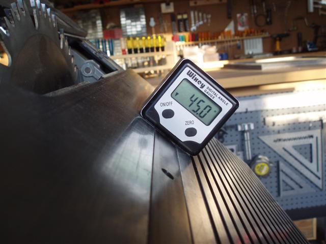

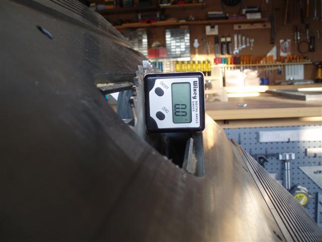

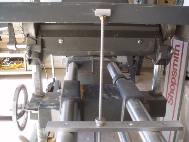

That piece of wood across the way tubes is a 2nd generation of the aluminum bar pictured in the first attachment. I use it for one of two purposes.
Most frequent purpose: It helps to stabilize the main table when the extension table is not part of the Mark V setup. It compensates for the fact that the table tilt lock is not absolute. This is especially true if there is any weight on the table like when a floating table is attached to the right side.
Secondary purpose: It acts as a base for the table tilt micro adjust.
[ATTACH]12944[/ATTACH]
The adjuster in the 1st generation version. The wood in the question replaces the aluminum bar in the photo.
[ATTACH]12946[/ATTACH]
Reference to the blade

Close enough but
[ATTACH]12948[/ATTACH]
Right on.
