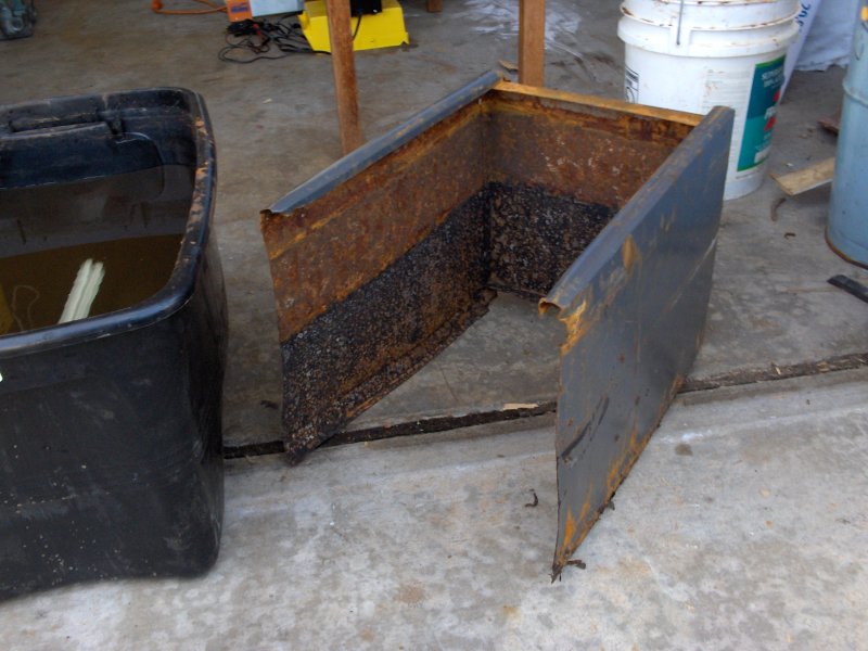

Good choice of anode material. It will last you a long time. More surface area would be better since it doesn't gunk up as fast but as long as you scrape it down with a putty knife when it starts to build up to much, it will work fine.dusty wrote:Anodes? I have only one unless to which you refer is the rusty item. Right now the positive lead is connected to a piece of flat iron that is about 5"x7".
The other lead is connected via the ammeter to the item being treated (the rusted ammunition box lid).
I mixed the WRONG SODA on a ratio of 1 tablespoon per gallon of water. The container would hold 58 quarts (14.5 gal) of water. I used 1 cup of WRONG SODA . A bit strong since the container is not full to the brim but close.
The amperage does tend to go down with time but I am not certain why. I have concluded that it is not a direct indicator of progress.
CAUTION: Don't stick your finger in the bubbles. They have something to do with the current. Really dumb, especially for someone who has worked on hot circuits for most of his life.
Here's my anode of choice...sheet metal. I liked this setup since for the surrounds the workpiece. There is another piece not shown that I put on the open side and connect it to the main section with a copper wire and a nut / bolt.
[ATTACH]8673[/ATTACH]
Being so thin, it only lasts for about five 24 hr. uses before lots of small through holes start to appear but I have a supply of scrap metal so I just build up a new one. I keep an eye out on craigslist for free metal desks, file cabinets etc. when my supply gets low.
