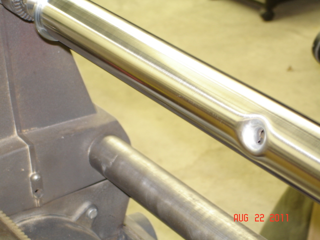

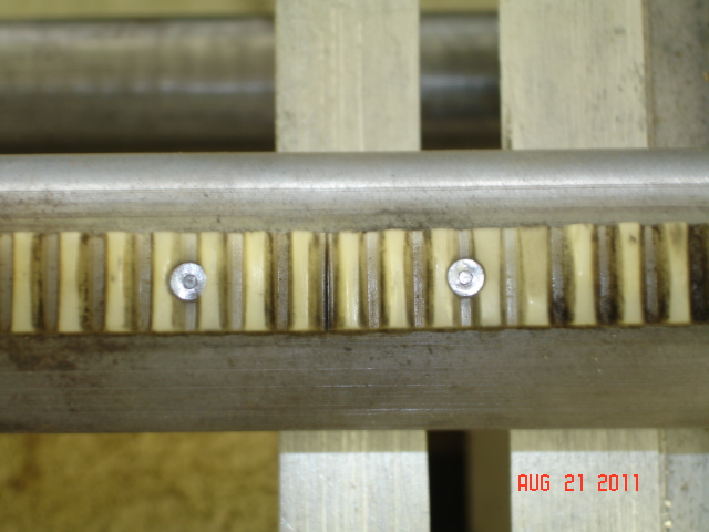

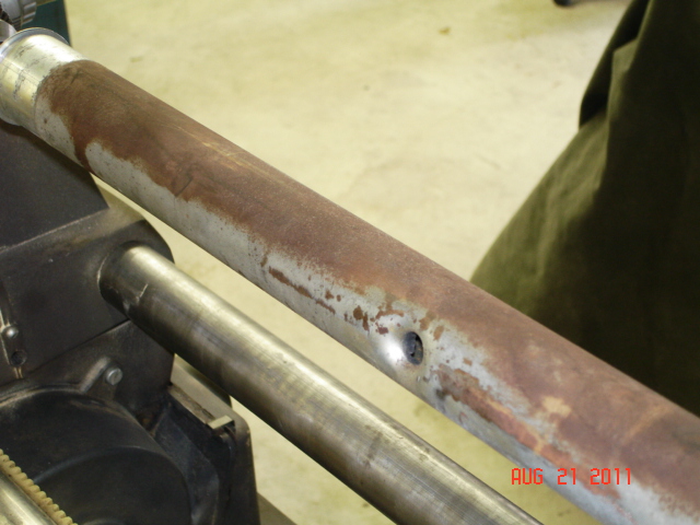

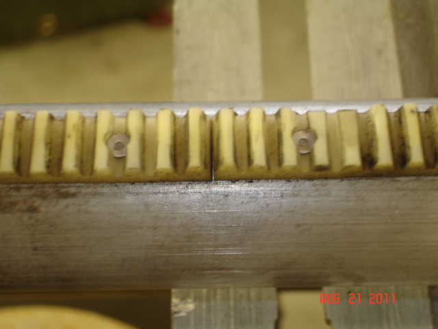

iaokie
Posts: 59
Joined: Sat Jul 02, 2011 1:05 pm
Location: Oklahoma
Track Help
Post by iaokie »
[ATTACH]14066[/ATTACH]Help ! What is this :eek:
Didn't know the track was riveted on the tube
I'm thinking i'll have to drill these out
Guess I will tap the waytube and screw the track back on ?
Any ideas[ATTACH]14064[/ATTACH]

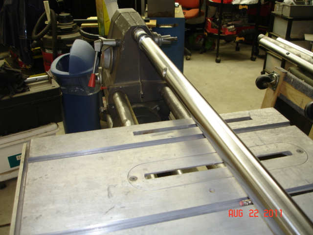

billmayo
Posts: 2342
Location: Plant City, FL
Post by billmayo »
iaokie wrote:I think I like your setup better
It seems safer also
Were you able to easily find various sized wheels with the same diameter hole
1 tube down 3 to go
Time for JPW :D [ATTACH]14056[/ATTACH]
[ATTACH]14057[/ATTACH]
[ATTACH]14058[/ATTACH]
Really a nice polishing job. I remove the various size wheels/casters from cheap Harbor Freight casters. I used long bolts, washers and nuts to position the wheels. I drilled 1 1/2" slots aligned with the tail stock hole center at 120 deg. and 240 deg. I find many tubes are bent and causes vibrations beyond the casters to where it is not safe to continue. Of course I accept Shopsmith in any condition for many years and had a little straighten the bent tubes. With several hundred tabe available, I can pick the one to change, I use the 10ER tubes on my shopsmith as they appear to be made from better marerial
iaokie
Posts: 59
Location: Oklahoma
Post by iaokie »
Thanks for the info Bill
I noticed last night about half way through the bench tube polishing
my cheapy casters have already worn considerably
Have to find some with bearings inside or
maybe a set of wheels like they have on the inline skates
may work also:confused:

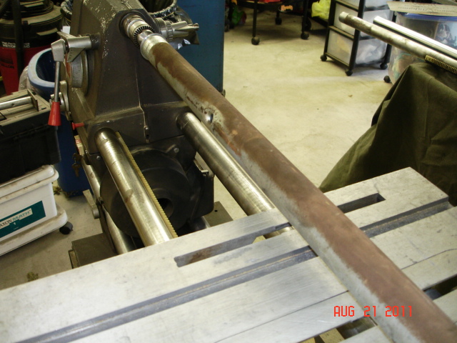

iaokie
Posts: 59
Location: Oklahoma
Polishing contined
Post by iaokie »
[ATTACH]14079[/ATTACH]
[ATTACH]14080[/ATTACH]
[ATTACH]14081[/ATTACH]
[ATTACH]14082[/ATTACH]3 Tubes finished :D
Waytube with track remaining
Now I just have to figure out how to
remove the track without breaking it
