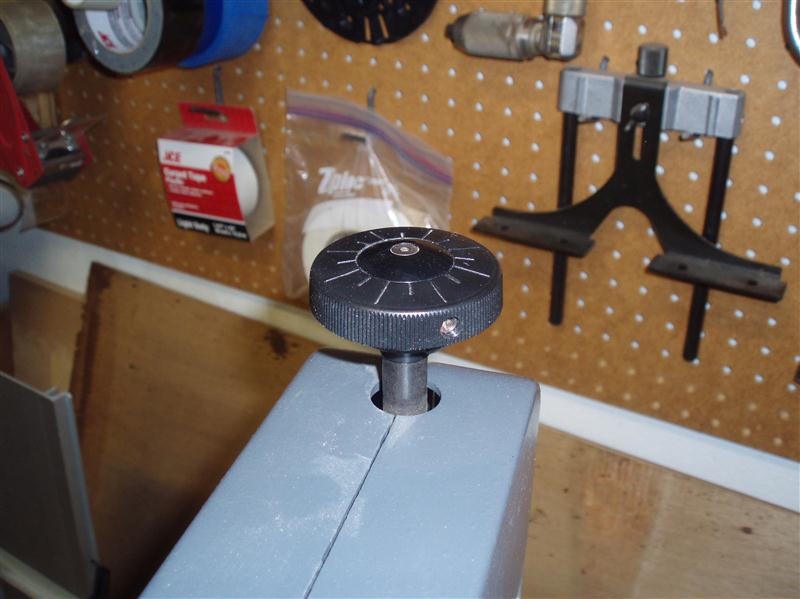

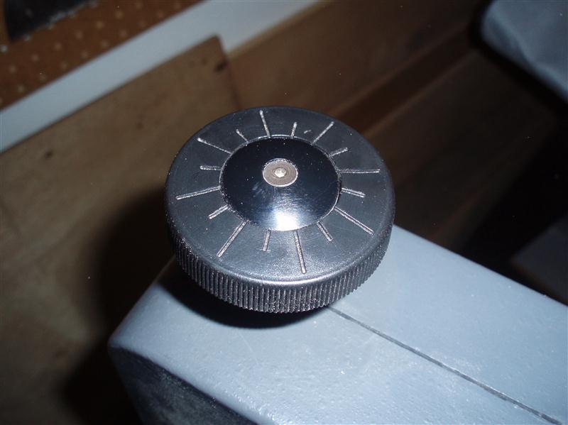

JPGs picture is what my knob looks like. Mine rotates and increases tension, but doesn't make any clicking sounds.

I hope these will help.
[ATTACH]19409[/ATTACH]
[ATTACH]19410[/ATTACH]
I have not taken the knob off. I removed the two set screws in an attempt but the knob was quite secure. I then examined the exploded parts list and see that there is a spring and ball bearing shown. I detected neither one when I had the side set screw out. Mine does not click but then it would not if the ball bearing and spring are now missing:(.

Have we confirmed if the click is with each line on the knob or each large line? That would be 16 or 8 clicks per rotation. Of course the instruction in PTWWFE are start counting when the knob starts to tighten and the clicks become quieter.
Looks like the number of clicks to count are from 5 to 25.
letterk wrote:Have we confirmed if the click is with each line on the knob or each large line? That would be 16 or 8 clicks per rotation. Of course the instruction in PTWWFE are start counting when the knob starts to tighten and the clicks become quieter.
1 line/click. 16 clicks/rev.
The ball bearing detents into the flutes on the side of the top knob. There are 16 flutes.
