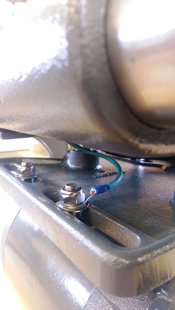

Re: Restoring 10ER S/N 83974
I would ground the motor directly.
Now if you are concerned about the switch being mounted to another part, add a jumper from the motor grounding terminal to the casting 'somewhere'. If you can find them, a 15/32" ring terminal on the switch. If not, make one!
Generally an external tooth star washer should be between the grounding terminal and the surface being grounded.
I would recommend in line connectors for the switch leads(so the motor can be removed without pulling the switch). That grounding wire would still need to be removed at the motor.

Posts: 6585
JPG wrote:I would ground the motor directly.
Those are exactly all the things I was thinking about. I was thinking a 1/2" (15/32) ring terminal under the switch. Then I need to clean some paint off of the motor mount and the cast iron motor bracket to get a good ground to the motor frame.

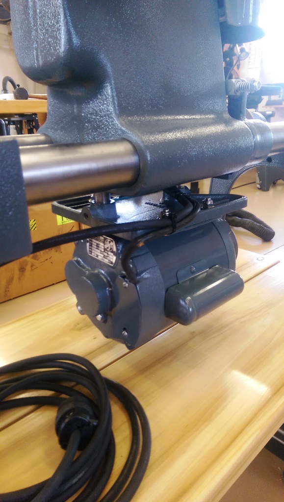

Posts: 6585
Today I got the motor wired. I ended up attaching the ground wire to one of the motor mount bolts. I removed the paint under the washers on the cast iron motor bracket and the mounting flange on the motor. I verified a good ground from the head stock to the motor frame with an Ohm meter.
I don't have speed changer belts yet so I put a single belt on to test. It purrs like a kitten. :D Speed changer belts are on order from Skip.
