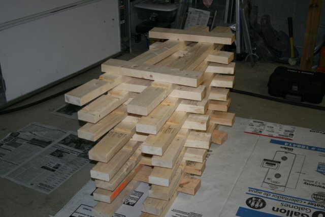

There are two shelving heights, 16" and 19" (need different clearances at the front and back of the garage doors). Here's the pile of lumber for the "shorty" shelves:

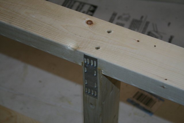

Once all the assembled were glued and screwed, I pulled the first one we assembled from the pile and hammered in two of the tie straps:
[ATTACH]1825[/ATTACH]
However, I really had to hammer those suckers in and it had only been about 30 minutes since the joint started to set. I decided it was better to let the frames cure completely overnight and hammer the straps on tomorrow, rather than hammering across the joint while it was trying to set.

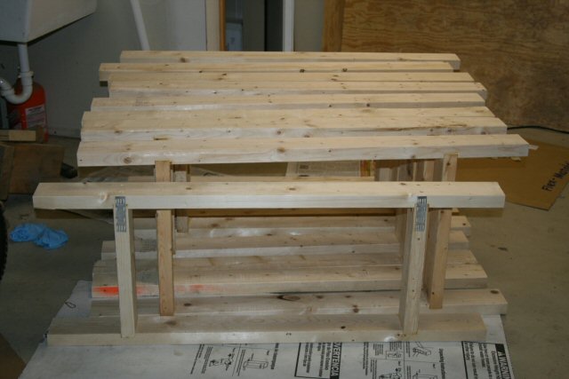

Here's the pile of taller frames, with a shorty frame in the front:
[ATTACH]1826[/ATTACH]
The two frames are 28.25" apart, hung from the ceiling with three lag bolts each. The slats, which were cut to just under 32" allowing exactly three slats per 8' board, then span the two lower supports.

Cris; Properly glued, you will not have lost any strength as a direct result of the deep dados. Just make sure that all three surfaces of the dado and the mating vertical member are well glued.
Remember, however, it doesn't have to be an engine block to be mighty heavy.
