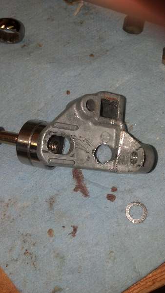

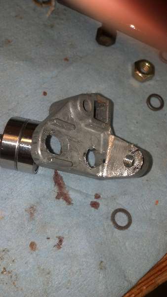

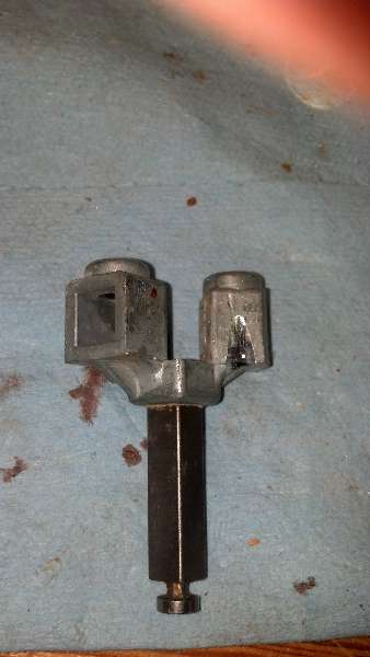

Did the mods to the upper and lower bearing mounts yesterday and got them installed and aligned. Turned on briefly yesterday evening and man is it much quieter!!! Still have to get the table re-installed and my new ceramic guides. I attached pictures to show the extent of the filing/grinding etc needed to make the bearings align with the blade.
[ATTACH]19930[/ATTACH]
[ATTACH]19931[/ATTACH]
[ATTACH]19932[/ATTACH]
Thanks again for your help!

ldh
Posts: 430
Joined: Sun Sep 10, 2006 6:09 pm
Location: Phoenix, AZ
Post by ldh »
Jack,
Looks like it is coming together for you. Does your Guide Column Bracket have the nylon bolt to adjust for side play? If it does not you will find that mod helpful.
Larry
