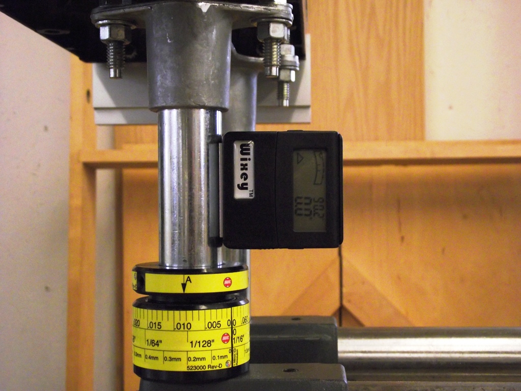

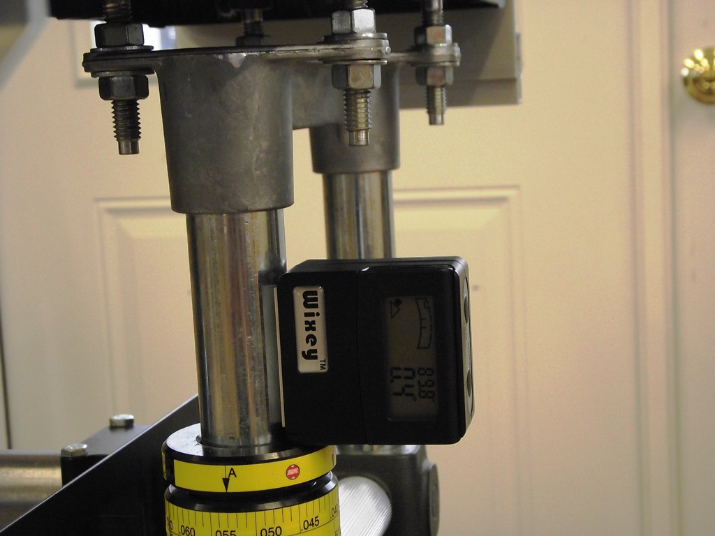

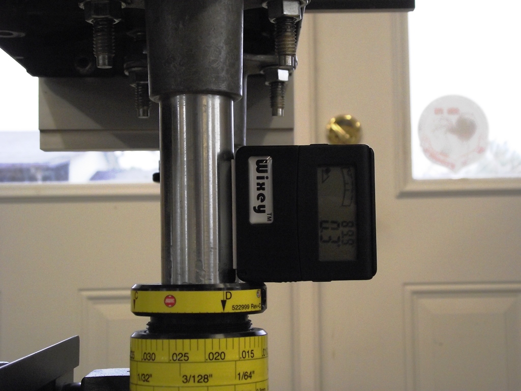

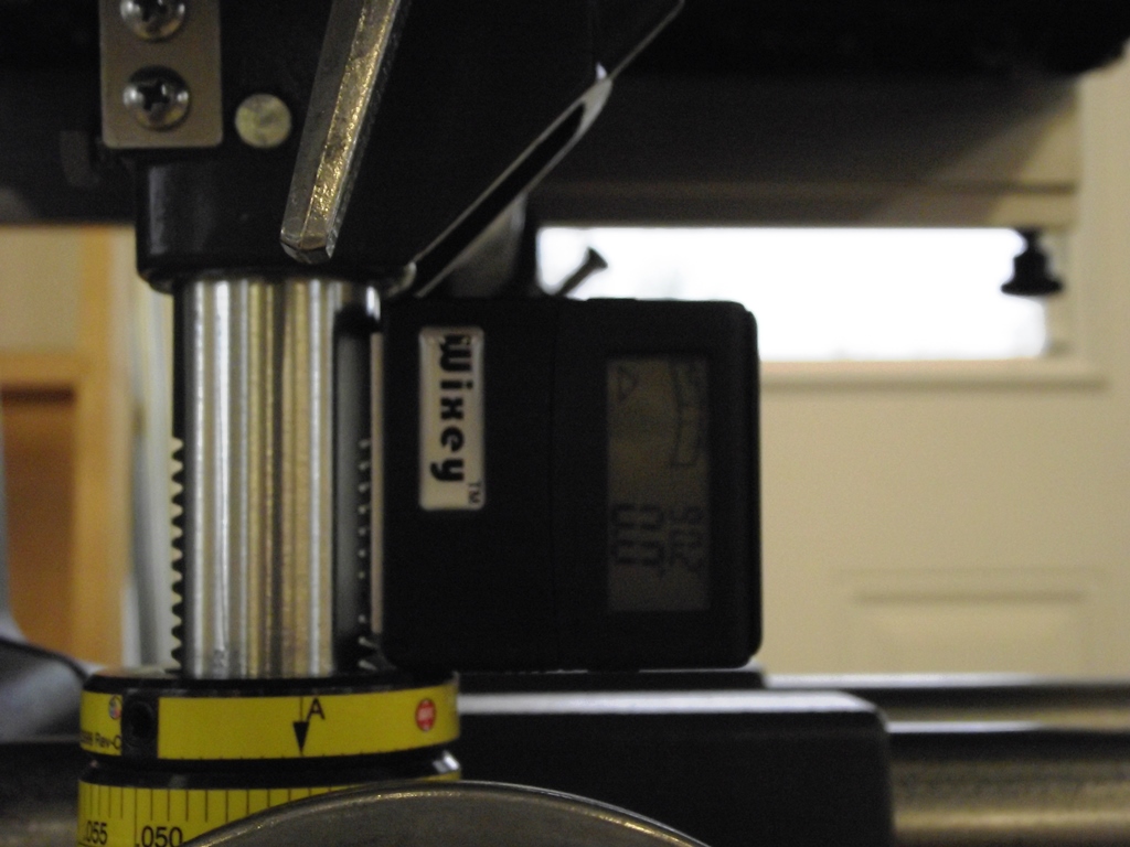

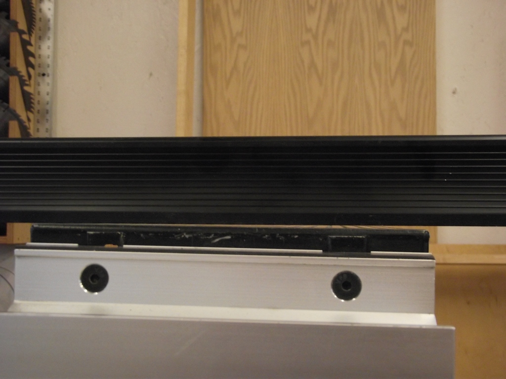

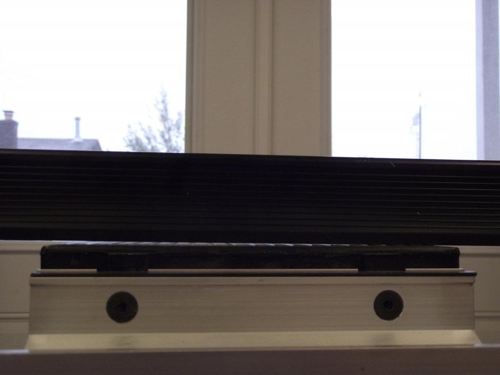

OK, now here is the rest of the story.
To answer your second question Dusty, they were aligned one on the right and one on the left. Remember, this a MK 7 which some have said eliminates the alignment issue since both ends are the same. That may be true if both ends actually are the same. Remember I have four main tables here. Three had the way tube and table support tube holes at 90 degrees and one did not.
Well, my right hand end casting appears not to be the same as the left one. After zeroing the gauge on the blade and checking the table tops and way tubes, I checked all three table support tubes. As you can see the left hand extension table tubes and the main table tubes are fine. However, the right hand extension table tubes are not 90 degrees to the way tubes. They are tilted slightly to the left.
As a result when you swap the tables end for end they no longer line up left to right. They are still fine front to back. They are both off very close to the same amount and in the right direction given the tilt of the right hand end casting holes. The straight edge placed at the back of the tables shows the same result.
Left table on right side.
Right table on left side.
I also measured the left hand table tube installed on the right end. It is off (within the tolerance of the gauge) the same as when the other table was installed on that end.
Edit: Correct picture now.
The results of the Wixey on the table top is consistent with the amount the right end casting is off. Both tables are off the same amount and in the proper direction.
So in my case with a bad end casting the tables are not interchangeable. Just because the castings are the "same" does not necessarily mean they are all machined perfectly. Of course my right hand one could be within the print tolerance but in my opinion if it is that is a very loose tolerance.

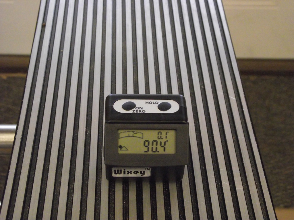

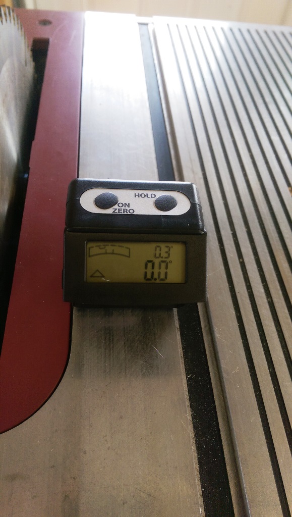

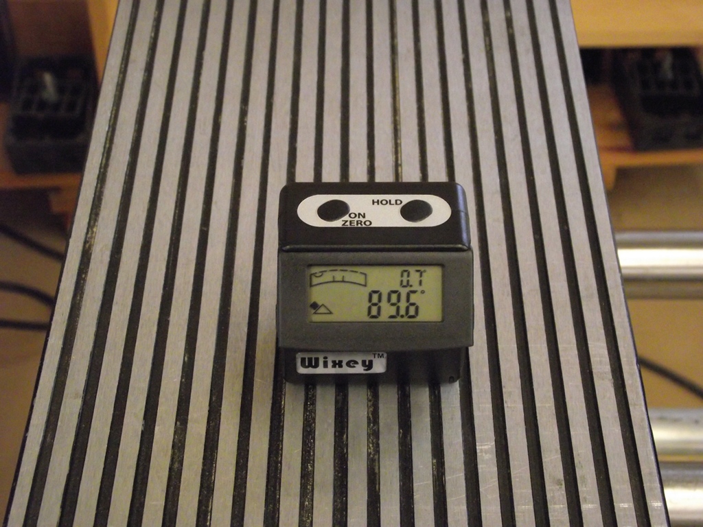

Look at the pictures in post #194313. That is the one that shows the anomaly on the main table.
The blade level shows 90.3 from vertical. Both end tables and the way tubes show 0.3. That is exactly as it should be and reflects the out of level floor. As you know the Wixey level function is a true digital level and does not get zeroed out when you zero the angle reading.
OK, I just went out and checked the main table again. It has not been moved since I did the other checks. It checked correct this time.
So chalk it up to an electromagnetic anomaly in the local area at the time of that measurement. ;) Don't laugh, Little Mountain is about 20 miles north west of me and the Air Force has a facility out there where they do Electromagnetic Pulse (EMP) research on nuclear hardened components. It is line of sight, I can see it standing in my back yard. :eek:
Seems one needs to be wery wery careful with the Wixey. :) At least as Dusty said if you don't get the expected results check further. That is not a direct quote but that is what he meant.

That HOLD button on top of the Wixey looks like it might be easy to press accidentally. Is there a HOLD-status indicator on the display?
Looking back at the "anamoly" photo, there's a little black square showing on the side of the triangle thingy. But it's not showing on your most recent (correct) photo. What does that mean?
Re: Truing, As Best You Can, Shopsmith Table Tops
Posted: Thu Sep 17, 2015 7:56 pm
by jsburger
BuckeyeDennis wrote:That HOLD button on top of the Wixey looks like it might be easy to press accidentally. Is there a HOLD-status indicator on the display?
I have never pressed the hold button that I know of. The buttons are actually far enough apart to not actually press them accidentaly. At least for me.
As far as the the black square (diamond) not showing, I don't know. Probably a software issue?? Some times it is there and sometimes not. It is obviously intended to indicate which way the tilt is.
There is a Hold status indicator.
