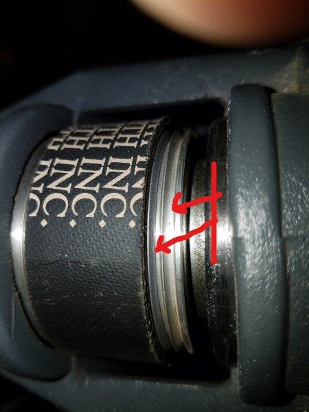

Next, we talked about alignment, balancing and tensioning of the belts. I asked about clarification of exactly what the straight edge across the motor pulley should line up with. To my great surprise, she said that is not necessary. She never uses that technique. Instead…
(Important I think to know that she does all her headstock work with the headstock off the way tubes, on a jig of some sort.) She said everything will align automatically when the belts are positioned properly. Looking at the pulleys, belts from the side, the top belt should be positioned on the top pulley so that two groves show on the right side of the top pulley. (Mine are.)
Top pulley and belt positioned with two grooves showing
The last V on the bottom part of the top belt should fit in the farthest right groove of the left pulley on the idler shaft. In other words, there should be no grooves showing. The bottom belt should cover all ridges on both the idler and motor pulleys. I took it that she lets gravity initially set the tension. (Remember she’s got this positioned horizontally and not in Drill Press configuration.)
