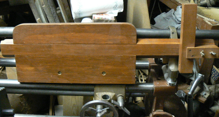

YEP! . . . . . Unless . . You want to make one of these first:D
[ATTACH]7682[/ATTACH]
It fastens to the fence with the two lower bolts. For your 'application' it would need an extension to the 'push bar'
Go with Ed's saddle!

Now... How do you plan to make the second cut? You can clamp it to the jig and cut the first ½ way through but to turn it over and make the second cut you can't just clamp it because of the kerf you just removed. You can slip a thin piece in the kerf to support the pressure of the clamps and hold it like that but if you just clamp the cut piece to the jig with an open kerf as soon as the cut is complete you will have two loose pieces not being controlled. Or am I missing something special in the way it will be clamped?
