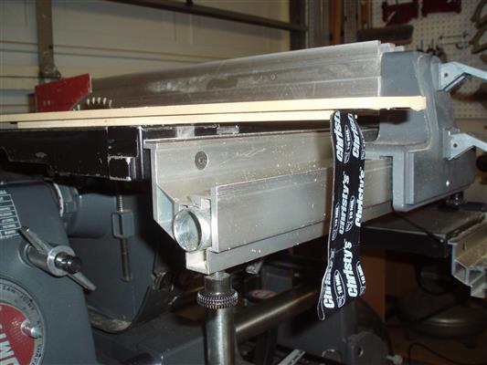

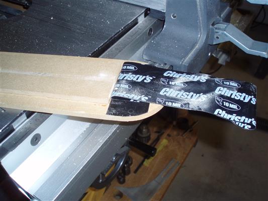

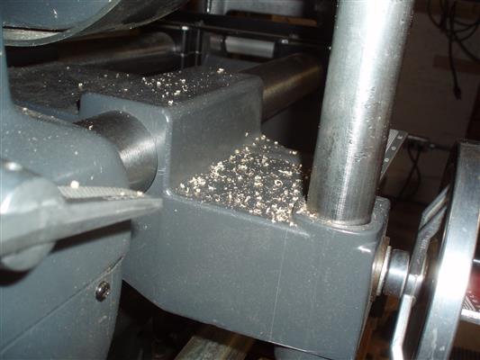

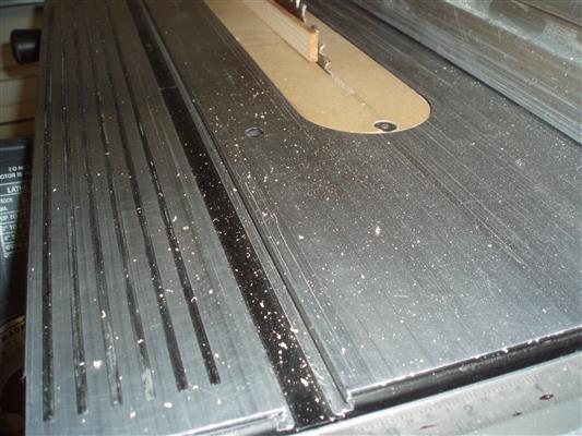

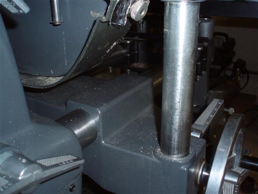

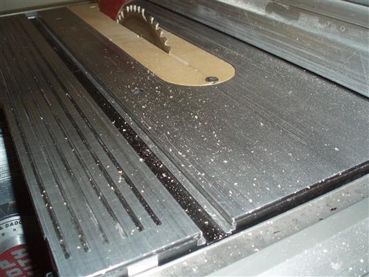

A couple before and after shots before full disclosure.
[ATTACH]23200[/ATTACH],[ATTACH]23201[/ATTACH]
[ATTACH]23202[/ATTACH],[ATTACH]23203[/ATTACH]
The last two shots show the results of a revised approach. Note that dust top side is still an issue.
The test was to rip small strips off the edge of a 14" piece of yellow pine to see how much dust escaped the DC3300.

The revised approach
employs an unmodified lower saw guard. The solution, instead, involves only a zero clearance insert and possibly a modified riving knife (yet to be validated).
[ATTACH]23207[/ATTACH], [ATTACH]23208[/ATTACH]
The deflector is attached to the under side of a ZCI and is reinforced with a piece of wire. With this installed, rather than the modified lower saw guard, the guard retains its' original adjustability.
