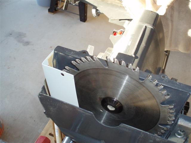

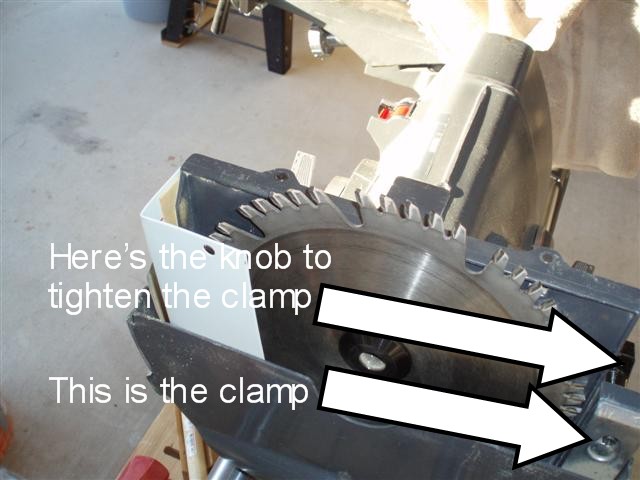

The riving knife is held by a clamp that is screwed tight by a knob on the lower saw guard.
I'm looking for a photo to show how it is mounted.
This is not a good look at the clamp that holds the riving knife but it is the best I have. It is shown in the lower right hand corner of the image. The know (black) just barely shows The clamp is closed and there is no riving knife.
[ATTACH]16646[/ATTACH]
- P7010025 (Small).JPG (43.11 KiB) Viewed 1184 times

Well, it is not designed to fit on the 500 model, but all those later, apparently because of the clamp on the back of the saw guard. So, if I can make one and clamp it to the table crossbar, then make it fit precisely behind the blade. The trick is to keep it just behind the blade even if I have to adjust the quill just a bit. May make a clamp that will adjust in my saw guard. Really like the idea, just need to adapt it to the older machines. Thanks for the help George and Dusty.
